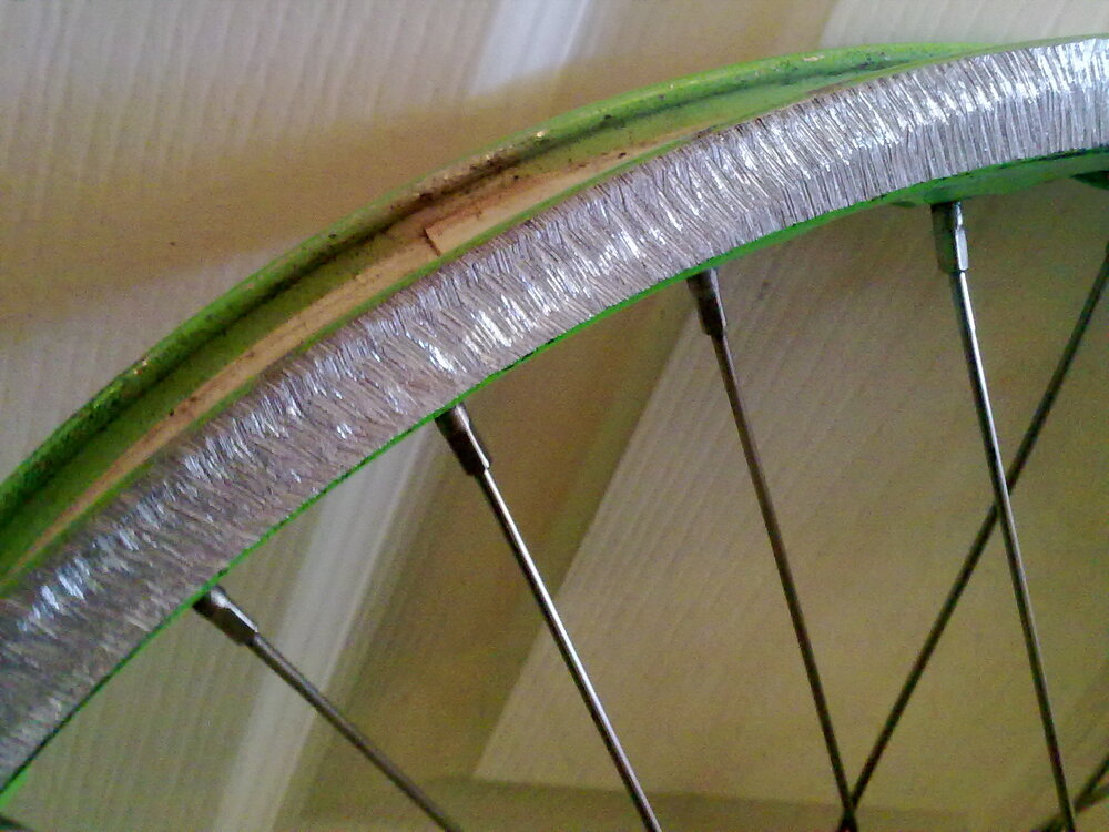

I had a fresh grind applied to my rear rim on saturday and was very pleased with how the brake was performing.
However,
I rode some natural last night and mud, water ect got into the grind.
Went in, cleaned the grind and the pads. Set it up again.
3 hours riding today and the brake is nothing short of rubbish.
No real bite, hold or noise, which is very off putting. Grind is still sharp and deep.
Setup is TrialTech sport 19"
TNN LGMs
V!Z clamps.
Medium, Deep grind.
Any ideas why the brake my be lacking in performance?

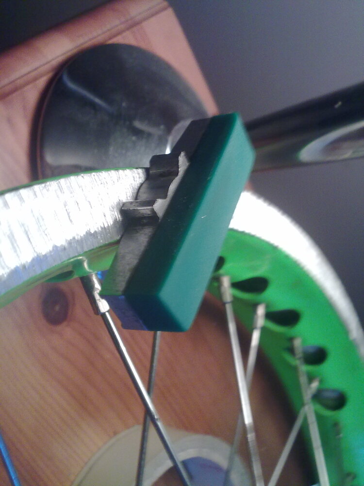

Clean pads. Still need to be sanded flat

Rim as is. Still sharp and deep

Brake cylinders didnt move. I took out the wheel, then the pads.
Gave the pads a quick sand to remove any surface grime,
and jet washed the grind to remove any dirt.
Grind is very clean, deep and sharp, pads are clean too.
When i put the wheel back in i made sure that the tyre didnt touch the pads (deflated obvs)
and set up my snail cams as they were before. (Ive drawn a little mare with a sharpee to make sure my wheel is always in the same place.
Inflated tyre.
Went out this morning and its shocking.
I checked my pads again and there just seems to be a silvery smudge on them all the time now, wheras before they were always green.
Never had this problem with any other rim than trialtech.
If your pads aren't put back in the exact same way you took them out, they'll be contacting at a different angle. Which can make both bite and hold feel pretty sloppy. Inspect the ads and make sure they are where they should be.
Definatley in the same way, as I didnt remove the slaves when I cleaned everything.
Pads came out, cleaned, and went back in.
Slaves are in exactly the same postion
You say you sanded the pads but adjusted nothing? Try the TPA?
Try cleaning the surface of the rim with thinner so that all the grease on the rim goes out then wait until it dries and sand the pads again just a little bit and check if it works I did this with mine and worked perfectly :D
Edited by Pepo09
right,
Went out tonight and thing have begun to improve.
Rode around draging the brake to get the pads worn in again, and the brake seems to be biting allot better :)
Hold is getting there too.
Im going to get a power sander on the pads tomorrow to ensure they are properly flat surfaced, as they look a little rounded.
Will see how things go :)
