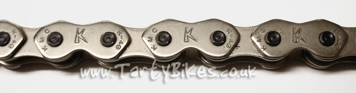

durrrrrrrrr f**king idiot i know this! but how the f**k do i know what one i got all the silly letters and numbers aint on the f**king chain
By looking at pictures. If it looks like this, it's a Kool.
If it doesn't, it's probably a Z610HX.
thanks for coments guys silly question but that kool chain pictured above is a slightly diff shape on top will it still go round a rear mech ok as im using one as derailer? sum chains are flat or diff shape on top side i presume for signle speed use only not sure if they will bend round the mech wheels other way? cheers
I've seen people use them upside down so it shouldn't really be a problem. The fact it's only really available in 1/8" width from most places now might be more of an issue though as you're going to have to space out your setup to get it to clear. A 3/32" chain would be a better bet.

lol true ive seen few bike pics where they got the chain on upside down lol. ive managed to trace down a kmc kool chain in 3/32" so will give it a go as had a few before with no worries, ordered a 610 too for when this one breaks in a week :giggle: , thanks for the info guys.
