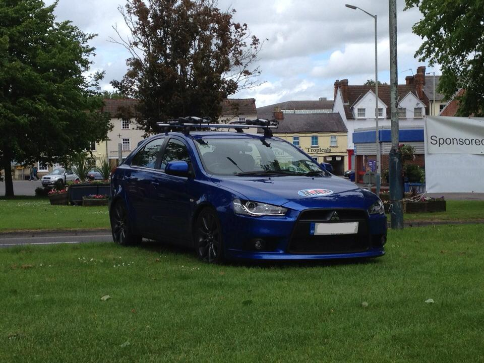

Here's my car, Mitsubishi Lancer running a VW 2.0 PD140 BWC engine and VW Garrett turbo. She's currently sitting at 181bhp / 313lbft
