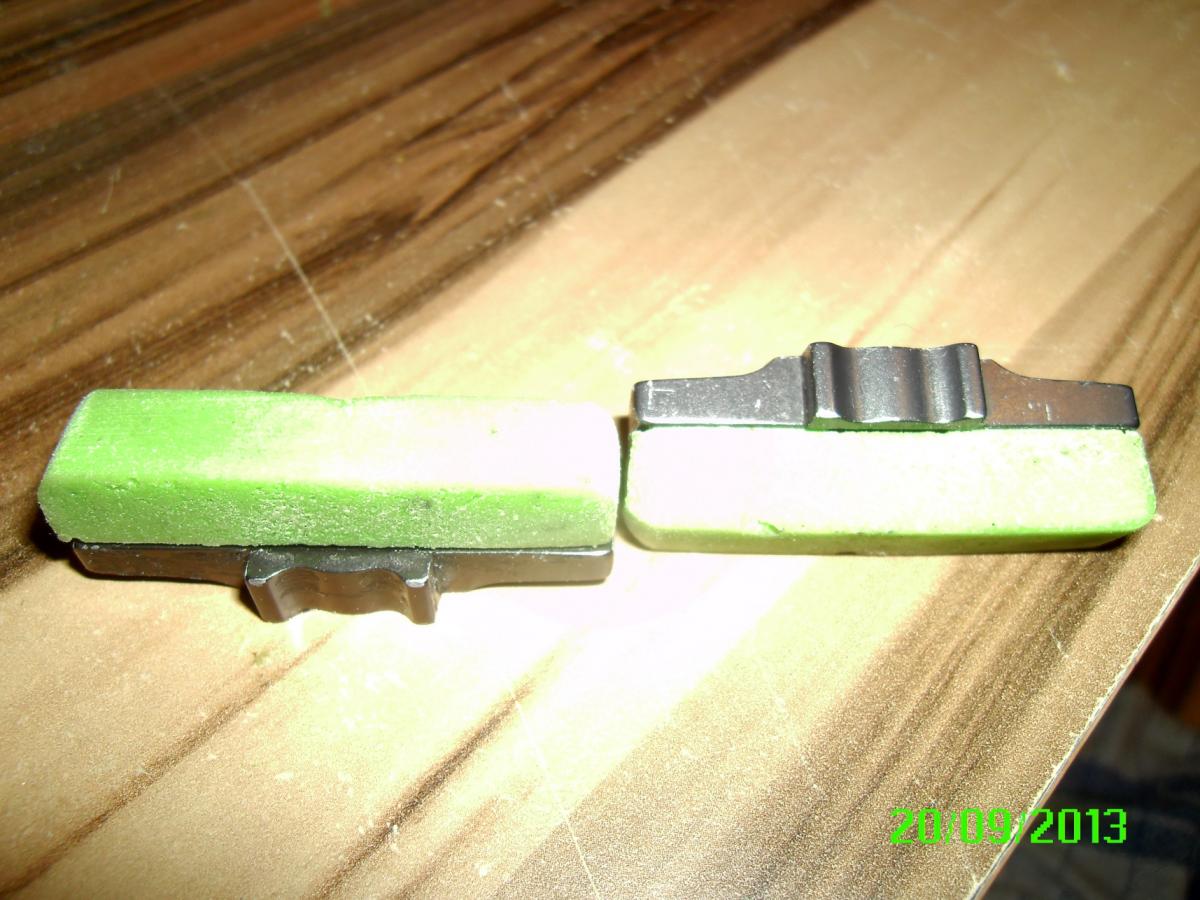

pads are trustworthy,but:
my grinds pretty dead,so they didnt perform as good as i thought.
they seem to be a fair bit harder than echo snowies,which had the same feel of low bite,great hold when i rode them.
so,that are officially the harsh grind pads now,will try a softer set now and these again when i ground my rim freshly.
they took a good while to develop a relatively "un-loud" honk,maybe beacause theyre that hard it took that long for them to align to the rims sidewall angle...
but hey,it works!and there are many copounds left to try.
pretty proud of myself,i made a safety-relevant part of my bicycle by myself without decreasing the safety aspect haha
test vid will be uploaded in a few mins

Seems a pretty respectable test model, few people hit gold fist crack So fair play.
While your there could you develop pads that work On unground rims?( I really hate the look of a grind) It might be worth testing your pads on both..
I must confess i reallu wanted to see a slo-mo face plant but hey ho :P just kidding im glad it went well.
i kind of expected a crash,but even after 2 hours session i just came hone from theres no issues.
after half an hour they were aligned to the rim and got better in bite,but they deffo want a grind.
to be honest i AM making softer compound pads as we speak,so there should be some for smooth rims.
only thing is that the smooth rim pads need to have a cold polymerization(to get rid of the elasticity,which is there first),which means they need a week to be rideable.
the hard ones can be tempered in the oven,as i mentioned earlier,so they take 4-8 hours,then after cooling them down they can be installed directly.
the fresh pads in general are like silicon for sealing bath tubs and stuff,pretty wobbly.
after the curing process theyre less elastic,but can be torn apart easier.
you dont wanna know how many pads i broke apart to determine the right moment to stop curing hahaha,think its 5 pairs

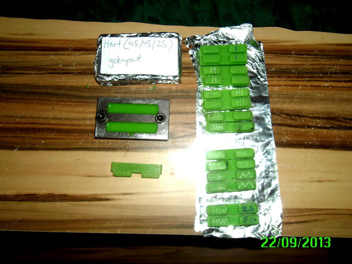

so far i got 1 hard set installed,4 sets of hard pads in stock,and the rest you can see here in the making.
2 of those are exotic compounds with too much colour,just to try its influence to the compound,the rest is a smooth rim compound.
in my experience the colour is softening it up again,which makes things even more unpredictable...
i´ll send 2 sets to dave33 to determine their hardness and to have a second opinion about their performance,he´s going waaaay bigger than me,so its a good test for sure.

so,as i said to öiam in a pm,i´ll definitely try all compounds for myself before giving any pad to anyone.
dont want to use someone as a crash test dummie.
the only one who will get samples for hardness testing is dave33,he built the mould for me,and i cant thank him enough!
(he made himself a test dummie through this,so its okay ;),little joke)
once the testing is done and the right 2 compounds for smooth and ground rims are found i´ll give some away,for the cost of postage and a little donation to keep me supplied with resin.
once theyre one like another and without any imperfections theyll be a tenner or so,just to compensate the few € the material and an hour of time,costs me.
thats pretty good regarding i have energy consumption using the oven for tempering and working with irritating stuff.
that would be 2-3€ per set i got, to put them into future development,sounds fair to me.
