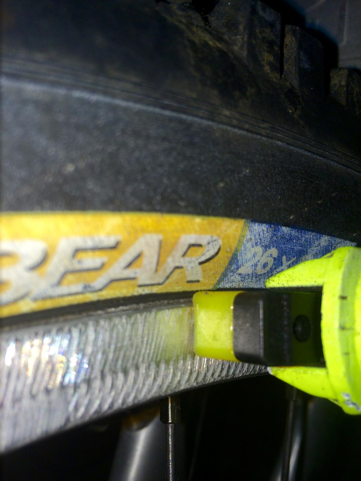

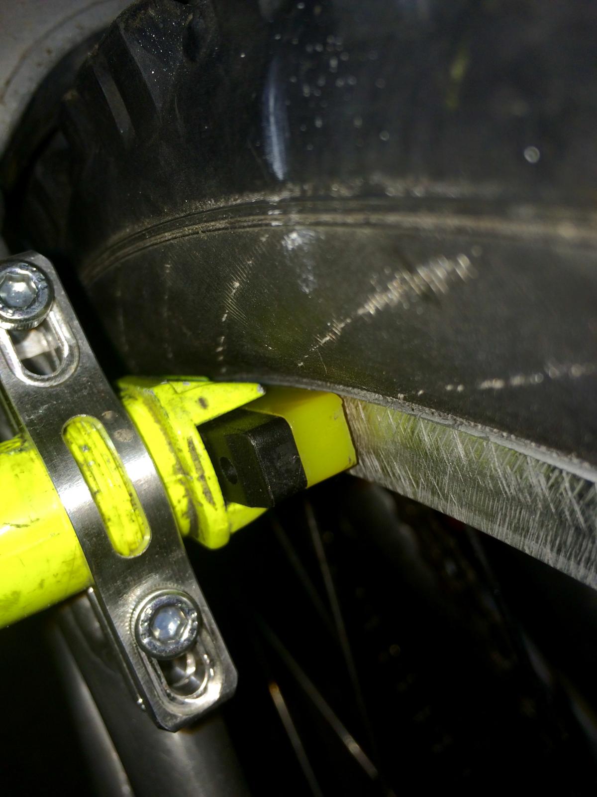

Can you post some pics of the bike, rear wheel and how the brake currently looks set as close as possible?
Was being an idiot! Hers some photos, if you'd like more just let me know.

I see your point, the only thing I can suggest would be to file the dropout slightly to allow the wheel to sit slightly forwards in the frame.
It's a really strange situation which I could only put fown to the wheel being egged or something but you'd be able to tell that pretty easily!
What rim is it out of curiosity??
I have no idea what the rim is I'm afraid I'll have a look in a bit see if I can find any branding. I don't think its egged, like you said that's a pretty easy spot. However, I do have tyre rub on the frame in one small area on one side of the wheel though. But I've put that down to tyre bulge as the sidewalls are as thin as paper.
Will have a play around a bit more, if not I'll just see if there's another cheap rear selling on here, just to try it out and see what happens

You've deffo got the axle slammed in the dropouts?
Off the wall idea but is the rim dished to one side? That would drag the rim downwards towards the dropouts.
Beyond that file the dropout about a mm towards the BB.
I'd personally go rear V brake with heatsink adapters as you'd have al the adjustment you'd need, but that may have to do with me having it all already :giggle:
