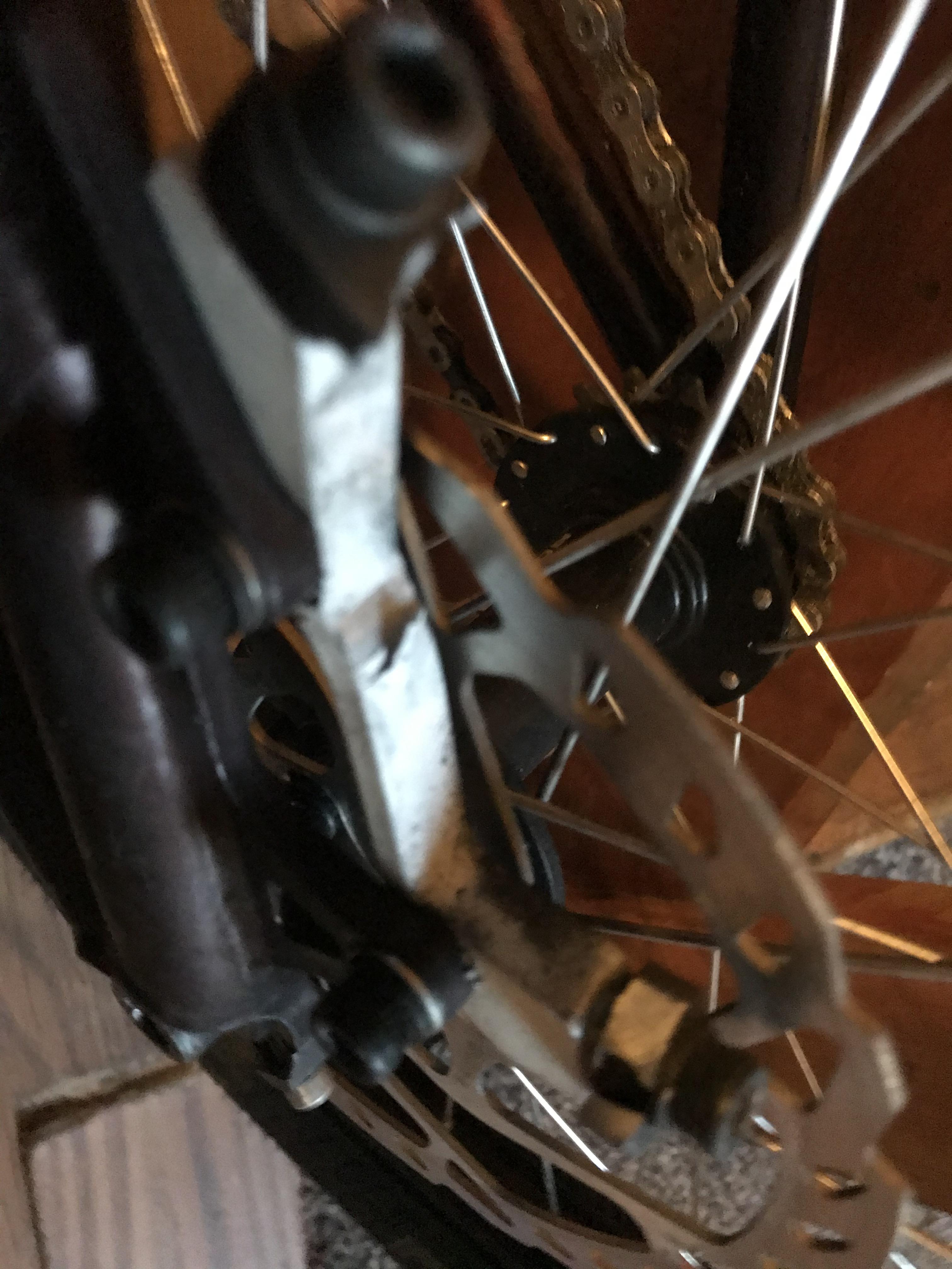

I actually just snapped a Magura adapter QM41 (IS rear 180) on my 26" czar and didn't even notice it before the brake started rubbing slightly. Technically the caliper remained attached by the rear bolts only without snapping completely off, which is crazy considering I even managed to gap few times without noticing anything too weird.
I don't think the QM41 has enough material around the front bolt hole (snapped right there), and the design adds too much leverage after the bolt, so I don't recommend using these at least.
But personally I would stick to Hope, they just look more solid design and material wise.
Edit: I mean would you trust this:

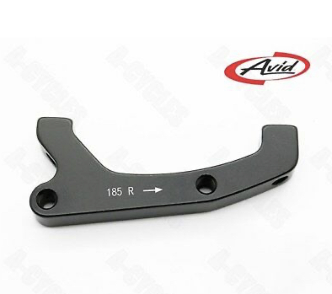

A lot of people have had this problem over the years, it tends to be the over tightening of the caliper on top which can weaken the holes where bolts go through or there is a lot of shock going through the setup when running a 203mm rotor. But as your running a 180mm rotor it’s hard to tell if it’s just weak about the holes on this particular caliper or you just had bad luck this time round.  I went down the root of running one of these adapters.  Yes it’s a 185mm, but you can either file it down yourself or take it to an engineer to put it to 160mm/180mm. Plus there cheap on eBay, I’ve not had any problems since. I run a shimano 203mm icetech rotors with shimano Zee brakes F+R. I also put one fat washers with green cab bolt on top of the calipers to give them a bit more stiffness.
https://www.ebay.co.uk/itm/Avid-Post-to-IS-Disc-Brake-Mount-Bracket-Adapter-REAR-for-185mm-Rotor/352149302576?pageci=22d30051-18d2-4329-b7f4-d3d33d11e7b8&epid=1305524222
QM41 is the one I broke too, same place. The Hope equivalent definitely has more meat around that area.

Search Hayes or avid Fat adapter.
It might be difficult to get one in 180mm. I only managed to find a 185mm here and filed it down https://www.ebay.co.uk/itm/Avid-Post-to-IS-Disc-Brake-Mount-Bracket-Adapter-REAR-for-185mm-Rotor/352149302576?pageci=22d30051-18d2-4329-b7f4-d3d33d11e7b8&epid=1305524222
Edited by John Shrewsbury
1 hour ago, benmh said:
This is very, very interesting indeed! That is almost millimetre identical to mine.
That's a pretty feeble looking adapter.

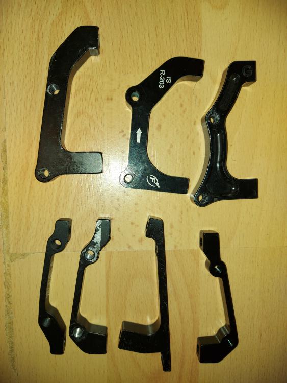

15 hours ago, LEON said:
There are 2 kinds of adapter...
If you knowingly use anything like the bottom row you deserve to get injured.
Looks like me and OP have learned this lesson the hard way, what is fine for a mountain bike is not always okay for trials! Got some Hope adaptors on the way...
  • Like 1
Pretty much. But an OLD Saint, new ones seem more fragile. Just find out all the brakes that are powerful enough, then pick the best built caliper, trials is too much for a lightweight/xc caliper.
