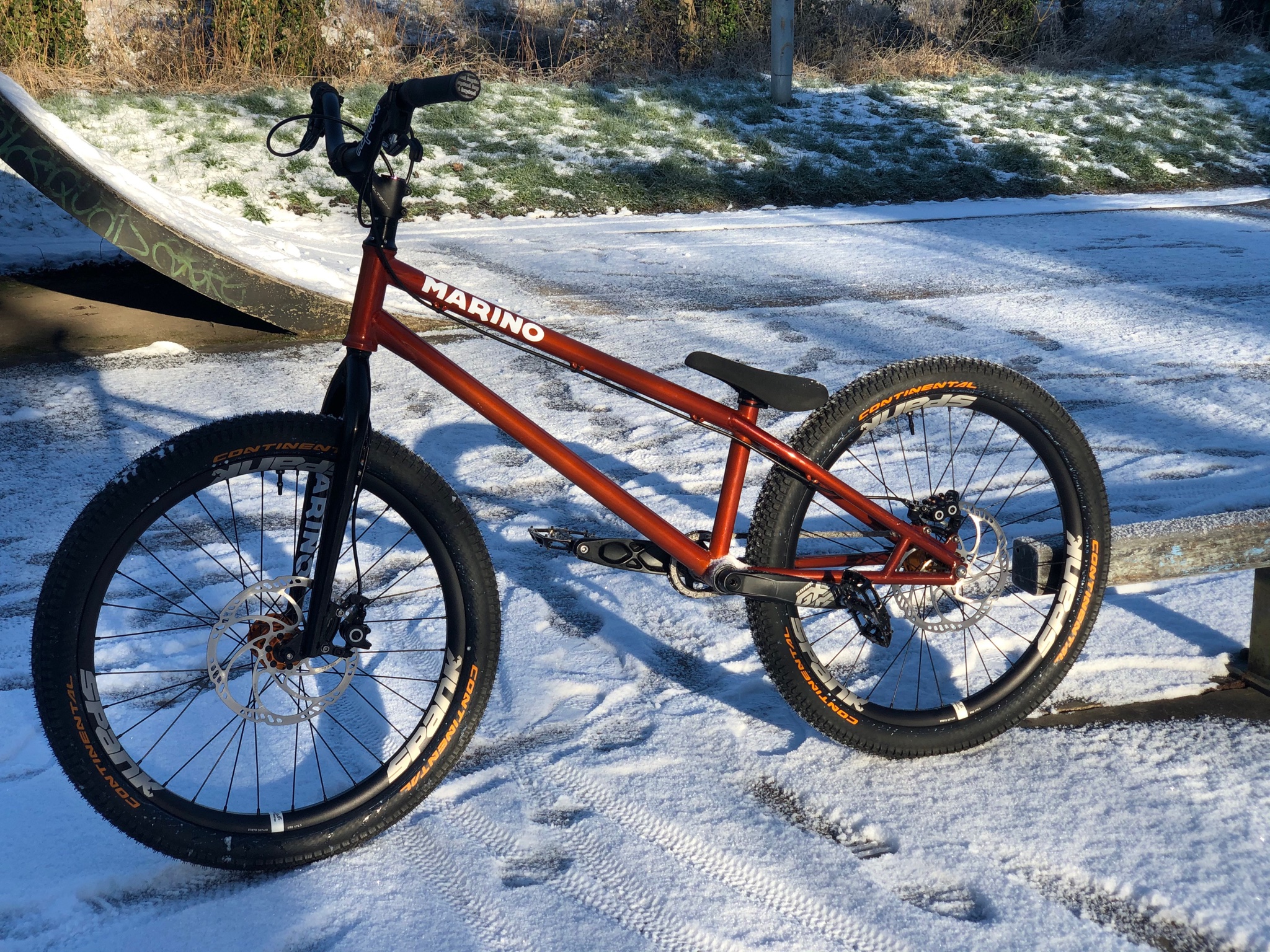

I am about to build up a dual disc 26inch and am planning to go with Magura MT trail sport and swap the 2 piston to the front and 4 piston to the rear like Ali C does, at £160 for the pair they seem like the best value, also come with the better lever blades too.

Exactly what I have done:
works a treat!
