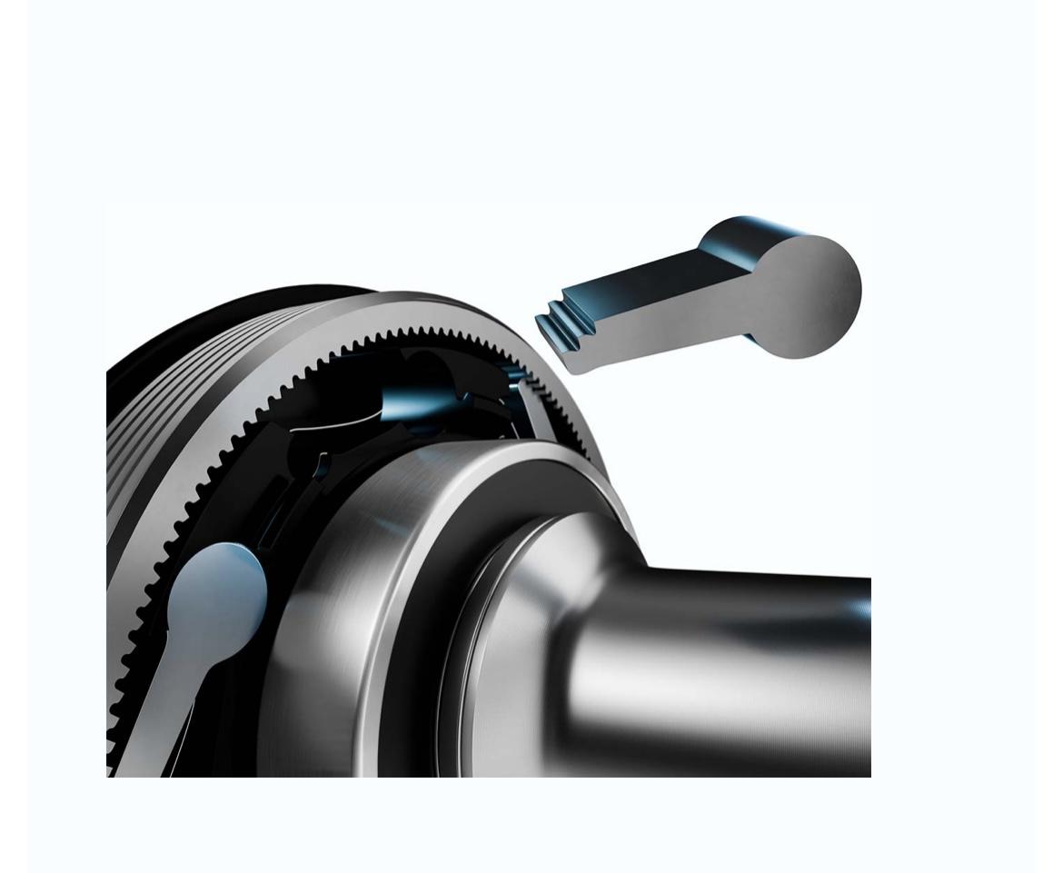

BUT they have just brought out a hydra 2
anyone used it? Has 3 teeth per pawl which is effectively tripling the grab when it engages
its designed for emtb so will be to take high torque

For outright strength I think I’d go pro4. Hydras are very good, but the Freehub body is aluminium. The harder you can kick, the more the pawls dig into it and oversize the pawl seats / sockets.

Have you tried installing two pairs of springs behind each pawl? Ever since I did that, skipping has been relatively minimal. It is obnoxiously loud now though. And those pawl pockets are getting pretty stretched out.

Well, in case of the Hydra, it does improve things a lot, except for sound. Was originally suggested by I9 themselves, after I contacted them about the constant skipping, and them having already replaced one hub. It'll help in longevity of the drive ring, the teeth of which will get rounded off with every skip, not good since they're so tiny already. Rolling resistance is still low; compared to my FFW bike, it almost feels like being propelled on an ebike, rolls scary fast :D
