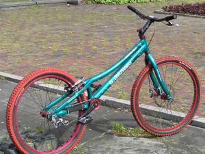

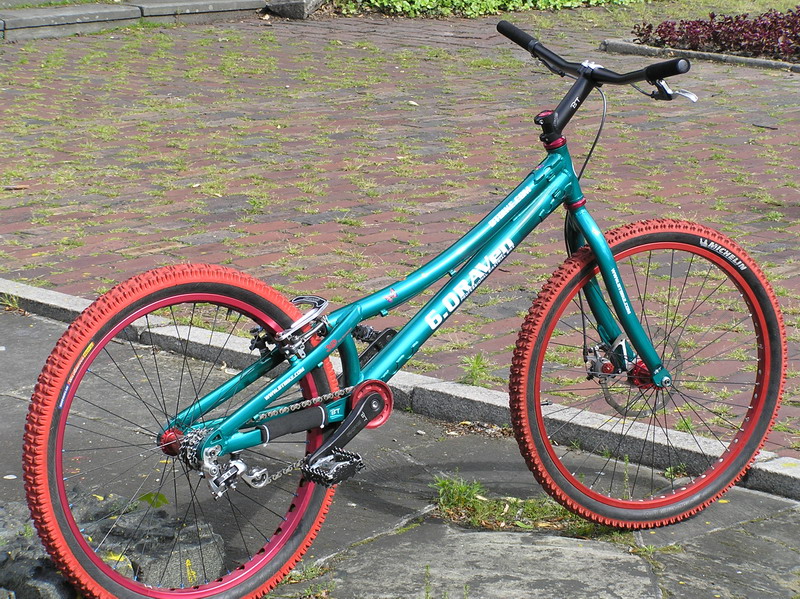

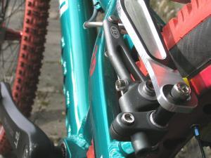

My current set is:
RIM BT 38mm Double wall
Levers XT
Brake AVID 1D 2000 year
XTR Cables
Pads CRV
My previous set up was HS33 2004+CRM and HS33 2006+CRM.
Conclusion...will never switch to HS33 Magie...maybe rear disc but no more HS33.
Olso I could say that narrower rim 38mm compared to 47mm gives me better dump using same tyre 2.5.
