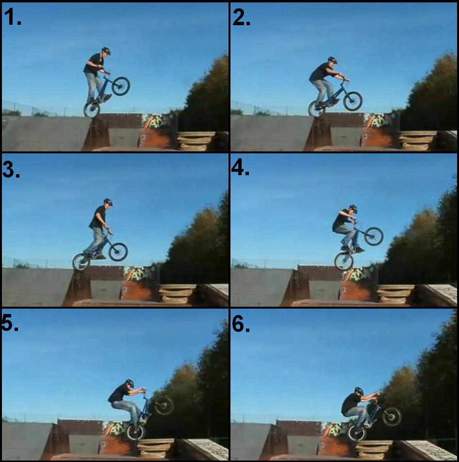

Sequence:
1. Get close to the edge.
2. Drop the front, and start to crouch down/back.
3. Preload - Start to kick the pedals, and move your weight forwards.
4. Mid air - Tuck, and try and keep the bike up with you.
5. Landing - Get the backwheel on the edge, and start to tuck down.
6. Landed - Tuck down to absorb impact.
Sequence:
Good tips there, nice gap too (Y)
