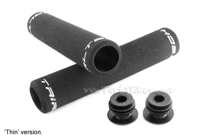

Put about 5-6 cable ties on the INSIDE of the grip, with the pointy end pointing towards the stem.
(Thanks www.tartybikes.co.uk for the image)
