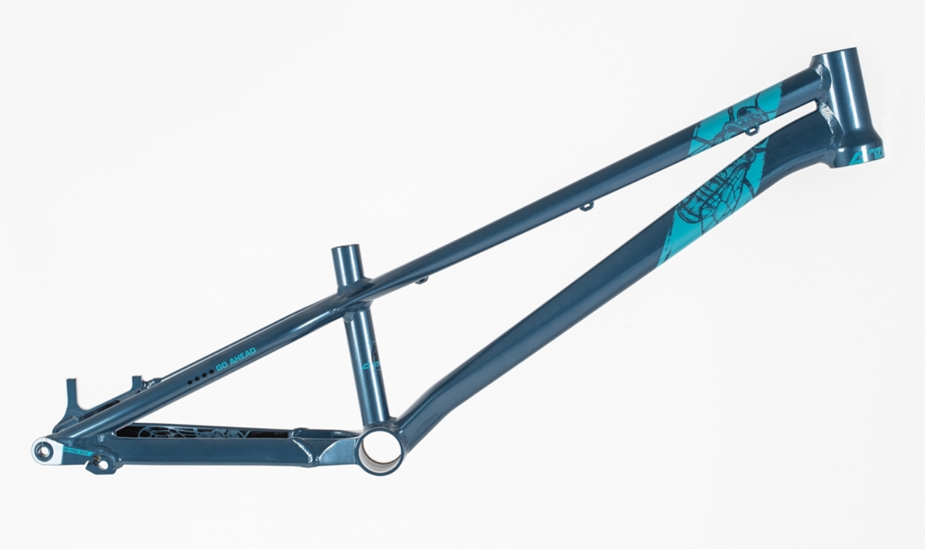

  5. It looks like a tapered steerer. I'm not crazy about the post mount in the rear.

  7. Oh thank god it's got a seat! Now that's a great price point too. This will probably sell better than the 20. Well done Alias.
  8. If it's made of steel and has no seat it's dead on arrival. What 24" really needs is a better choice of rims. It's a wasteland out there for 24" rims. More tires would be nice too...

  10. Who's gonna be the first? Almost makes me want to get another 24". Still a little rich for me at the moment sadly. No geo yet that I can find. Good to see another trials company making a street trials bike at least.

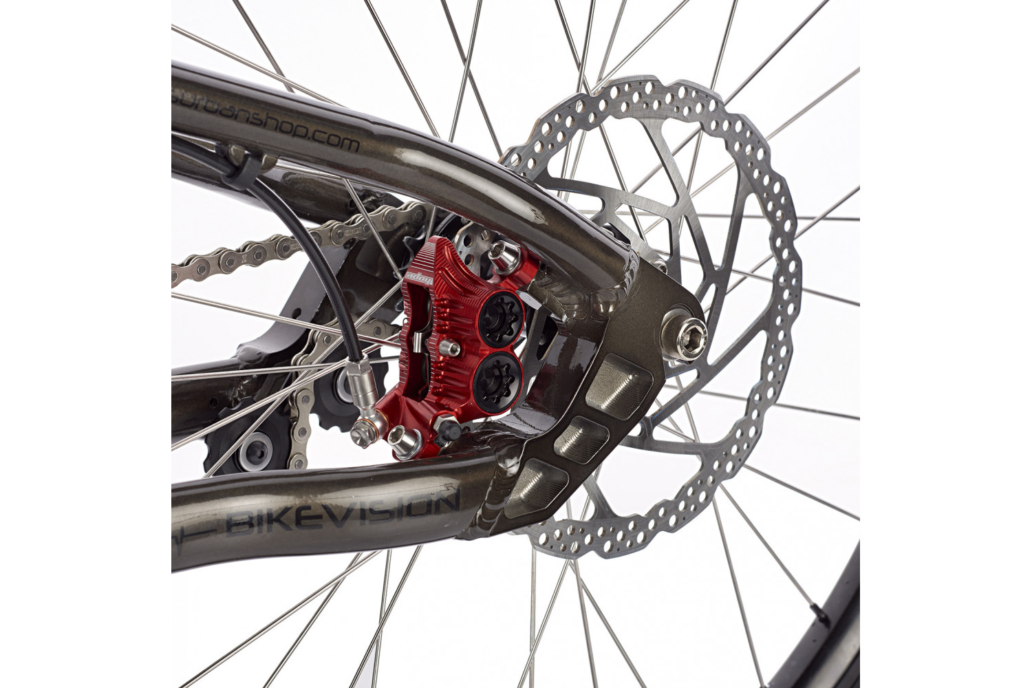

  12. Those are pretty good points, Cap. Also, in this position, doesn't the caliper become part of the rear triangle and get stressed from braking, ie it becomes the support brace. Seems like it would be beneficial to run an adapter to take those stresses, assuming you CAN run an adapter.

  14. Has anyone seen one of these in the flesh? The geo is nothing new, but that rear brake mount... Gimmick or improvement? I really like the Camo Ti version of the bike, but I have no money.

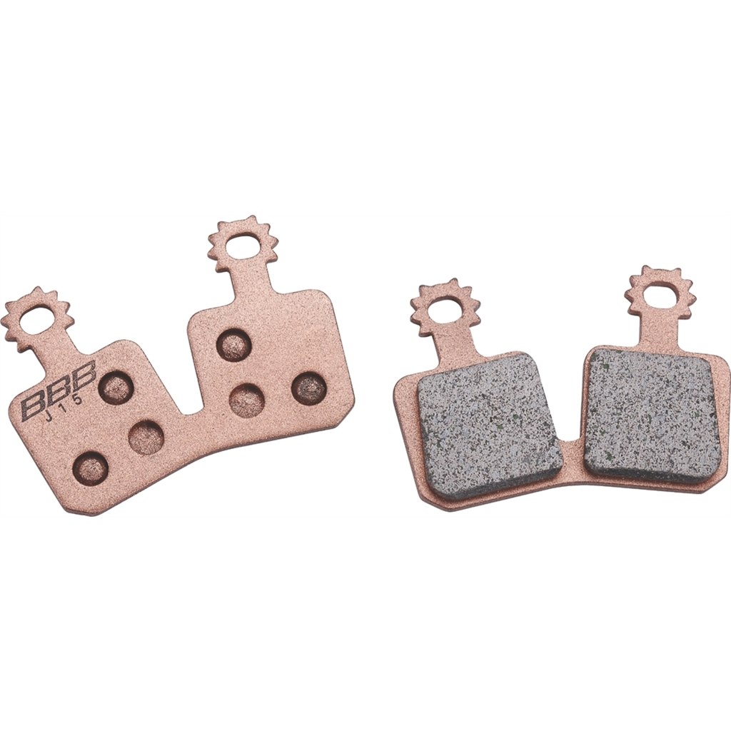

  15. Magura MT5, 62 Euros on Bike24. But if you're snapping Saint calipers... that's some serious hardcore.
  16. You answered your own question. Even on a properly working MT7, the BAT adjuster doesn't do much. MT5 levers are far more robust I've found. I gave up on MT7 levers years ago because they're overpriced, delicate and just too fiddly. What's you lever angle? If you run your levers closer to straight down than level they'll fair better in crashes. You can try a Shimano lever too, but I still prefer just the no frills MT5 levers

  22. I've been very impressed with the abilities of a Magura MT4 up front with 203 rotors. I ran MT5s for years up front, but the MT4 gives you plenty of power (for the front), but with great modulation. The MT4s also retract the pad farther than the MT5/7s so less rubbing in general. Plus, there's quite a few aftermarket MT4/6 pads to choose from, although the 9.Ps are great pads all around. The MT8s have been discontinued and you can find them for pretty cheap now (comparatively). I've always wanted to try one of those up front.
