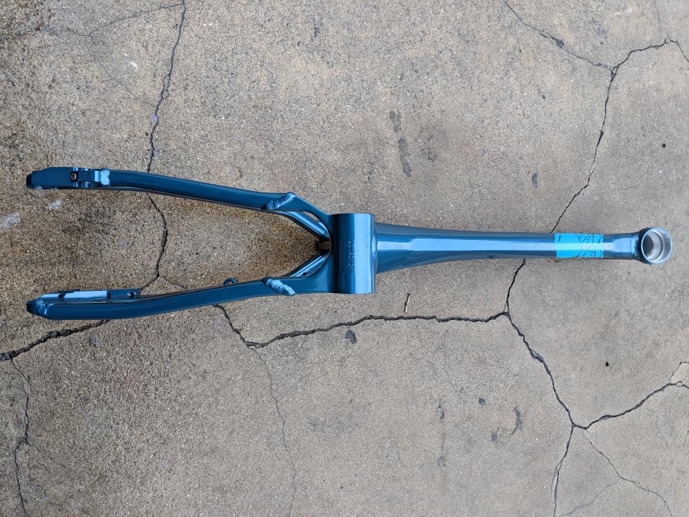

  1. So here's as far as I've gotten. I managed to modify my Profile 10mm bolt on hub to work with the 12mm through axle as a surrogate wheel until I get my I9 hub. I might be able to get a Shimano crank to work, but it'll have to be a 'boost' version that I don't currently have. The Bonz is on, but trials cranks on a street bike is still silly. Since I had to go with the Bonz, it's 18t and sadly I don't have a 13t for the Profile (stupid proprietary splines!) so now I'm waiting on a 13t cog (or a Shimano boost crankset, hmmm...).

  8. The 91mm isn't the real problem, the offset is. I don't think a 22t and a bashring will clear the chainstay yoke. I'm going to borrow a friends 'Boost' XT crankset and see if it'll work, but I don't have the BB yet. I emailed Bike-trials.com in Spain and they got me a frame in no time. I emailed Serious Connection and TMS as well about it and they never got back to me. Ridefactory.ch has just the frame on their website.

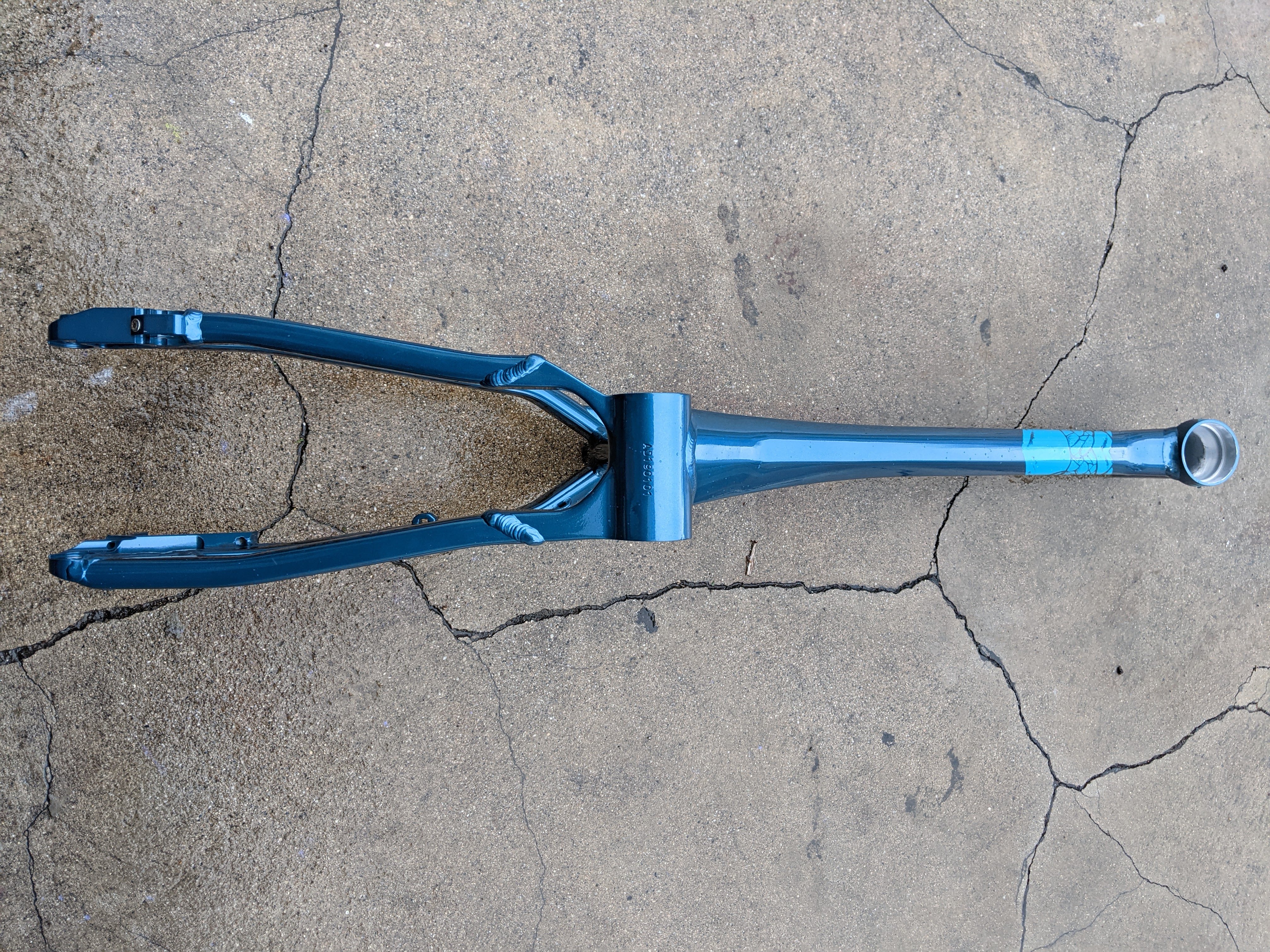

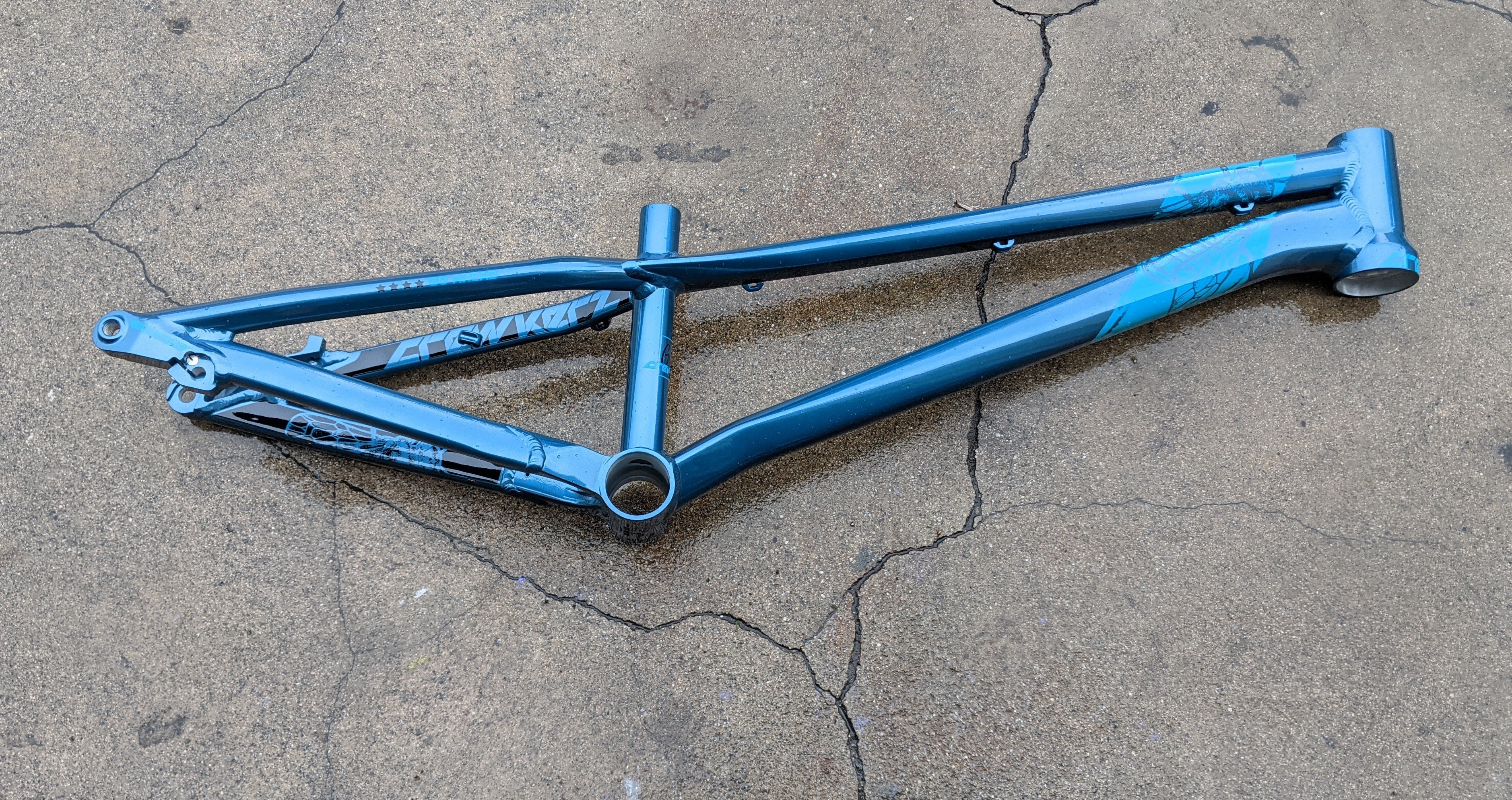

  13. The BB is very offset. The problem with the AS30 cranks on a street frame is that they are entirely the wrong application. The AS30s have more than enough room for a bashring and front freewheel and that's way too much room for a single chainring setup used on a street setup. Ideally the BB bearings would be as close to the chainring as possible to minimize the side to side force on the BB axle. The offset BB is completely unnecessary unless you are forced to use the AS30 crankset. I'm gonna try to put Shimanos on it, but failing that, the Bonz splined cranks have less offset than the AS30s and will allow me to run an 18t cog. I prefer 22 - 16 ratio over 18 - 13 on a 24" bike even though the 18 - 13 is lighter. Headset is installed, front wheel built, BB is in the mail, but the rear hub hasn't even shipped yet :-(
  14. Dear god what have I done! So I ordered one of these silly frames, but honestly thought about sending it back once I saw the bottom bracket. So disappointing. I'm now waiting for a BB that will fit, but I'm not sure I'll be able to run my beloved Shimano cranks. Early indications are 'no' sadly. Luckily I still have one of those Bonz splined cranksets lying around so I can run 18 - 13. I had one of the Crewkerz AS30 cranksets in the past and it would be awful in this application so I'm steering clear of those. Very sad to see this BB on a street bike. Hopefully the full build will be fantastic. For anyone else that follows down this treacherous path, here are some useful numbers: BB shell width - 91mm (!?!) BB shell bore - 46mm (PF30 etc) Headset - upper 44mm internal (called 'zero stack' in the US, NOT integrated) lower 56mm internal (ZS56 standard) Headtube - 125mm long Seatpost - 27.2mm Rear dropout - 135 x 12 through axle (same as Crewkerz Jealousy) Frame weight - 1.9 kg
