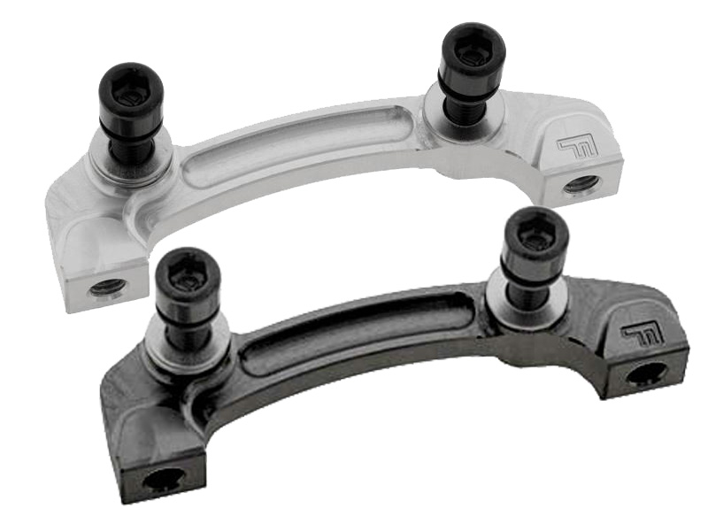

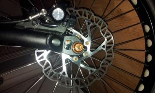

This is what I have. And it states 160mm on the internet and marked F. I think I have figured out what the problem is. Different manufacturers do not standardise adapter markings, so F from brand X is different to adapter F from hope.. How confusing!
I see, it was just confusing seeing F and that was the adapter im ordering lol Anyone else think its just a "+0" adapter? Cheers
Hi all, yes its me again I'm going to upgrade the front rotor to 180mm hope saw on my Trial Zone (currently 160mm). Put all the bits together in tarty basket and then went to check the bike and just make sure I'm ordering the correct adapter (adapter F) (on tartybikes it says adapter F is for 180mm front 160 rear) So I look on my bike and see this... "F" How come im running a 160 on an adapter thats application is for 180?? Has it been installed upside down maybe? Here is a picture... (1sec)

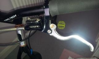

Yes black 07 hope mini lever. Thanks dude I like it too Got a new cap for trial zone also and diaphragm. Pic shortly. Cheers

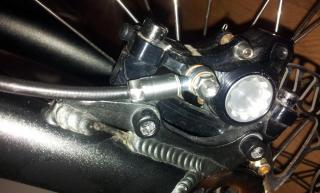

Cheers lads I got a hope one. And new pads and nut and reservoir cap and bolts and diaphragm's. And cleaned disks and bedded them in today. Feels almost new, just waiting for tarty to get the brass barrels back in stock and that will sort out the rest of the wiggle/play and then get the stan hose spares Before After Mmmmm Stans bolts, love em. Cheers all.

No the trial zone will not fit as the barrel hole and pivot hole are too close and off a different size. Thanks krazykid, I thought they looked simlar just needed someone to say yes they fit Thankyou for your replies as allways. Cheers
Hi all, Can anyone clarify for me what lever blade will fit this hope? Been looking around, I think it's a 2006?? Thanks

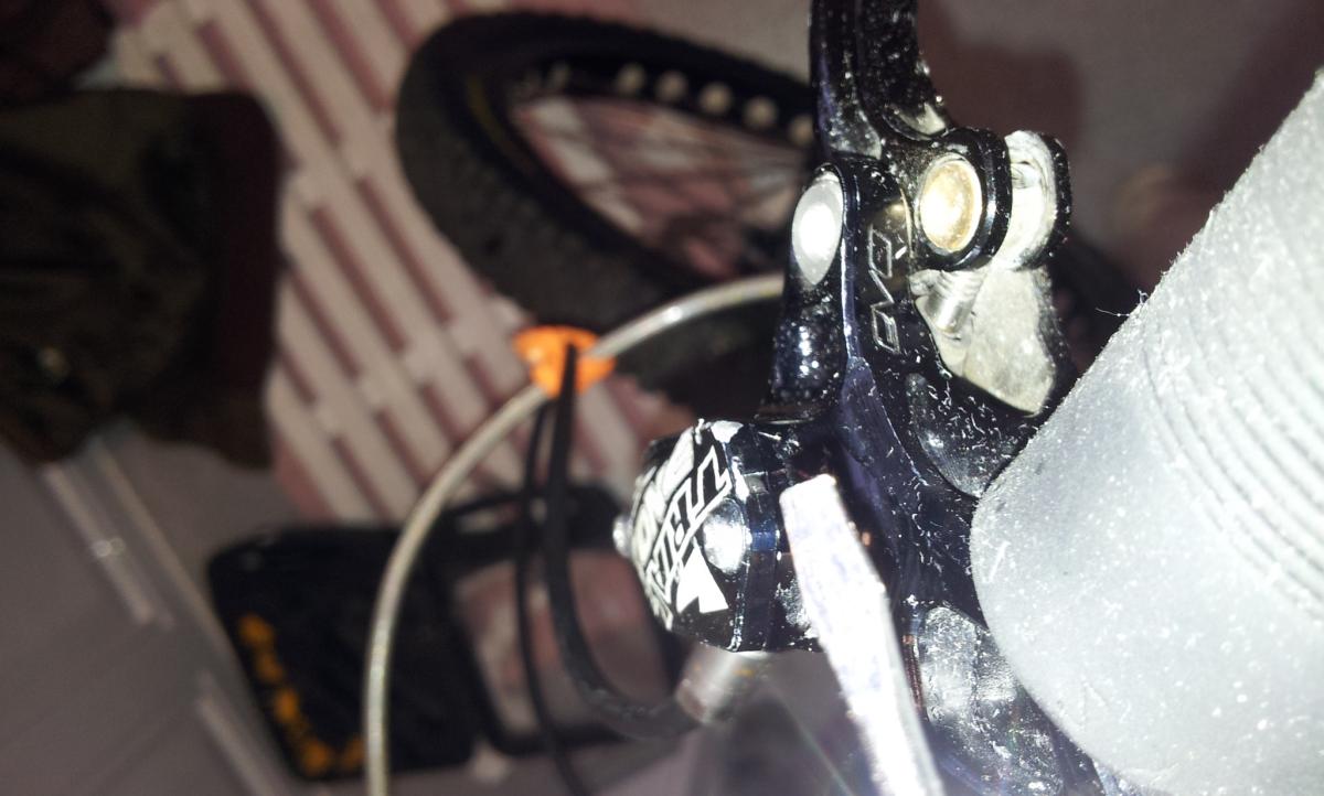

Naa this has been weldite araldite mega stuck.. the frame has been sanded even by the look of the edge...
I have some of those and I have had a go but I need to remove the lever so I can actually hammer it properly.. Thank you for the info mate, appreciate it.
How do I get it off? Not sure what its stuck diwn with.. and what shall I use to re-secure it to the frame? Cheers

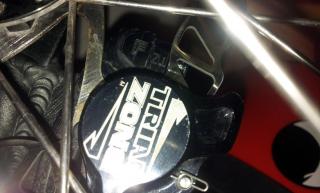

Thank you sir. I did some more Googling and found a little bit more info on the diaphragm. A few people have said it's quite normal for a bit of fluid to show around the MC lid after a fresh bleed. I guess that hole is there for a reason Another little thing is, on my other lever (mono trial) the reservoir bolts had been round off by whoever and I can't get them free with an allen key I was thinking; Pliars around the side if the allen bolt but cant get grip. So... Knock a slightly bigger key in. Saw a slot into the bolt and use a flat head driver? Which one seems the best idea? Or have any others? Im going to order new bolts also (stan Ti probably) Cheers again.
Hi all. Just blead my front trial zone and after rolling on the diaphragm and tightening everything up I hear a small hiss and tiny bit of fluid in the small hole on the reservoir (breather hole?) Is this normal? The brake feels ok even with repeted pumping. Is this just air trapped above between the diaphragm and lid? Thanks as allways. Mark This is where...
