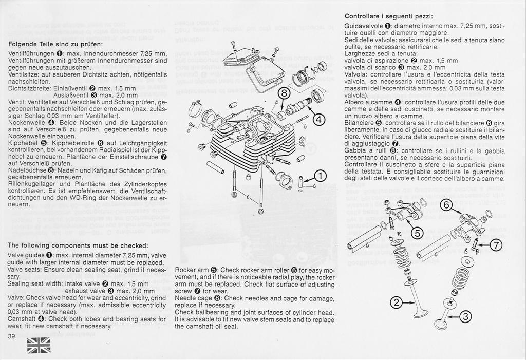

You never looked at ducatis desmodromic valvetrain? Work that f**ker out The wear on a bike isnt a major issue as the mileage and service intervals are generally very low compared to a car, for example my 2001 supermoto has done about 7500 miles and had best part of 10 full services
Not read all the thread then? One of the cam pulley bearing shit itself, shed the belt and lunched the valvetrain
The cam sits under the rocker (which has a needle roller cam follower) which in turn actuates the valve. Have uploaded a page from the engine manual which helps explain. The older oilcooled and early watercooled gsxr valvetrain was also done this was, not sure about modern bikes though. As will said there is no reason why there shouldnt be a hydraulic tappet aswell as rockers, on bikes theyre either shim buckets or screw adjusters, its much shorter service intervals though and easier to check edit: sort of beaten to it, exactly the same principle though edit: I bought the manual off ebay in pdf format so I dont really think there are going to be repurcusions from me posting a jpeg of a photocopied service manual for what is technically and obsolete engine :D
My ohc motorbike engine has rockers and a cambelt, funny that - Why cant an ohc engine have rockers?
