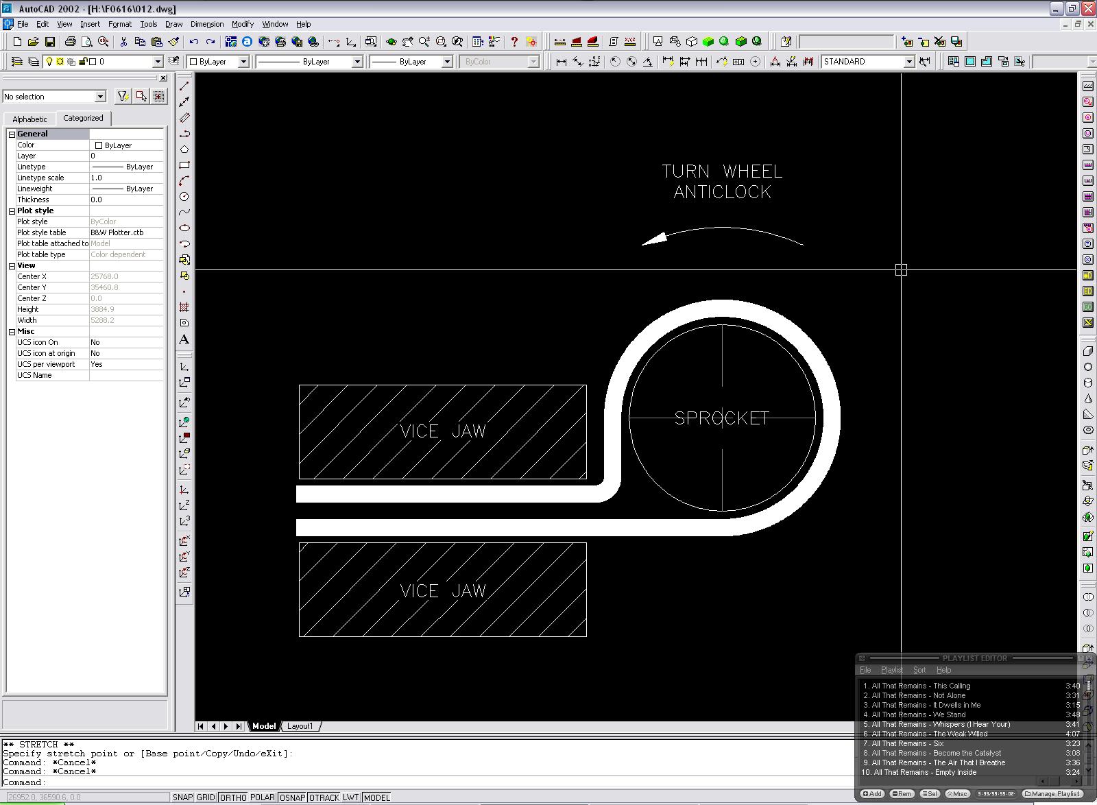

Good point, Ive never used FFW or fixed sprockets, only cassettes and lockrings so not fully conversant I would vice the 2 loose ends of the chain though, if you clamp the sprocket in the vice tight enough to stop it slipping then youre likely to be deforming the thread and making your job harder See my attached quick autocad sketch of what I would do
IMHO I dont think youre going to be getting it off without the rim and spokes, certainly not without causing pretty major hub flange damage from having to grip it in a vice I did exactly the same on my king hub and the lockring was too tight to get off, easy solution was to just pop the axle and driveshell out of the hub, of course you cant actually do this If I was in your position I would relace the wheel with enough spokes to allow you to turn the sprocket off, I reckon 8 either side should be enough
Muahahahahahaha Now go find some scales edit: the sprocket will be r/h thread so if the wheel is in the vice with the sprocket on the underside then you need to turn the wheel anticlock when looking from above (think of unscrewing a bolt from a hole ). If you have a chainwhip then you need to undo the sprocket anticlock with the sprocket facing you.
