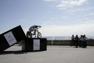

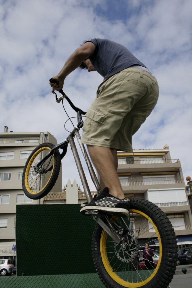

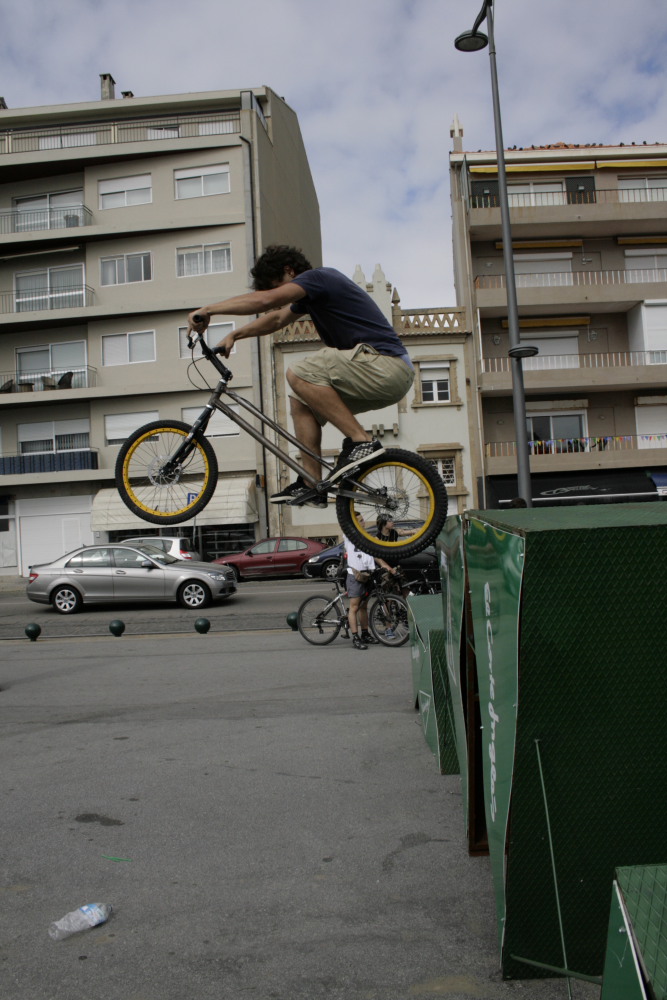

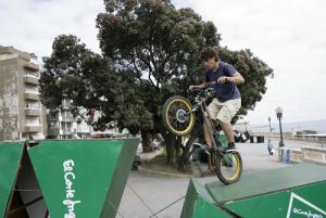

Mr. Long Mod reduced the frame to 1060mm and then filmed this:
http://www.youtube.com/watch?v=91ypyGRXjk0
He is still running a regular mod stem (150mm) and says the bike is da bomb! Some Spainish pros tested it out and aside from the frame's weight (~3kg) they liked the geo. So with some luck some company will soon start pumping out real "long mods".
