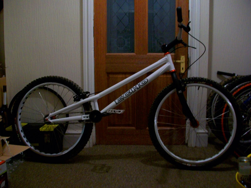

I realy hope Rob enjoys this bike, i built it for him the past few days, i was very surprised by the quality of the new echo parts actualy, the frame and forks are very nice! light too!
Specification if anybody wants to know:
Echo control 09 frame
Echo Sl 4 bolt forks
Pazzaz Stem
Trialtech Bars
Front hope XC built onto white Trialtech sport rim, try-all tyre
Rear CK classic built to white koxx rim, try-all tyre
Middleburn RS7 sq taper cranks, custom milled 20t bash
Viz sq taper BB 127.5mm
FSA orbit XLII headset
Magura Hs33 front and rear with rock blue pads and 4 finger lever blades, echo urban 4 bolt booster rear.

Amazing looking bike! So clean and I love the black Middleburns on it. It is good to see that a person can run a King QR in those dropouts. I just love those tensioners.

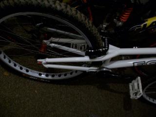

I was genuinely surprised how 'flicky' this bike feels for such a long frame. I would honestly say its not far off the ride of an Ashton, which for a comp frame, is pretty impressive. I put this down to the weight. It is Ridiculously light. Again, this might be down to the lightening of the front end, but it certainly rides naturally (that is to say it feels good as soon as you jump on it). On the back wheel its solid as anything, and the geo feels spot on. The frame is also surprisingly stiff, but i wouldn't want to run the back brake without a booster. The urban 4 bolt I'm using does the job well, without adding much weight (which, to be honest, is the main point of this frame).
Extras
Although its obviously hard to tell from a single ride, both myself and Bigma have been impressed with the little touches on this frame; the hub tension bolts are rock solid and easy to use, as well as being fine (so far) with a quick release (most riders will probably choose to run bolts). One disappointment I have found is that the frame cable ties are a little cheap (one has snapped off already), its a shame they didn't introduce internal routing, but this is a small complaint against an otherwise excellent frame. My only other complaint would be that the echo frame graphics are a little unadventurous compared to other offerings (maybe its because I'm a graphic designer!) as companies like koxx / monty make a great deal more effort to 'snazz up' their frames. The stickers are however, on top of the paint (which is an excellent finish btw) so can be easily removed/replaced.
