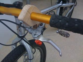

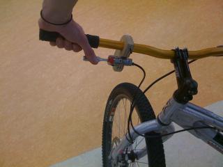

Ah also I video'd a ton of people using bikes and close ups of brake usage during XC riding.. you'd be surprised how much your thumb flails around when you're riding + your thumb accounts for about 65% of the grip on your handlebar.. take that away to use a brake and you're gonna get hurt!
You can try a thumb brake with this simple set up..
I also reversed it simulate the braking motion of pushing down on the lever.. safely got my over a 3ft studio workbench.
