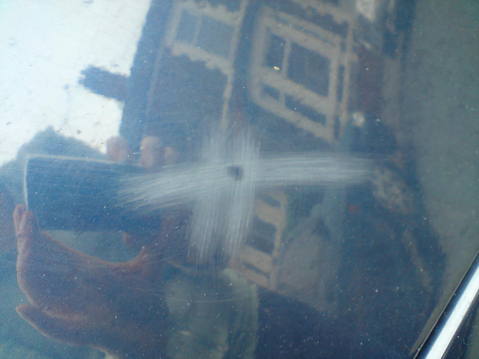

Some scum bag has scratched my girlfriends car. Looks like they've used a medium grade sandpaper and scratched a cross into the drivers side rear panel (Ford Ka). It's approx. 5" x 3" and I've been told it feels rough but not deep.
It's scratched white...if that makes a difference, perhaps a base coat of some sort? However I'm guessing they'll sand away a section and re-paint that regardless?
Obviously, I know nothing of this but I'm guessing some people have experienced this and can offer advice. I'll put up a photo in a moment when my Blackberry has finished updating.

You might be lucky, and get away with some fine rubbing compound and t cut on that. It looks like its just cut at the lacquer, not through to the colour, so hopefulyl wouldnt be too bad.
Excellent :) Thanks a lot (and TomR!)
It doesn't actually look so bad on full screen, she only sent me a photo on my phone and it looked awful on that. A close up and you can still see the colour behind it.

Worst come's to worst and if it won't T-Cut out/compound, get some very light wet an dry (1500-2000 grit) an using water with washing up liquid in, lightly rub it down until the score's have gone, then bring it back up with compound and then polish. Should fetch it out but only do it as a last resort really......
Is that colour magic shit any good? With the dye? Or will t-cut do just as good? And can you find an example of the rubbing compound you mean? :)

As george said, abrasive compound and polish is the way to go.
Going by that picture I don’t think you’re going to completely remove it by hand.
You may have to go down the route of machine polishing, and a 2 step method.

As a professional car valeter I have seen this a few times.
As said above it looks like only the surface has been scuffed, hopefully only the laquer. Most cars have roughly 30 layers of paint so hopefully you can gain them layers back!
First rule - t cut is a no no, I don't care what anyone says, it's dreadful stuff!
What you need is Farecla G60 compound, personally i'd use a medium grade. A mopp would be ideal (buffing machine) although you probably don't have one :(
Apply the compound in a circular motion, then rub off in the same motion, you may need to apple a few coats.
After you have applied the compound you need to protect and seal, therefore I would use Auto Glym Radiant wax to finish it off :)

As for cars having 30 coats of paint. Your kidding right! Paint thickness on cars varies between 180 microns to 240 on some german wagons, out of that around 40% will be clearcoat.
I would say looking at those scratches you should be very careful as to not strike through. Ideally you need a paint thickness gauge to check if it can be repaired without needing any paint.
Give it a go and if it doesn't strike though then happy days if it does then its respray time.
