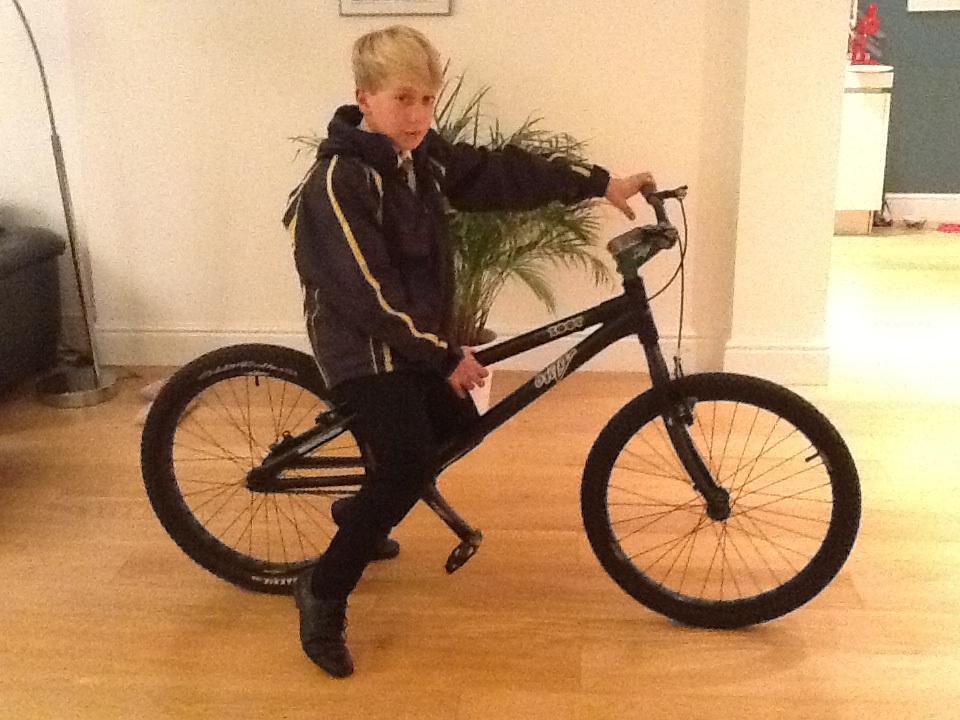

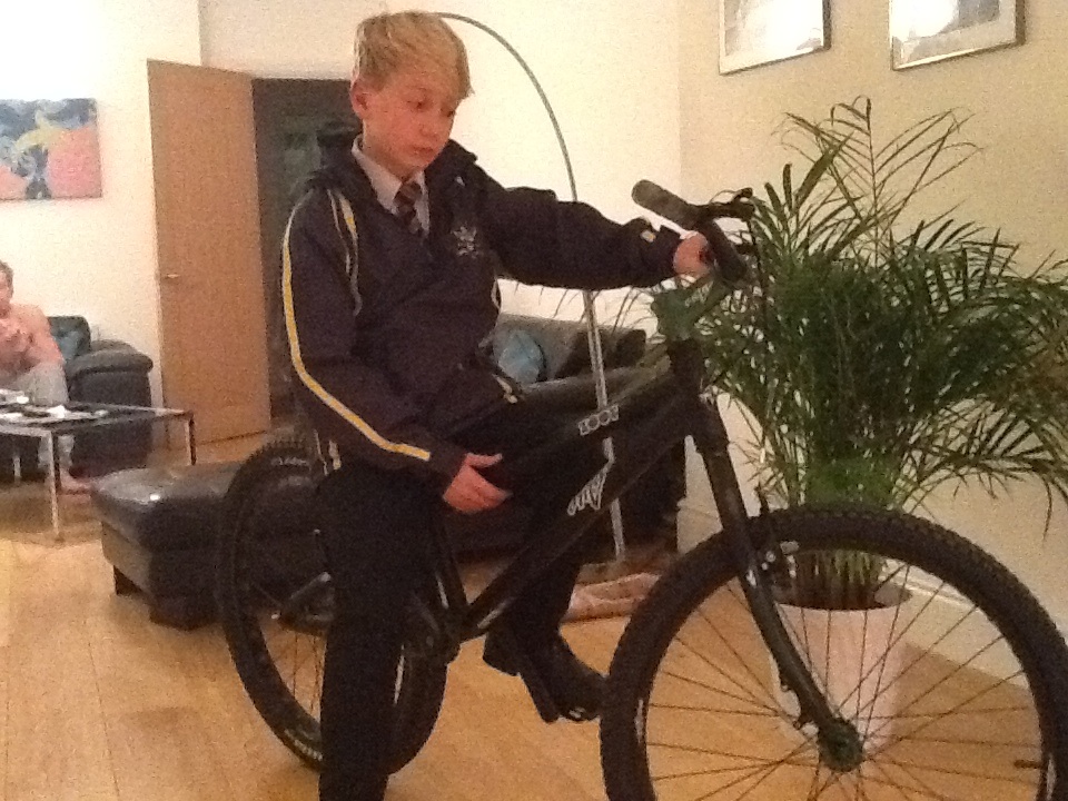

Here it is ! He said he can already do an endo ,bunny hop and wheelie on it. It looks a bit big for him I think but we were sort of expecting that. He says the reach to bars is a little too much, but loves the fact that it feels so light compared to his bmx.
Glad to hear he's enjoying it!
