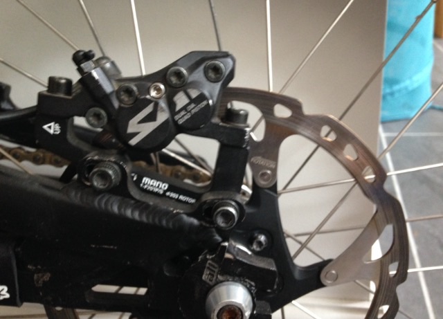

You can use a front 203 adapter as a rear 180
Herbertlemon102
Strictly speaking it's 1.5mm too high, but yep, on any IS mount frame a front adaptor will work on the rear with a 20mm smaller rotor.
This is standard, rear IS mounts are 20mm smaller disk than the front :)
For information a 185 avid bb7 IS to PM adaptor when turned upside down will fit a 180 hope rotor.
Well I've learnt something today! Haha.
if you slid the caliper back as far as you could in the frame mount, wouldnt it bring the caliper slightly down?
