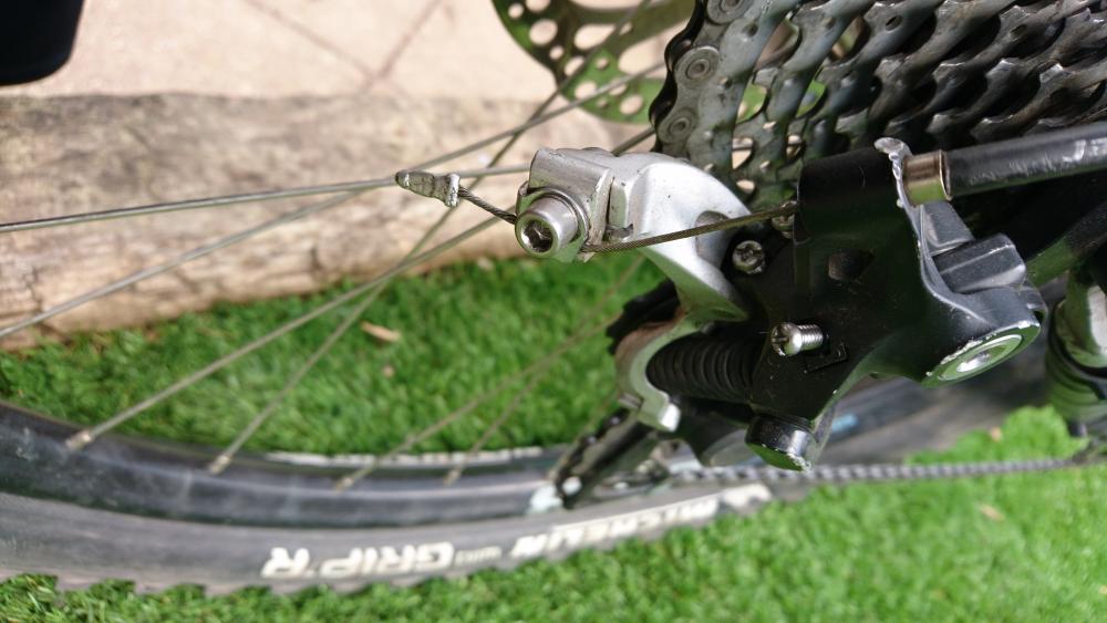

My issue now is trying to set up my rear derailleur. It's obviously not moving far enough to the right, in the bottom gear it jumps between the bottom two rings. But when I mess with the set screws I see absolutely no movement.
Edit: Scrap that, been so long since I worked on a bike with gears forgot which way around they were. Gears shift and line up fine. It all just sounds like a cement mixer when I pedal.

But, I did take it out for a test ride and once I got the bike out of the house and onto the road it didn't really seem to sound that bad. First time I've used a bike stand to mess with the gears indoors so maybe it was expecting it to be silent. Also a few miles on it seems to have helped too, seemed much quieter after it got bedded in... if that's a thing?
How old is the chain and cassette? If it's slipping on the rear sprockets at all then I would replace both chain and cassette. It should run almost silent with a well lubricated chain.
