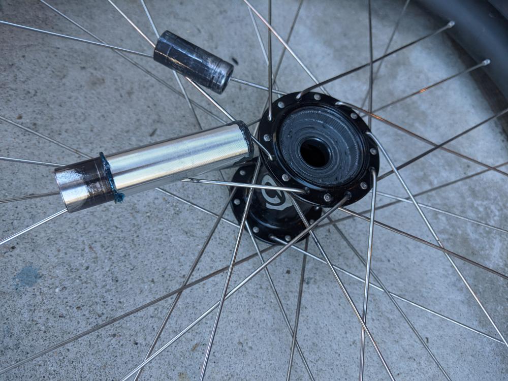

I finally got around to putting my new titanium cog on my Hydra and I noticed there was some odd play in it again. I pulled the freewheel and inspected the bearings, but everything seemed fine. When I9 warrantied this hub a few months back, they sent me a full bearing set so I decided to change the hub bearings this time, even though they looked fine. Once I got one bearing out it all became clear. The axle was broken!! The axle has stops on it that sit against the bearings so even though it was broken, it wouldn't fall out. I ordered this hub as a bolt on originally and they sent me a 10mm through axle conversion in addition, possibly by accident. At any rate, I had a replacement axle on hand so in went new bearings and new axle and now, again, it feels all good.

I have to say, the axle must have been broken for months and I rode it to the top of my level and never noticed anything that would have made me stop riding. It's rally (racing) tough for sure. I have no intention of going to another hub in the foreseeable future. Nothing's perfect and nothing last forever; especially trials related. Now I have a full understanding of the periodic maintenance I should do and their hubs are simple to work on. I'll be build another Hydra wheel in the coming weeks for my Silex and I'm not worried in the least.

Hmmm, you seem to have most of the bases covered. Bearings would seem to be next on the list. My freehub side bearing was toasted only after the axle was broken, but I didn't realize it was the axle until after a new bearing.  For the Hydra single speed hub, the bearings/kit you want is: TKMB03 TORCH - MTN - Rear Bearing Kit (1x61804, 1x61803, 1x61903, 1x31803)  Hope that helps. I would definitely contact I9 before ordering because they've usually sent me what I need under warranty even after the warranty period was up.
Don't take this the wrong way, but check your through axle; for tightness and tolerance - ie sometimes the through axle is tight, but there's still some room left between the frame and hub endcaps.

So, did some experimenting on why that freehub is binding, turns out there's simply too much pressure exerted by the drive side end cap on the bearings, when the hub bolt is tightened down. That's also of course why the teflon seal of the end cap got crushed. Turns out the axle in this hub is 0.2 mm shorter than that of the hub with the damaged drive ring I still have in a box for spares. Side by side it's even visible to the naked eye. Drive side bearings are toast already as well, obviously because of the too high preload. Switched the axles around, and the bearings too, and it's slightly better, although still not perfect. So this'll keep destroying bearings in no time. Looking for one or a few super thin spacers to stick between axle and end-cap to remedy this, but of course these are impossible to find. In contact with I9 about this. Man this hub is such a disappointment!
I mentioned the endcaps earlier because I've had one of my I9 hubs do the axle musical chairs a few times. It's gone from 10mm to bolt-on and back to 10mm and I noticed that the endcaps are not the same for each application and are different left to right (at least i think). When my axle broke (10mm version), they sent me a new axle and new endcaps, but the new endcaps had the binding problem that you mentioned. I noticed it right away and switched the dodgy one for my old one that fit perfectly. As far as I can tell, the endcaps have no identifying marks on them to tell which axle/configuration they belong to. I have a feeling they might get mixed up at I9 occasionally as well. I'm still very pleased with my I9s despite the hiccups.
