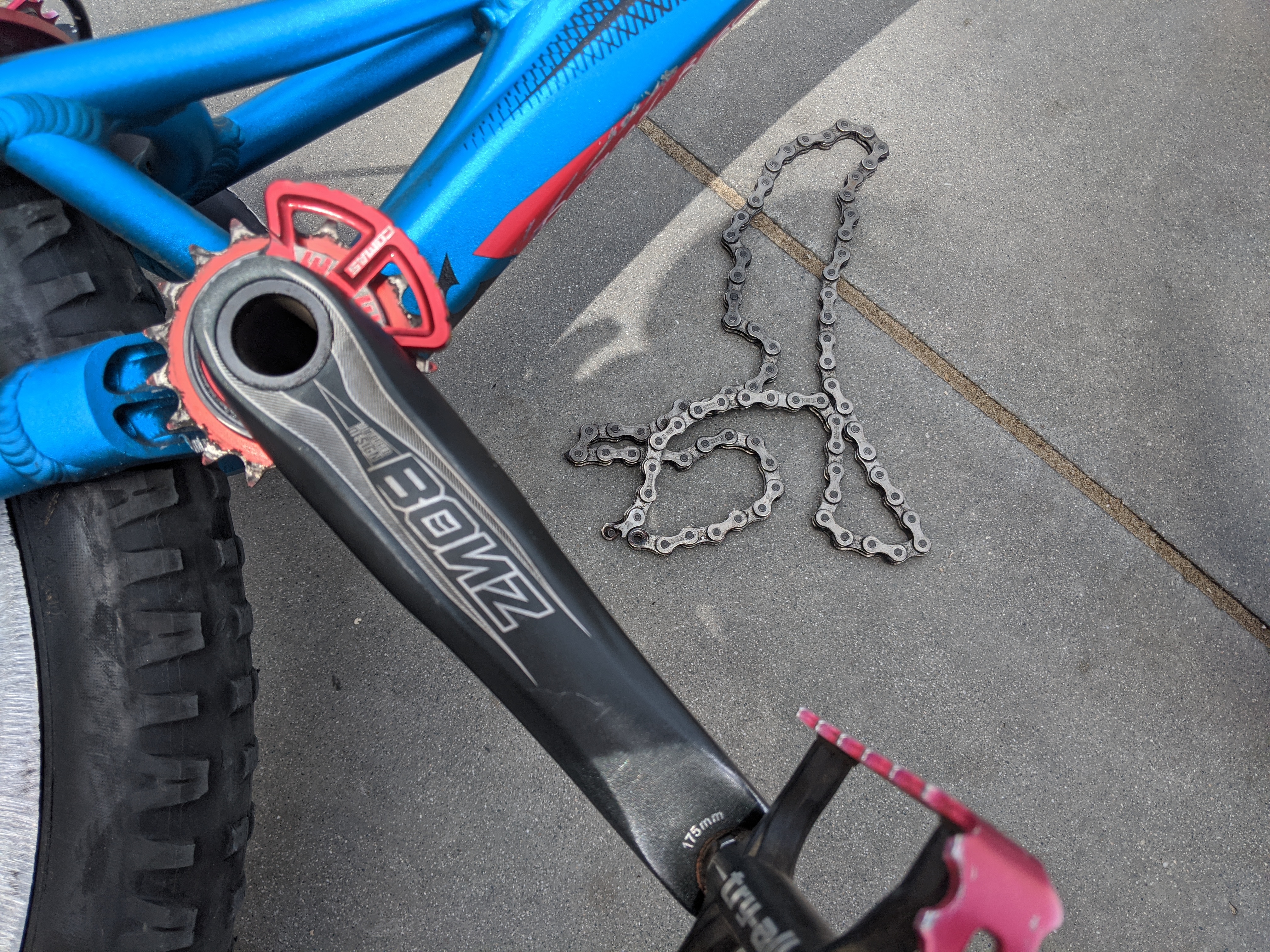

Over the years I've come to the conclusion that I must change my chain once a year as insurance against catastrophic failure at only the worst possible times. I use KMC 610HX chains on my pure and street bikes and I've never broken one. I've broken quick links and half links and each of those incidences set me back mostly due to injuries incurred from those breaks. It took months to get back on one spot where I broke a chain just from the fear memory that the spot invoked. Yesterday I broke my first KMC 610HX and miraculously it was during the setup hop before the BIG hop. I was about 4 feet up on a skinny ledge with a gnarly cactus-like plant on one side. Luckily I was able to just put a foot down and jump off the wall. I proceeded to thank numerous deities for my good fortune and then began the long walk home on my new 26" scooter with no seat. In all honesty, this particular chain was coming up on it's anniversary so maybe I should adopt a 10 month chain policy. How often do you guys change chains or is it always kind of a crap shoot? I haven't lost faith in KMC, but it can be a life changing failure.
