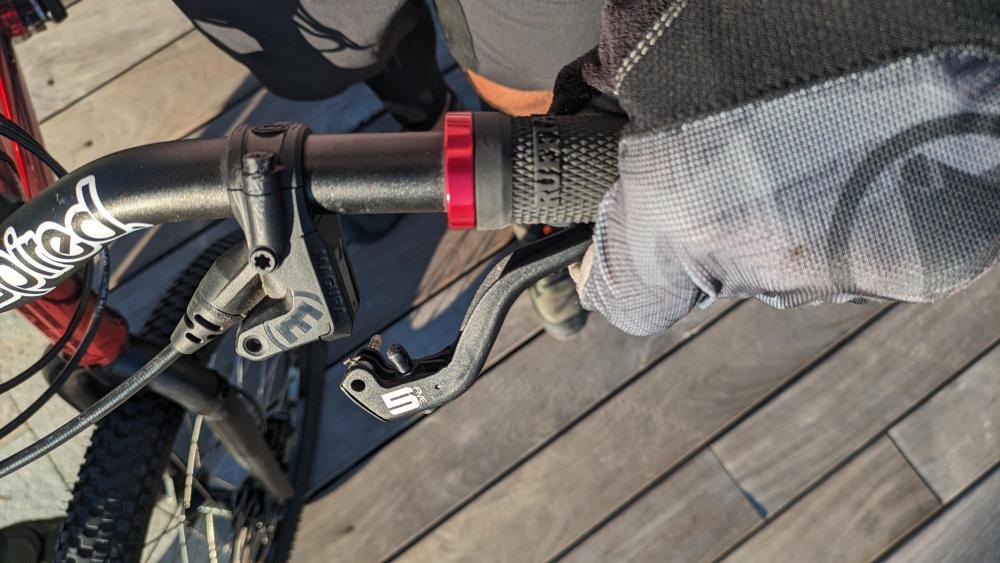

I'm looking around for brakes. I've an Inspired Arcade (red mirror frame from 2017/2018) and i just broke the front MT5. I don't want to repair it because of plastic things on the lever and i would prefer to substitute them.

To me i Just want a brake that Is powerful, that grants that when i Land on rear wheel (or similar) It doesn't slide. With strong/solid lever. With kinda modulable Power for manuals stoppies and so on but that works in on/off mode when needed for other things.
I'm fine with magura caliper i think... but i don't want anymore the lever to broke Just by pressing It when bouncing on front wheel, that's simply Dangerous.

The cheapest M6100 Deore.
One more thing. The clamp is in the center of the pump.
My handlebar is shortened and the lever almost doesn't fit.
The clamp falls out when bending.

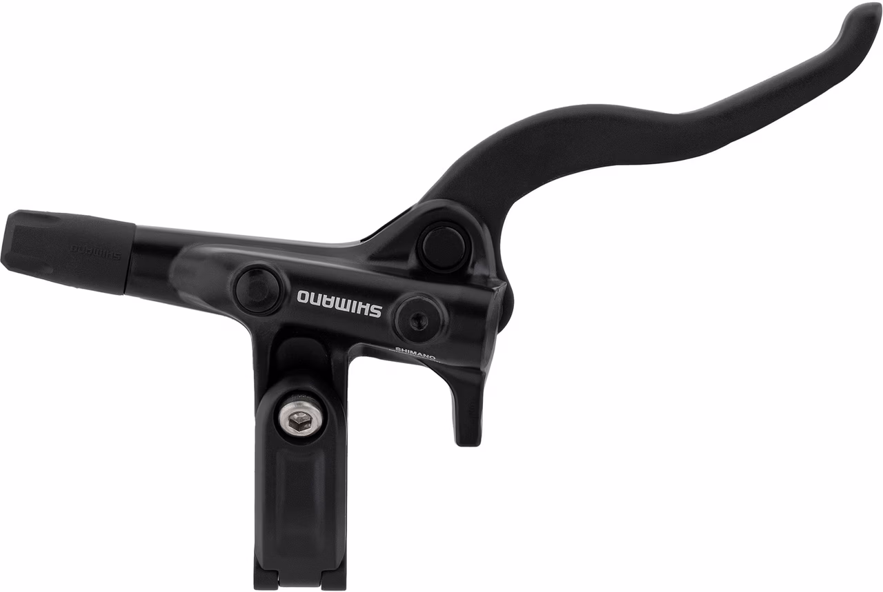

I got me the Shimano XT Trekking variant levers BL-T8100, they are modern and don't have the Servowave, so no wandering bite point. I have not much experience with disc brakes, only ran some Hopes a decade ago, but they feel OK for me, immediately got some stoppie success. I tried a Servowave XT MT7 Shigura in a shop, Trekking XT has way less flex.
Edited by stirlingpowers
  • Like 1
Nice to know.
But I am not sure about the stiffness of the lever: I have the same generation of XT lever with servo wave and this type of clamp, and the stiffness is really bad. It is OK on a trail bike but even on a DH bike I did not like it. The clamp is narrow and there is an insert made of plastic to mount shifter/dropper lever.
The newest design has a small appendix that improves the stiffness quite a lot.

But a Deore version (Shimano BL-M4100) for 20€:
Shimano BL-M4100 Bremsgriff - schwarz/rechts
