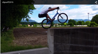

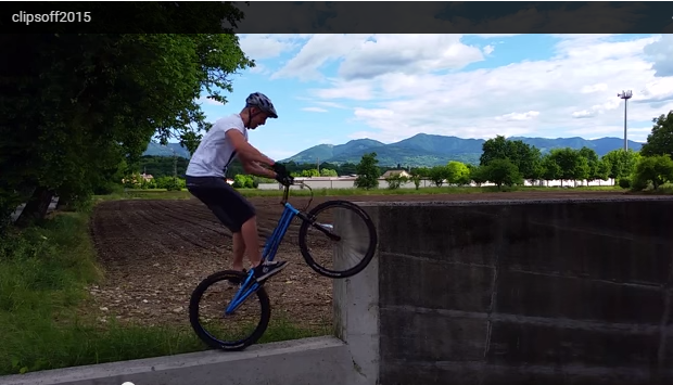

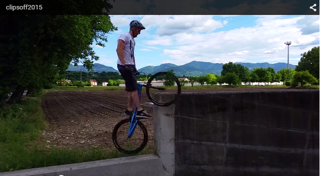

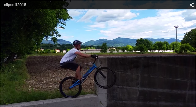

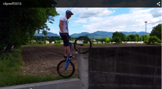

I've been trying to master this technique for a while now and have made some progress already. I am wondering about a thing though. With perfect technique it all comes down to strength. While I lack a lot of the first, I've got some of the last having focused on plyometrics pretty much all my life. What I ask myself is, how much improvement the technique brings over strength.
I have seen quite some videos over the time and am always impressed by how easy it looks when some guys do sidehops to rear on a 1.20m wall or even higher. When looking at these videos... is it really the technique that lets you guys sidehop that high or are you very strong?
Also, is the jump from bersha in the pics a sidehop or do you call it differently? And how much of his jump is technique and how much strength.
Thanks,
Nico.

The pics just show a static to back in my book, although the technique is much the same as a sidehop to back (apart from the twist). Others might consider it differently. Who cares what it is called, it is still impressive how high some can do it.
In my opinion, technique is a much undervalued attribute by some riders. Raw power alone will not allow you to Bersha / Damon sized sidehops.
