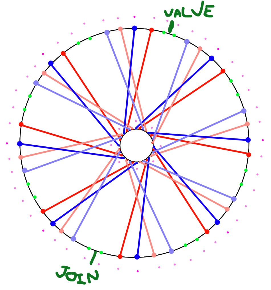

  5. I was going to call you out on that - I thought you were better than that - but when drawing it out I realised that 3x created some pretty insane angles and assumed you'd tried that and switched down to 2x 3x3x is The One unless there's specific reasons not to. (I have a 2x2x front wheel because most companies don't make spokes long enough for 3x on such a tiny hub flange and relatively large ERD ((single wall 20")) ).
  6. Would it screw with the lengths too much if you staggered them the opposite way? Latecross style. I know it leaves the seam exposed so getting the bob out might be a challenge, but probably nothing smashing it against the floor won't sort That would put your opposite side spokes together, which might make the build easier, And you'd be able to offset the sides a bit more normally. Think this is how roadies group their spokes, right? And they've got shit tonnes of money to pour into R&D Super pro image below to illustrate. Ignore the magenta dots - they were just a rough as hell spacing thing I forgot to remove. Edit: Just realised that if you have zero offset rims you could get super cheeky and push the trailing spokes back by one hole. Both sides of trailing spokes would then be on the "wrong side hole", but it would even out the tension over the circumference a little. So the pattern going clockwise from the valve hole would be: Green Light Blue Light Red Green Dark Blue Dark Red [repeat]
