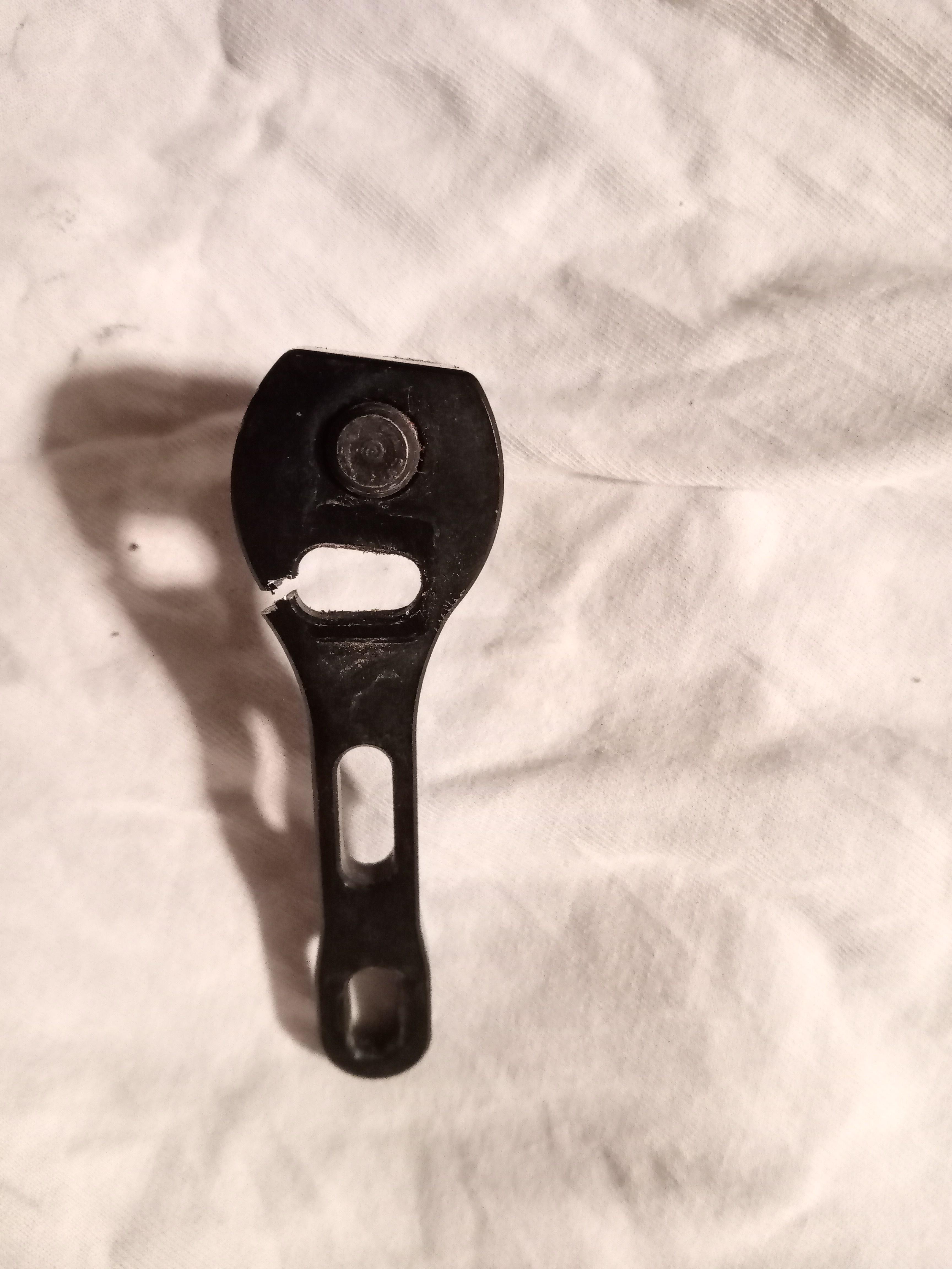

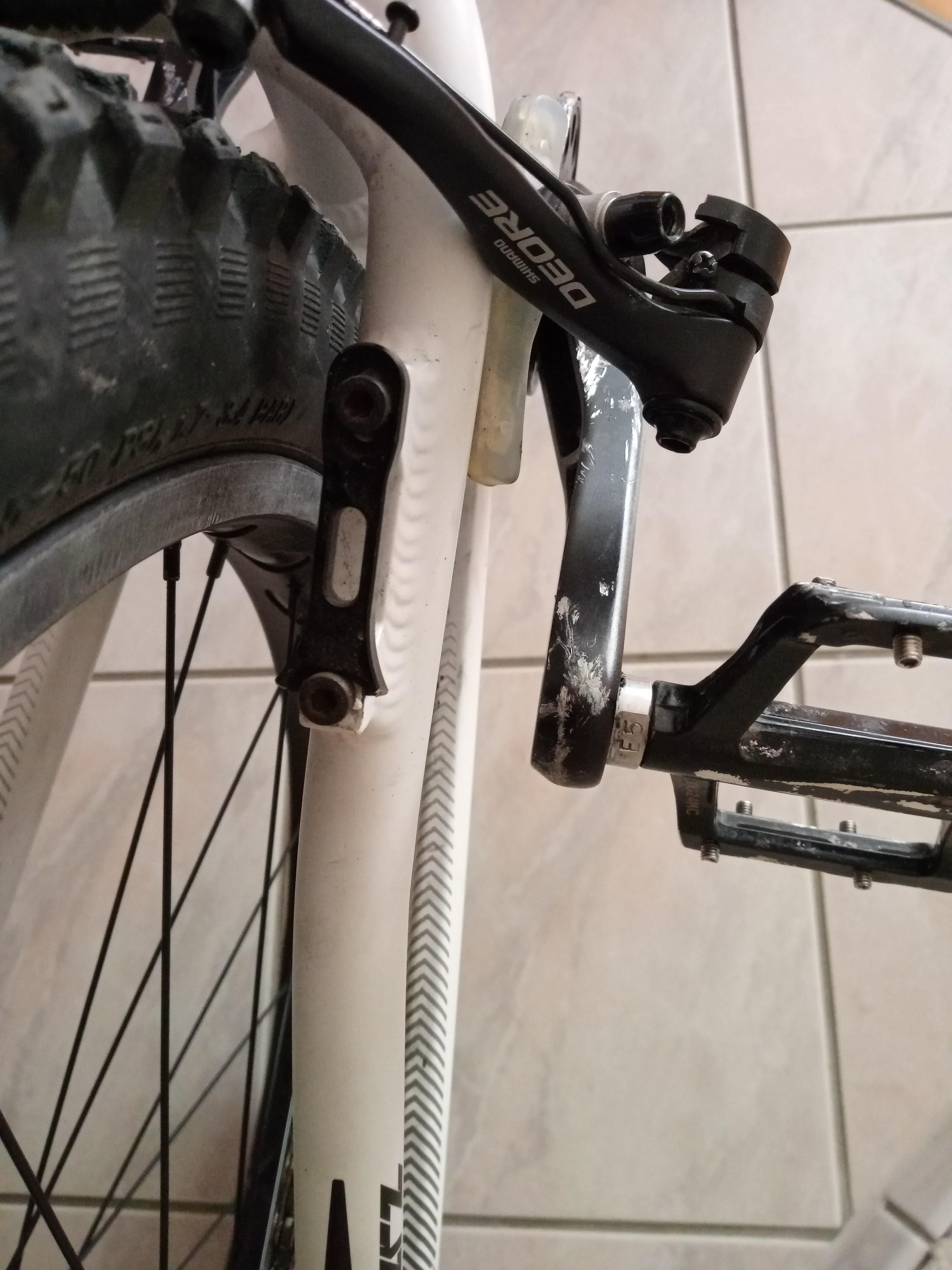

  13. I guess the boss tries to twist the adapter too: considering the picture on the right, the brake pads push against the rim and an opposite force applies on the V-brake boss, but with an offset to the baseplate. Thus, the top of the boss is pushed to the outside, while the baseplate is fixed and the low part of the boss cannot moves to the outside: this creates a twist, that occurs each time the brake lever is pulled.

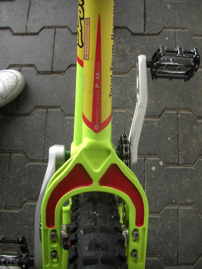

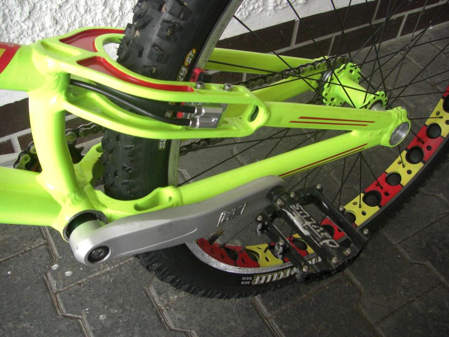

  19. Something like that: Hoffmann bikes. See http://www.t-t-h.de/Trial-Team-Hoffmann Home New Bike part4.html

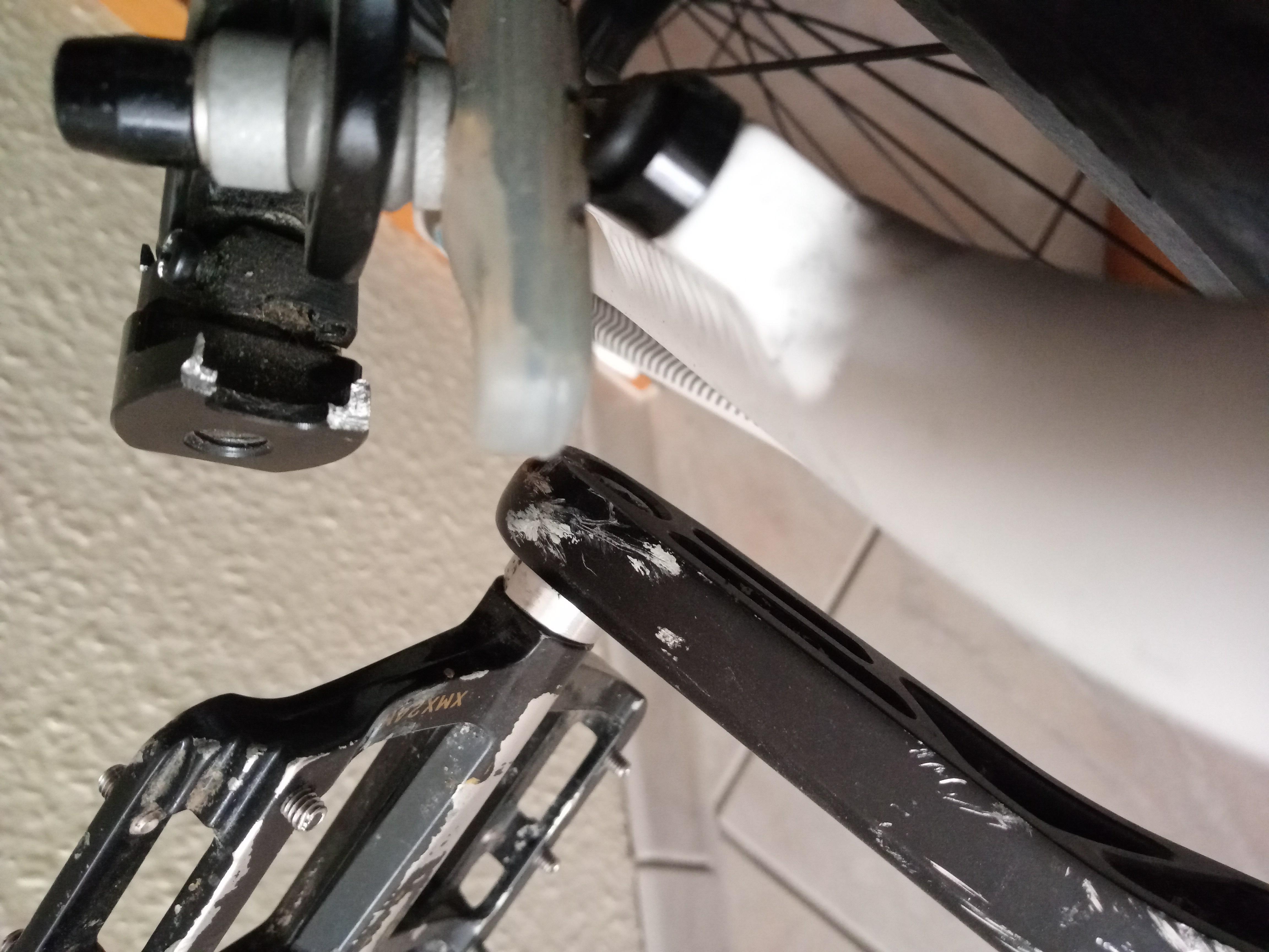

  21. And number three today... Have to go back to Maggies. Sad, I really like Vees, so easy to adjust, so easy to remove the wheel. I hope I will find some adapters soon.
  22. Second one died this week too. The two other ones I own have already a slight crack.
