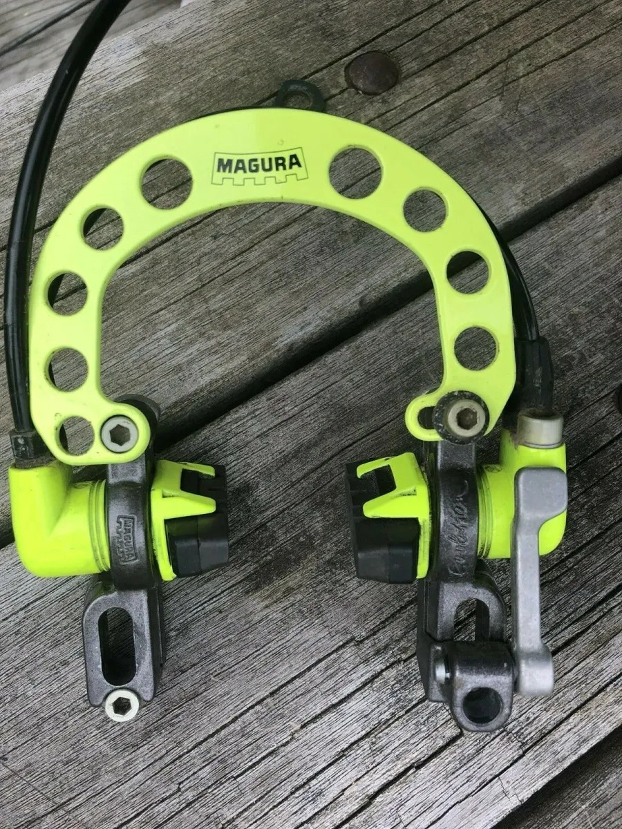

But if the callipers are even further, then you might have an issue with the cranks. So you will need a 128mm wide bottom bracket at least. Regarding the brake booster: the original one from magura does not fit most trial frame. That is the main reason why I prefer a V-brake setup on a frame with v-brake bosses: deore calliper, avid lever, shimano sp41 hose, jitsie pads or bmx pads from odyssey and you have an amazing combo.
The old Magura Evo mounting hardware was asymmetric, so that the offset of the callipers could be increased for wider rims. Here in the narrow rim configuration:

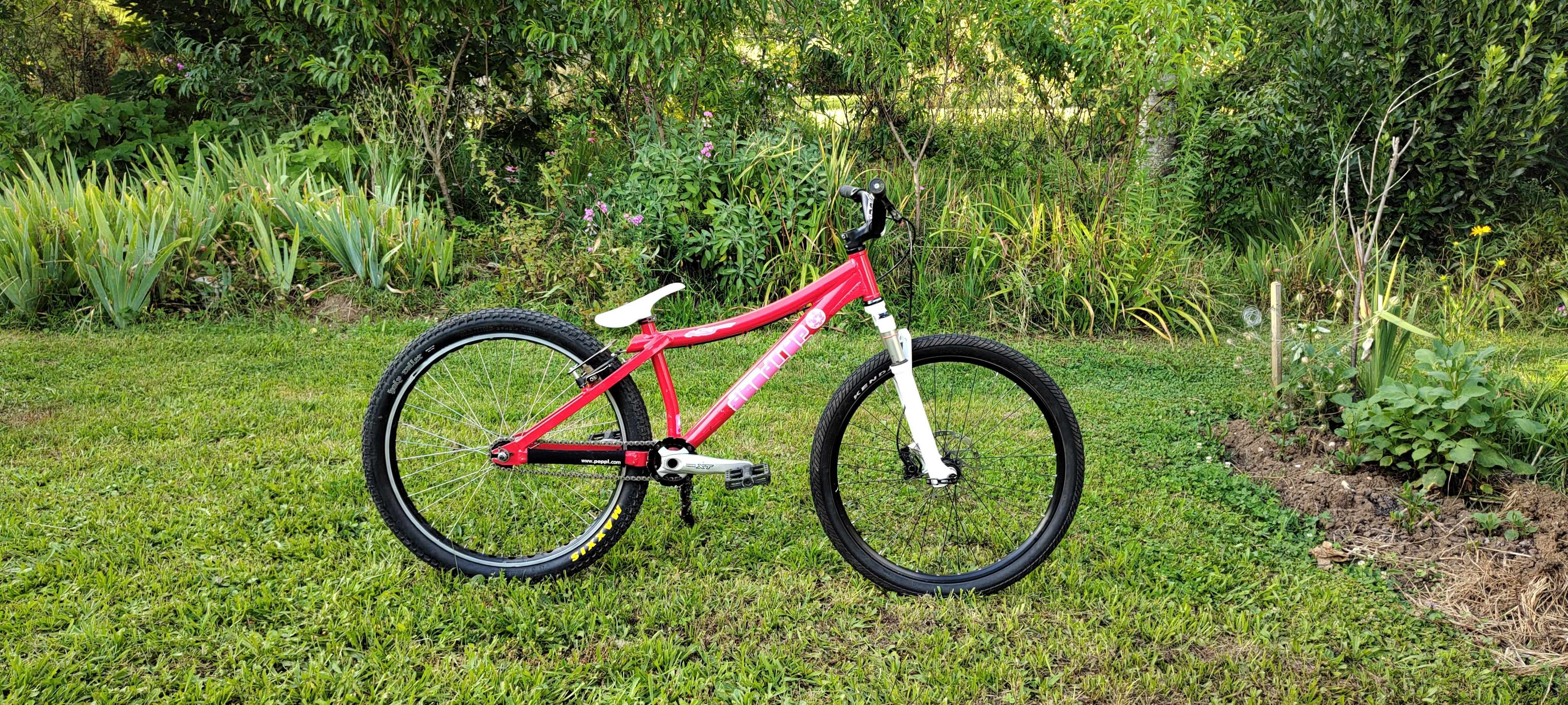

Hi, not much to say about this bike. I use this bike when I visit my parents, so it is a cheap build. It is a KST Acidrop from 2006 (almost 20 years old my gosh...π³). KST was one of the subbrands from Koxx. Bought it more than 10 years ago and swapped time to time parts. The original ones were crap but now it rides quite well. Good enough for the small skate park around.
