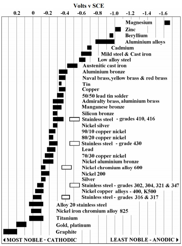

  20. I agree with you that the Magura fittings are particularly sensible to oxydation. I own also some and their are the only one that oxidize that much. But Magura is also not really good in their material choice, see the cheesy carbotecture levers. Some Shimano fittings are gold anodized, see Shimano Saint for example, some other fittings like Hope are stainless steel. I checked on my Magura Louise and the fitting is a mix of material, a part is steel the other one is aluminium (I used a magnet). So I suppose it is galvanic corrosion. The finish of the aluminum part is surely not good. I disagree regarding the terms. Corrosion does not mean the same as oxydation. As I wrote corrosion implies a degradation of the affected part. Not the case with oxydation, that could even be used to protect the part from degradation. Rust has a specific meaning, it applies only for iron. I am surprise you don't make the difference? My point was that Swoofty's bike is stored in Hamburg and that makes a huge difference. As I wrote, as soon as there is a little salt in the environment, you shall expect parts to rust/oxidize/corrode. The difference is amazing. I made once the experience myself as I went for a few days in Bordeaux. I was just in the town, far from the ocean (Bordeaux is already some km away from the coast). But the marin air was present and all of my screws (stems, bottom bracket, brakes, etc.) started to rust, while they never did before. So I wanted to emphasize that Swoofty's bike is exposed to an aggressive environment and as he wanted some tips, I wrote things I know. I guess he really has to consider galvanic corrosion too, since he is using a lot of the aluminium/ti combo. Saline environments also boost galvanic corrosion and failures or seized parts are not uncommon in the bike industry (see the Shimano Dura Ace cranks for example, or a lot of carbon frames with aluminum inserts or even all the seat posts that get stuck). It is nice to see though, that he already considered this. The only other hint from me regarding the fittings would be to swap them with anodized ones or to get some stainless steel fittings. Trickstuff seems to makes both for example (they are from Goodridge and have a good call).

  22. Hi, First, let me introduce the terms: - oxidation is just a change in aspect and has no impact on strength. - corrosion means the part strength is potentially affected. Now, we have to distinguish two phenomena: - oxidation / corrosion through air/cold temperature/moisture/salt exposition - galvanic corrosion due to different metal combined together The first one occurs more or less when some conditions are met in the environment. The other one may not be visible, it can occurs for example with seat tube and seat post. Important to know: 1. Temperature plays a role indirectly: the warmer the air, the wetter the air can be, so the more oxidation can occur. It is quite counter intuitive because we often use heat to dry things. 2. Oxidation depends on: - the humidity - salt concentration As soon as there is a little salt, the required amount of humidity is really low, maybe 30% for steel to oxide (sorry I don't know the precise values). But if the air is not salty at all, the humidity has to be quite high to start the oxidation (for steel, maybe 60%) - it is the same for other metals afaik. I.e. exposition to salty air or water is just a mess! And sweat or riding on salty roads in winter can be enough. Hamburg is quite a bad city in this respect (Baltic sea) In addition, mixing metal can lead to galvanic corrosion, which is also a big mess. Aluminium/titanium is really a bad combo. Metals that are further from each other have the highest rate of corrosion when combined Aluminium exposed to the environment can only oxide, because oxidation creates a thin protective layer. But galvanic corrosion can attack the whole aluminium part... To prevent oxidation/corrosion: - prevent mix of materials with different potential (see chart) - Lubricate to isolate (Teflon or copper based grease for parts in contact, sticky oil/wax for parts exposed to environment), regularly - paint or anodize surfaces to isolate - Wash the bike with tap water after riding and dry it, lubricate again - Store it in a dry location (at best cold, to prevent high humidity) - Prevent salty environment and try not to sweat 🙂
