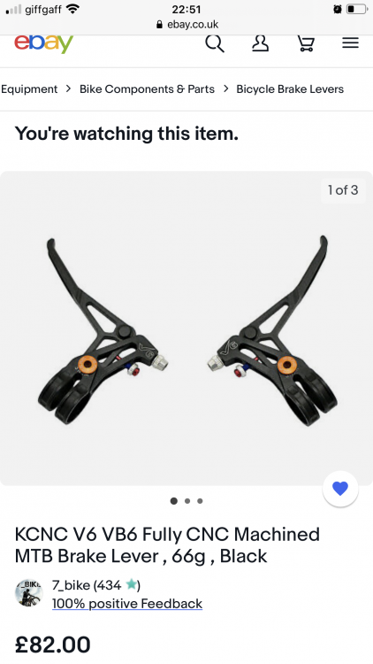

  13. Hi all, I’ve been out of touch with v-brakes for a long time. From memory, avid sd7 were pretty decent but I’m now looking at new cnc models and I came across BOX & KCNC to be at the top of the range. Obviously, avid ultimate and lykke are great for trials but are very rare to get hold of. My question is - has anybody tried any of the 2 options above and any feedback? Or can anybody recommend another brand? Ideally I’d like a split bar clamp design.. Also, would anyone like to split a set of KCNC levers as seen on eBay for £82? See screenshot in the comments, can’t paste the link for some reason I ride EU style (left lever front brake), so that will make for 2 front brakes.. Cheers, Nas

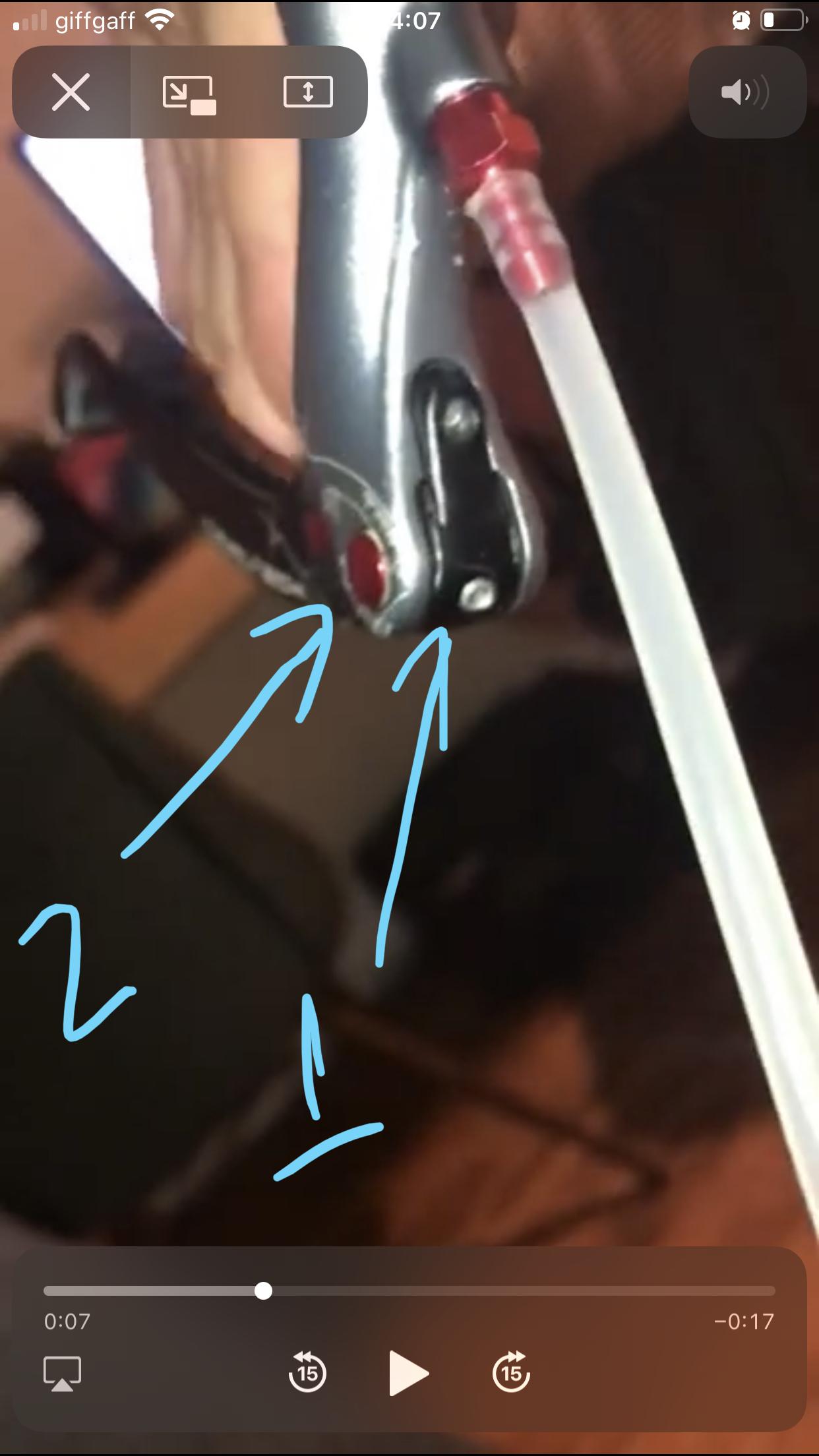

  19. Here mate: Loosen 1, then push 2 all the way down, then tighten 1 again, so it properly holds 2 in place. You can also pull out 2 to see if there are any indentations which might affect the grip.. It did help and minimised the wobble but there is still a tiny bit of play as you can see in the second clip. It’s nothing too frightening but compared to a hashtagg lever I have on my other bike which has absolutely zero play, it slightly annoys me still.
  20. Hey bud, thanks very much for the tip! It worked and minimised the wobble although there is still a tiny bit of play and the pivot bolt is moving as seen in the clip below: It’s definitely much better than what it was and won’t bother me to the extent of replacing the levers. Do you know if those plastic washers are available to buy anywhere? N
  21. I bought a pair of used trialtech carthy levers some time ago. They work well but I’ve noticed a bit of play in the blades with one being way too wobbly for my liking. I was wondering if this is to do with worn seals/bushings around the pivot bolts and wether these are available to buy anywhere; or is that a result of old damage where the lever body might have deformed a bit? Anybody had the same issues with trialtech levers and any fixes at all? Cheers, N
