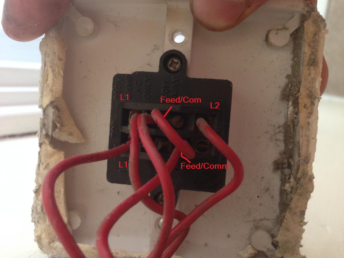

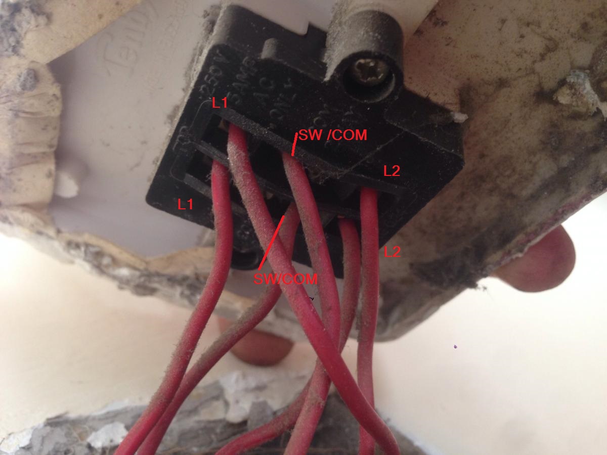

	In this case the feed is connected to one 2 way switch it then feeds a 1 way switch then goes to next switch point. The switch on the right has no feed at it both are presumably the switch wire end of 2 2way switches so each switch wire (com- the wire going to the light) could be fed from either of its strappers depending on the position of the switch or the other switch or an intermediate switch if there is one. nowadays most people would have neutrals at both switches and i don't know about other sparkies but I rarely wire a 2 way switch like that I usually use a three core with the feed and switch wire at the same end.
	I'm a sparky so should be able to help. Its hard to see which terminals the cables go into from the photo but it looks like you have a 2 way switch on the left hand side, and a one way on the right hand side (of the photo on the left) A two way switch in this case has a feed and 2 strappers, The feed is in the common term and the 2 strappers are in l1 and l2 at the same side. To swap the switch isolate it properly then disconnect the common first, move the common over to each of the commons on the new switch and put a link between the 2 commons as is done on the old switch. then move the 2 cables on the right side into l1 and l2 on one side of the new switch. finally move the move the last switch wire into the terminal l1 on the other switch. for the photo on the right, be very careful because it looks like 2 2 way switches which could be on seperate circuits so make sure it is isolated properly, (it may be easier to just open the main switch on the whole house.) This switch has switch wires in the common terminals so don't put a link between them. Again move the commons first then move the strappers over one side at a time. Please be careful. Right i've marked it up as it should be on your new switches
