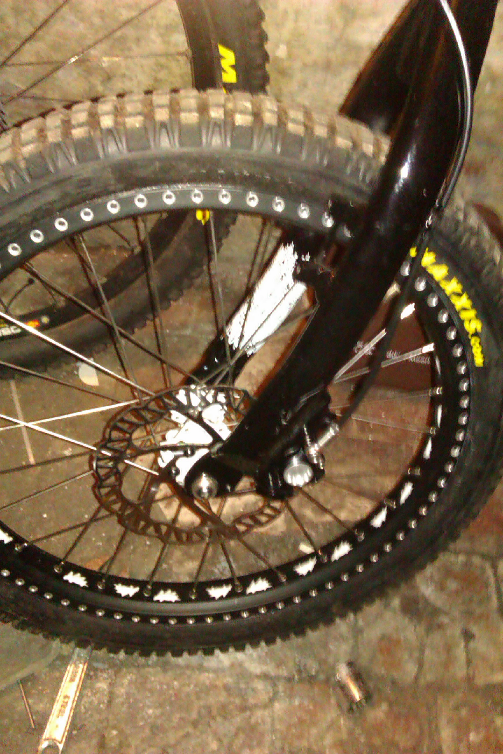

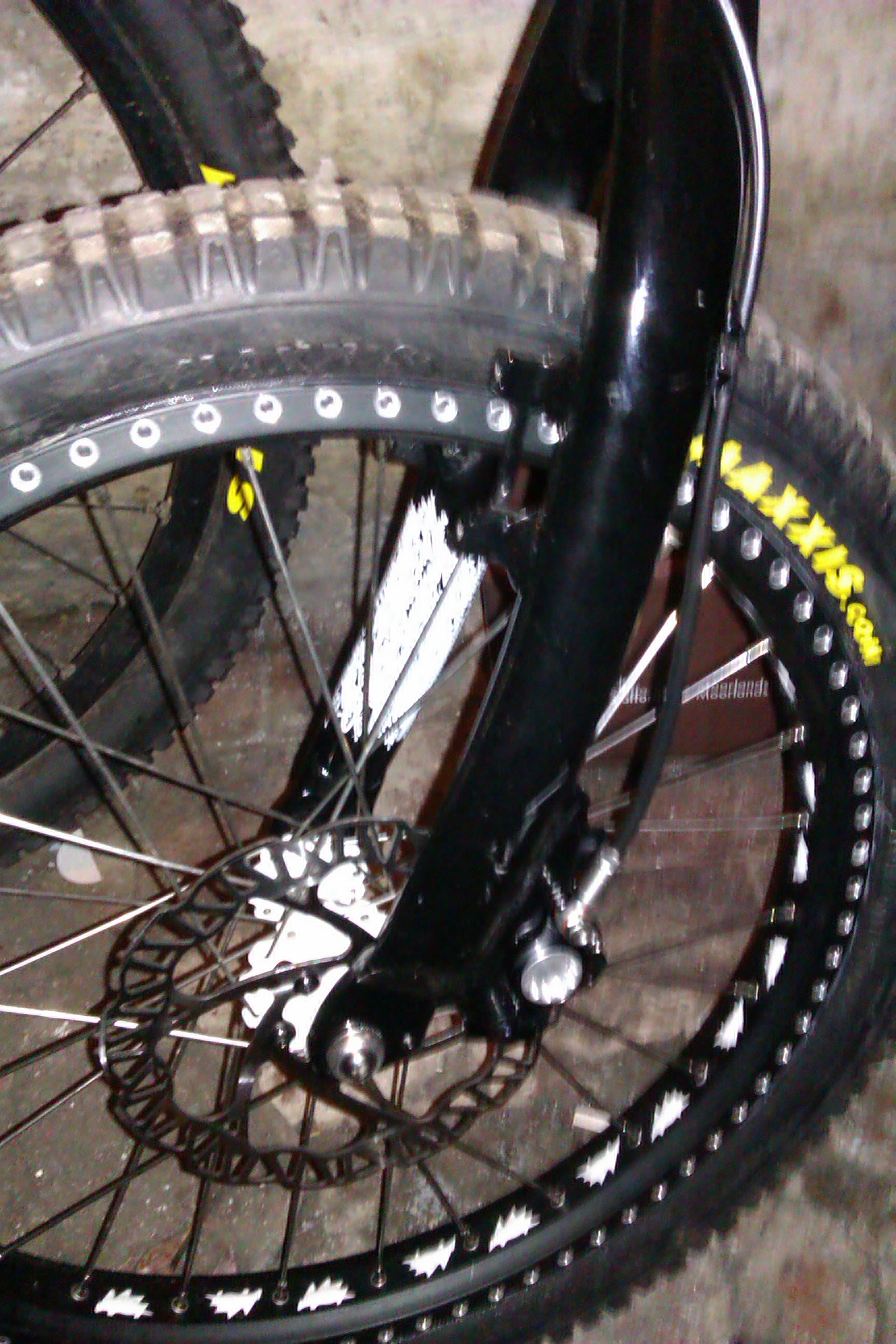

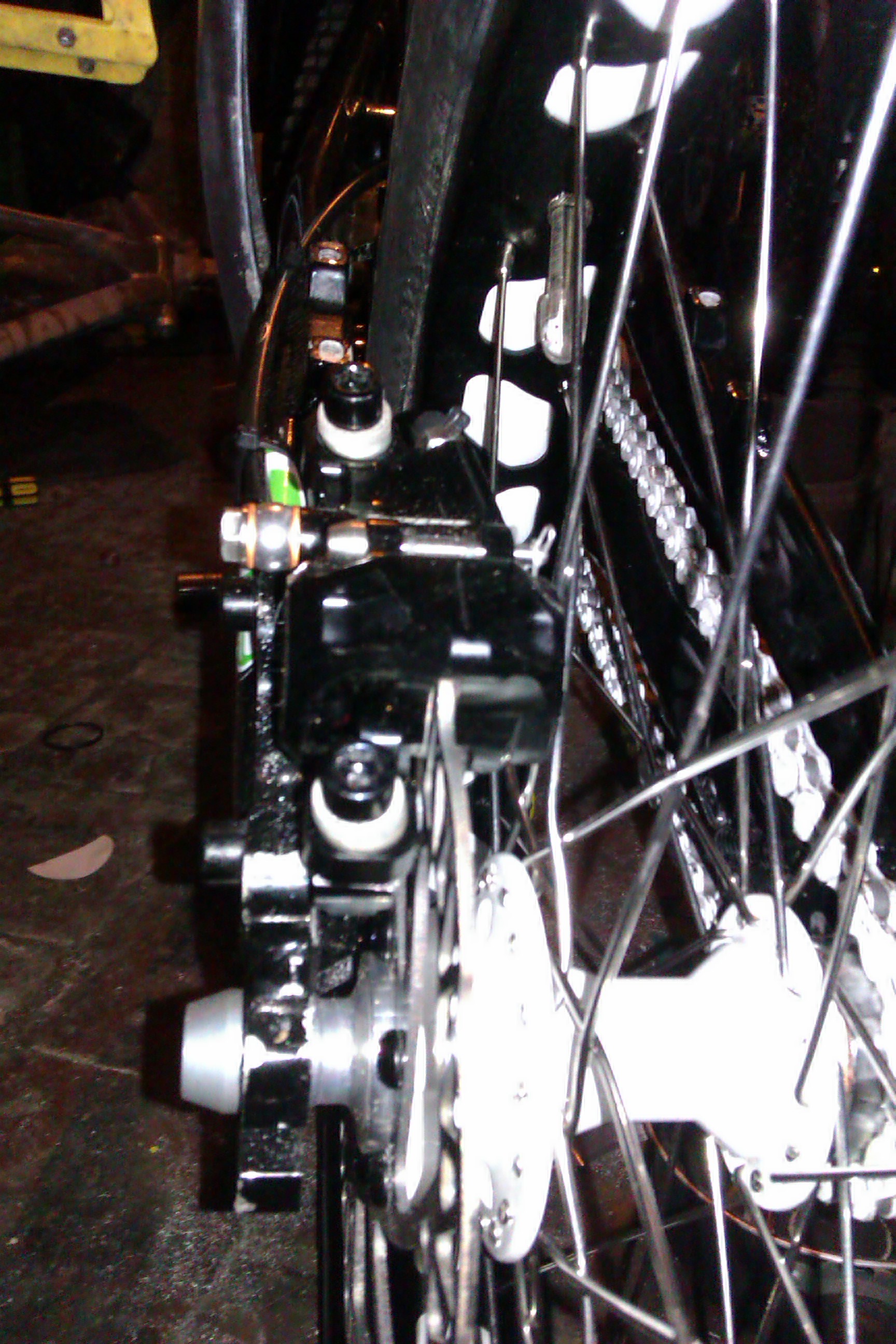

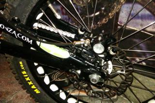

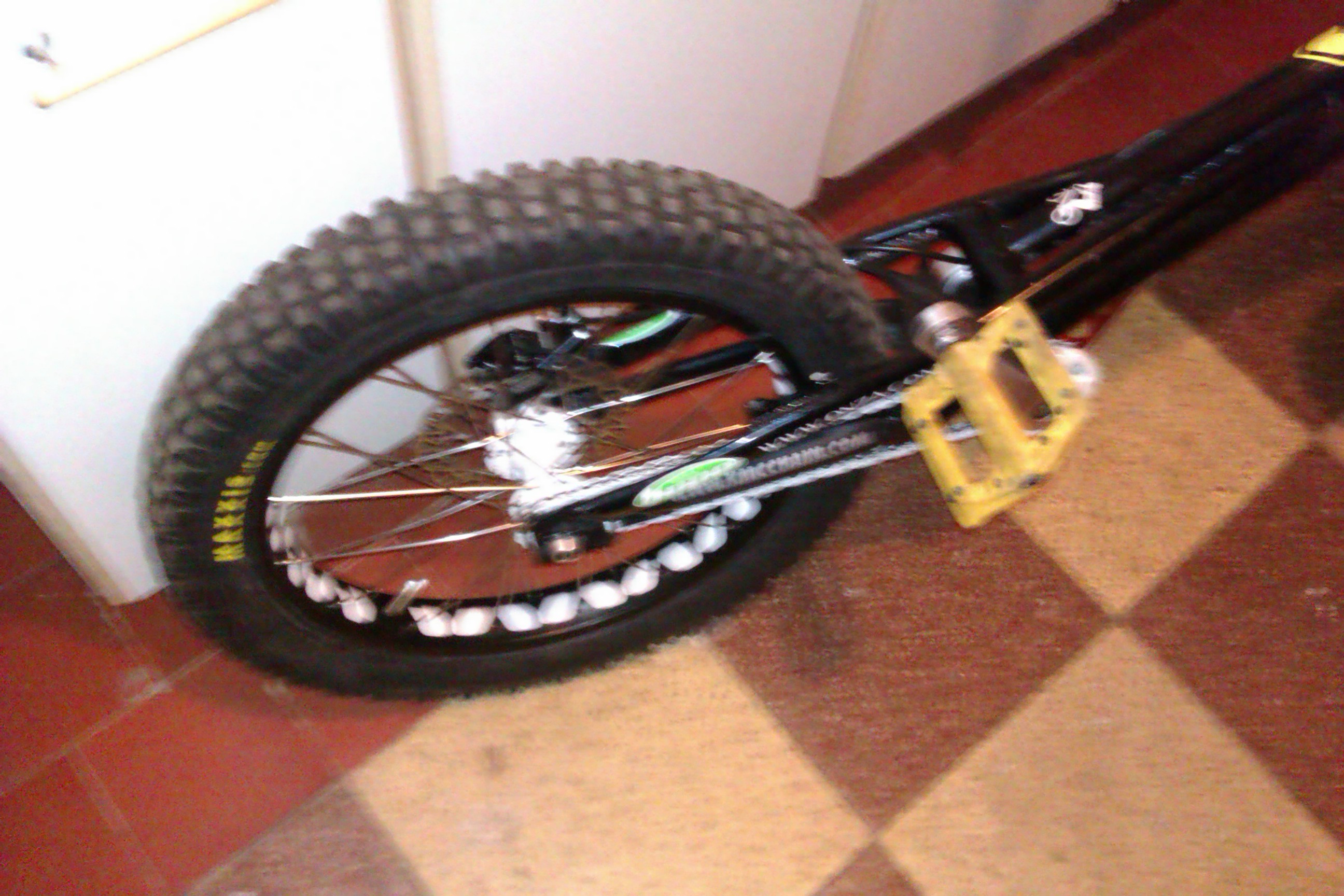

i have only fitted discs to two 20" trials bikes so far. and i have seen a set or 09 echo forks with mounts out of line. and also my onza master rear disc mounts were out of line luckily one of the sets of discs were avids so there were no problems just use the adjustable washers to line them up. as for my hope trial zone brakes, i have filed the is to post mount adaptor to line the brake up, put longer bolts on and fit avid washers to the back of the bolt to line it up. i will get u a picture, it shows its a hell of a lot out of line. really quite dissapointing as i havent seen one this bad on both the onza and echo. in ten years as a bike mechanic.

i have fitted the hope trial zone to my mod bike last week. there awsome so far, and silly light weight. i will see how they work on natural stuff soon. i will be at bracken rocks competing march 18th if anyone wants to have a go on my brakes you can feel free to. the post mount is brilliant i have got mine to work well with no rubbing at all, my wheels spin freely. and the brakes feel great on the 160mm rotors too.
