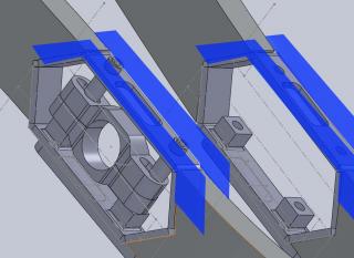

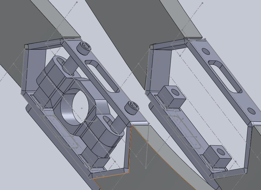

Edit: Bit confused about the magura mounts. Will the cross over run through the frame? And how can you do up the clamps? Surely drilling holes for an alenkey/ bolt would weaken the thin top piece too much?

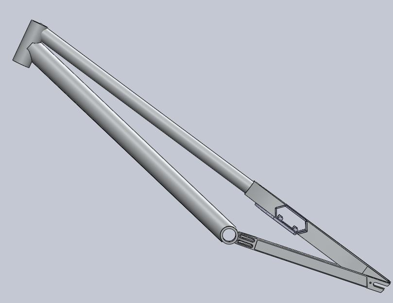

I would seriously question the strength of this. You're going to be Putting a lot of force through the welds. Unless you weigh less than a 10 year old, it just won't hold.

Dude, come on....there's a picture just below it with a toptube :P
I'm putting in a seat-tube as well...just not so sure how i want it to go. Maybe coustellier style, or possibly a la rockman slate.

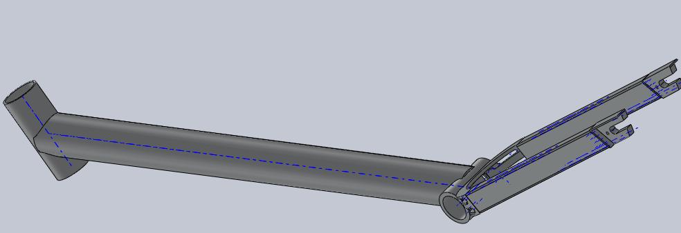

I think this picture is to show just the down tube, chainstays, bb yolk and head tube together. I presume the finished frame would be the one above this picture including the top tube and seat stays.

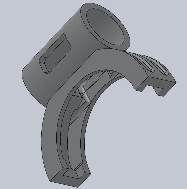

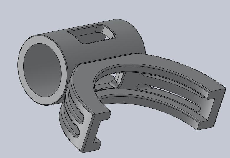

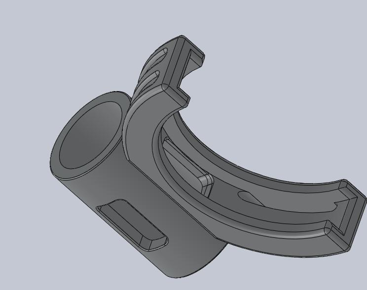

With regards the BB yoke: SHARP EDGES!! Get that shizzle smoothed out or you'll just end up with stress raisers and headaches. Also I hope you have access to a 5 axis CNC machine?! Other question is also with the brake mount. Are the threaded holes through or blind? If they're blind I can see you having trouble tapping them through the allen key access hole in the top. You've probably considered that but just in case ;). Overall looks good though!
Edit: The 'SHARP EDGES' also stands for the dropouts and possibly the seatstay section too. Just whack some rads on there and you'll be laughing.
Edit 2: There's a lot going on in there. Lots of corners and edges that just end abruptly at the lightening holes. If possible I'd try and smooth things off and make it 'flow' better in the design sense...

Yoke!
Touche, Just googled it and you;re right :)
Ah, I hadnt actually noticed how sharp it was :S I'll get right on that cpt. ;)

It's coming together very nicely. The brake mounts look very weak though. I reckon unless there's a lot more reinforcement that's not obvious in place when the brake clamps are fitted, the mounts will probably buckle on heavy landings. Putting the brake pistons through the tube is a nice design detail, but it adds a lot of stress risers to the frame. The seatstays will stay mostly in compression, so they're less prone to fatigue than chainstays (Fatigue needs a tensile stress), but with all the cross section changes there will be local tensile stress all over the place now.
Definitely smooth out all the corners too - the edge where the BB shell and the chainstays join definitely needs a big fillet. Internal corners will be a lot harder to smooth after manufacture, so they're the priority, external corners can be dealt with by manually rounding the edges afterwards if there are manufacturing issues that make putting them in initially difficult.

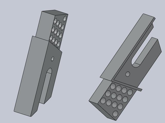

Dude where the yoke bit meets the bb shell on the LHS there (and obv the right) it will be impossible to machine this like that in one piece need radius there too.
Yeee, i was planning on welding the two together, lathing the bb shell in one go, milling the slots then later milling the yoke separately.
Well, the idea is to have seat stays that directly reinforce the magura mounting area. Ill bang up some more cad pictures in a moment to illustrate :)

EDIT: I reckon the gap between the plates that the magura clamps fit into could be decreased? hmmm...any ideas folks?

why dont you machine the mounts out of billet and have the clamps contained within. rather than that terribly flexy looking set up?
Edit:sorry missed the bit about making them thickerer.
New filleted BB yolk :)
Is that 2 piece welded?
Thinking about it again, seeing as the seat stays are mainly under compression why don't you just make them clamp the clamps if you get me.
A cut out in the machined bit allowing the clamps to move longitudinally with a very small clearance and then the bolts just go through that bit and thread in the other dise, rather than the spacers and crap mess around.

You'll need lots more fillet at the sides where the chainstays curve inwards towards the BB shell and at the bottom of the BB shell. Cracks will grow very quickly off those areas as their high tensile stress and already quite acute angles.
The brake mounts really don't look very strong at all. Fitting and adjusting the brakes to them will be a real pain since there's no way to loosen the brake mounts off properly without straining the frame. The V shaped slots in the chainstays look like a significant fatigue cracking risk too. If you're to get away with a setup like this try using C-Section bars for the top and bottom of the brake mounts to increase their bending stiffness so the chance of buckling or bending from braking force is reduced and use a rounded or flat cut on the seatstay where the brake mounts are fitted rather than the V cut.
As in on the chainstays themselves? or the bb shell?
Point taken....

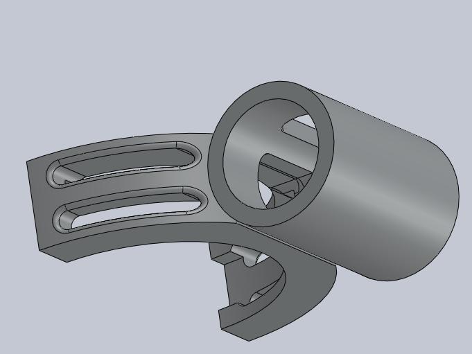

Where are the V shaped slots ?
We talking U profile here?
V shaped cuts:
The comments relate to the area where, in the BB yoke, the BB shell joins what is the yoke for the chainstays. If it were one piece it would be impossible to machine due to the acute internal angle and even if it were welded (if that were possible) it would still be an area of very high stress and likely spot for crack initiation.
I would be inclined to put a couple of spines/plates on the outsides of the flat section of the upper maggie mount (the booster could be extended on the lower to do the same job) to resist buckling; you could also extend them further up the chainstays to increase stiffness and allow more weld area.
Something like my bad photoshop :giggle:

Alex i have an idea for the brake mounts. Forget the idea of thin seat stays. Instead produce the stays like a normal frame, but machene the bottom part of the brake mount into the top of the stay. That way when the top part of the mount is bolted in, it will be an integral part of the frame. However to do this you need to have a weighty solid seat stay. Of which ihave no solution <_<
anyway, i doubt it would work, just throwing up ideas.
V shaped cuts:
Ah, I see what you mean. Those two pieces of plate will be welded together before being welded into the frame.
