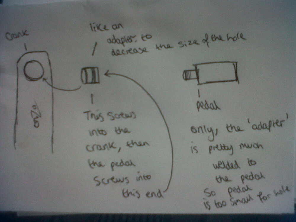

I am in the middle of replacing my pedals on my t-pro. However I've come across a little problem :(
Today I brought my crank and pedal to school as the pedal wouldn't loosen from the crank so it had to be removed as I couldn't for the life of me do it at home without a secured vice.

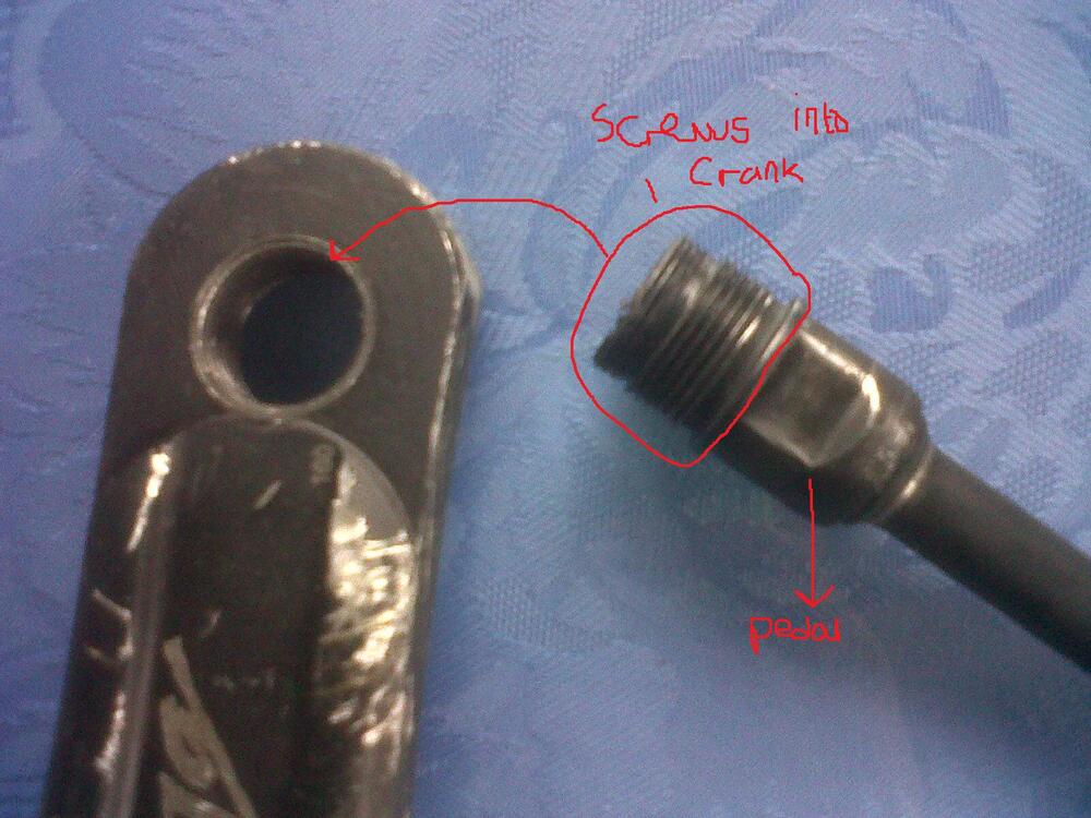

We managed to remove it however the only way it would come off would be that the pedal which screws inside another screw like thread which in turn screws into the thread in the pedal.
Now as this seperate piece of metal was pretty much welded shut to the pedal it couldn't budge and as mentioned, would only come with the pedal.

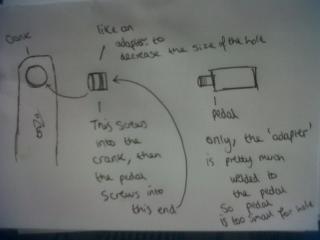

So now the thread in the crank is wayyy too big for my new (ish) pedal to go into due to this stray piece of metal being removed with the pedal. Pics kinda explain what I mean. Now what do I do? Look for this thread adapter piece which I can't find anywhere as I have no idea what it's called!?

ohh you mean the pedal threads have come off and gotten stuck in the the crank?
if so get some plyers or similar, slide them in the crank hole, open them out so they are firmly gripping the inside of the threads stuck in and eventually twist them out. depending on how stuck in they are.
Yeah, that sounds about right, only, nothing has come off (apart from pedal itself as I removed that for ease to work with)
I'm not sure if I'm explaining properly what I mean. I'll draw what I mean and take a pic. Cheers guys :)

Ok. Let me see whether I've got this right then we can all start afresh and sort your problem :)
You've taken the old pedal off, and the insert is still attached to the old pedal. This means the new pedal won't screw into the crank because there's no insert there for it to thread into. Right?
That being the case, you either need a new insert or some new cranks. Or, as was mentioned, get Tarty to do their helicoiling unless your tech geezer can do it for you.
Absolutely spot on :)
I'll look into helicoiling and see if school have the right equipment for the job :)

DO NOT helicoil. there is just no need.
EDIT: PLAN B : we use this method at college.
STEP 1. Find a nut that will thread on to the insert. (it'll be a common size, might take a bit of lateral thinking)
STEP 2. Place said nut into a vice and tighten
STEP 3. hacksaw into the flat that currently faces upwards
STEP 4. thread pedal + insert into nut (which BTW protects the pedal threads perfectly)
STEP 5. Tight vice good & proper BUT DONT MONSTER IT.
STEP 6. undo pedal normally
Now undo the vice and retrieve the insert and put it ur new pedal axle with a good smothering of grease (dito the outside of the insert
& wind the pedal in normally
SORTED
Hope this helps

Thanks for this. But I think I might just get some new cranks as today I've been told by the bike shop guy that it's not going to come out.
