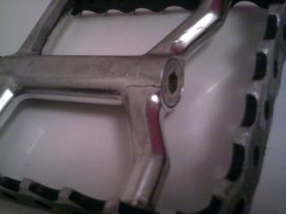

After having a ride in reading yesterday on the train home i was just loking over my bike and noticed i had a crack in my echo tr pedals and just wanted to know if this is a common fault ?? i really like the feel of these pedals and wouldnt mind another pair. so if this is a common fault ill just use my wellgo mag pedals instead .....

So that's a 6 month warranty in the same way that Koxx, Rockman, Inspired, Ashton/Diamondback, Monty, and every other frame manufacture have to provide a 6 month warranty by law? It's a materials or manufacturing defect warranty which doesn't cover items being hit into objects, abuse, mis-use, etc. If it's an actual manufacturing defect or a fault within the material used to make a frame it'll be come apparent relatively quickly hence it 'only' being a 6 month warranty. Everything else isn't technically covered by warranty, so it could be a complete lifetime warranty against that sort of thing and it still wouldn't change anything at all (it'd just mean that more people would complain that their absolutely battered frames are a 'manufacturing defect' further down the line instead of that being restricted to the first 6 months). Frames are 99% of the time going to crack on a weld too. I'd be more concerned if your friend's frames had cracked in the middle of a tube...
The 'problem' is that everyone wants lightweight stuff. People want caged pedals that are superlight. Weight's got to be saved from somewhere, with the easiest place being from the body itself. Try-All have tried solving that issue by putting the ribs on their new 2011 pedals, so hopefully others will try that soon. The latest TR pedals are a little different to last years model too, incidentally.
If you're hitting your pedals a lot, either get some platform pedals or don't get light caged pedals. Pretty much all there is to it. This definitely isn't the first set of TR caged pedals I've seen break there, but almost everyone single pair I've seen that have broken there have generally had pretty battered cages. Battered cages = pedals being hit a lot = saving weight there not being a great idea.

These are lightweight products, people who buy them and expect durability should get something else. The same applies to Echo pedals with Ti axles.
It's pretty much the same as getting a Koxx, riding the hell out of it and then complaining it's cracked.
