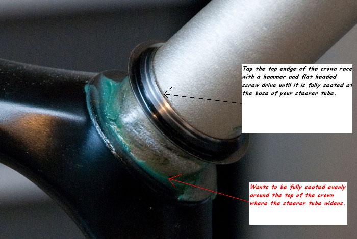

Another vote for hammer and wood.
The crown race sits on the top of your forks crown.
It gives the lower set of bearings a smooth surface to run on, enabling your headset to last, keep your bars turning smoothly and keeping everything from wobbling around.
I tend to just use a flat headed screw driver and hammer and gently tap the race all around till its fully seated at the base of your forks steerer tube thumbsupanim.gif
post-26276-0-48036300-1320865618_thumb.j
Edited by Echo Lite 09
As mentioned, a hammer and a block of hardwood will do the job.
Make sure that the cups go in evenly, tapping the block around each side to make sure you dont flare your frames headtube.
Ive found it helps to give the inside of the headtube a bit of grease as well as the area on the cups that will sit inside your frame.
Just helps it along a little and will prevent problems removing it.
