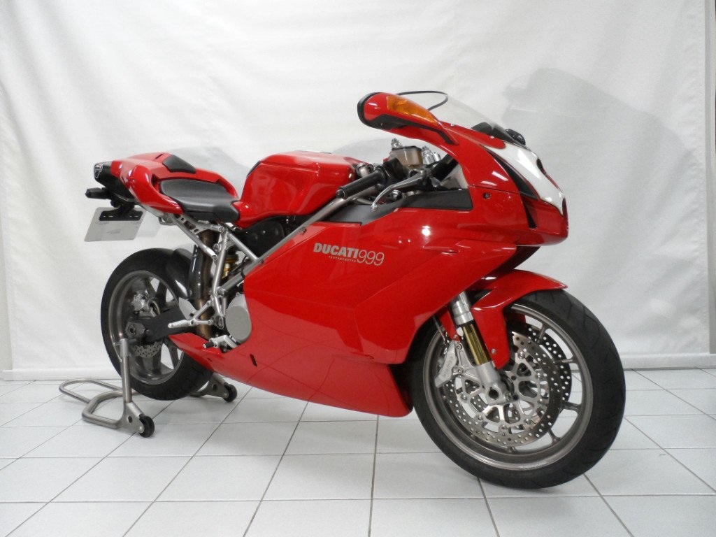

So the old man is getting a new toy, after getting bored with his triumph street triple 675, I did tell him at the time he'd be bored of it inside of a year, having come from a gsxr750 k7, to this. He says he can't make it do what he wants it to. So step forward this thing of beauty
post-29242-0-44438200-1368826318_thumb.j
Should be a marked improvement. I went to look at it with him on Saturday, and within 20 mins he bought it. It is bloody immaculate, not a mark on it. Its getting the belts done before he picks it up. Proper tackle now
