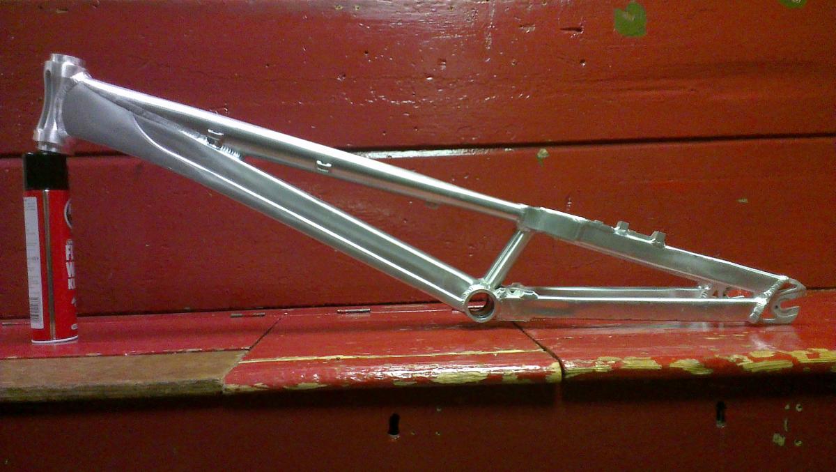

I just can't help myself, owning one bike just isn't enough so I'm building up a bargain ride.

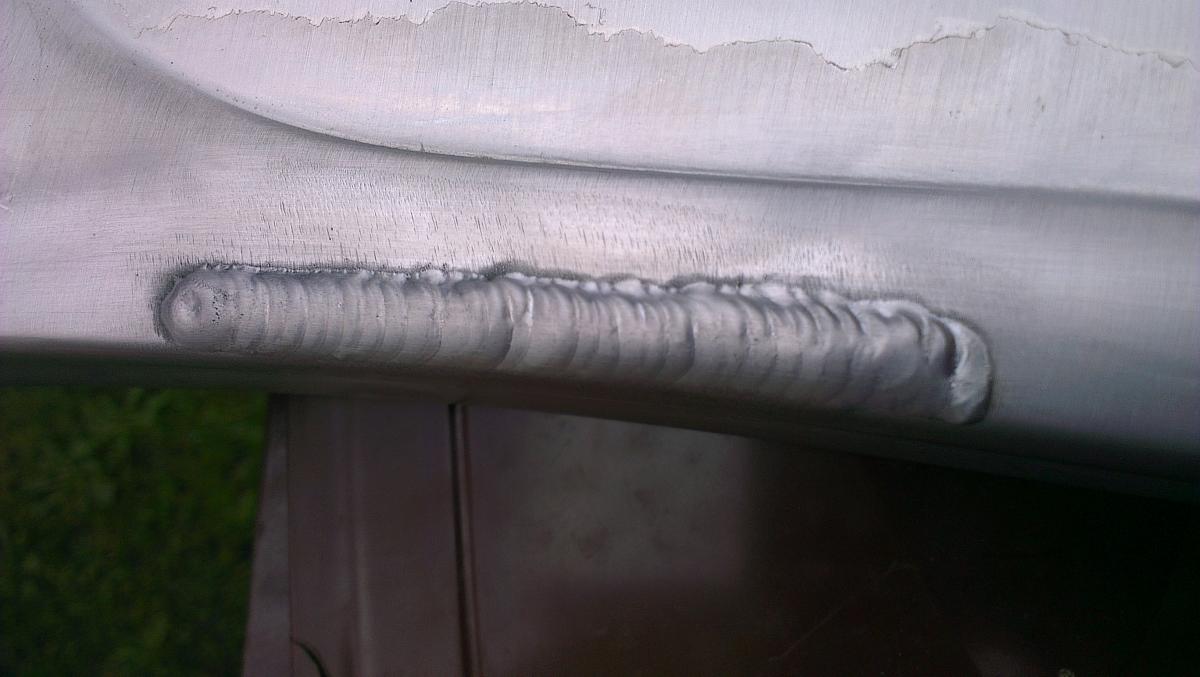

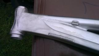

Picked up a super cheap cracked frame the other day which is something I've wanted for a while. It's definitely not to everyones taste though the price brand new put a lot of people off.
My stripped and repaired Speedrace Solo frame, not sure if I'll leave it silver or rattle can it yet but this is my starting point. Planning to get this up and running for under £200 including the cost of the frame, wish me luck!

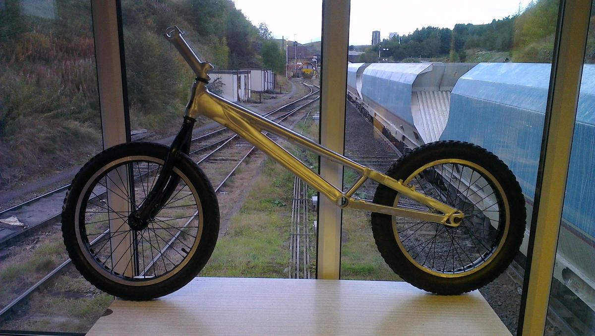

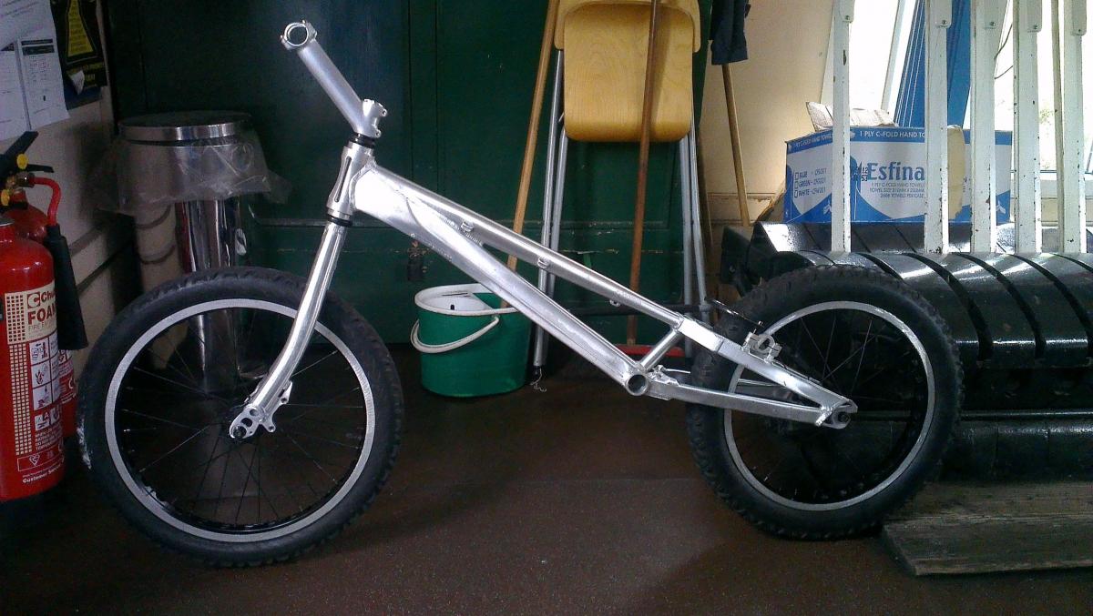

Update, been picking up parts here and there so I have a new picture. The wheels (which I built myself ^_^) are Onza sealed disc hubs with an Echo Urban front rim and Zhi rear both with some Stikys (though the front is bald!), headset is a First Blog Z and stem is a forged Onza jobby.
The forks are gonna be replaced by some silver Echo SL's as due to a major miscalculation by me (forgot about the headset) the steerer is miles too short.

In no rush though as it needs to sit for a month or so for the weld to reharden.

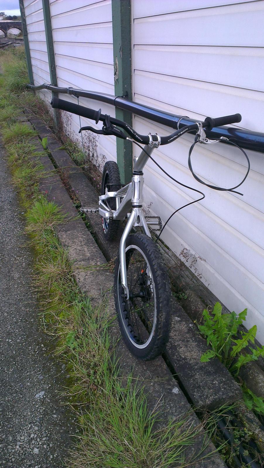

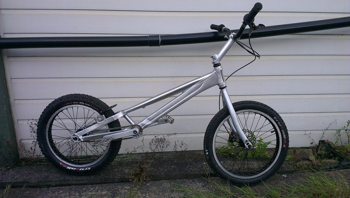

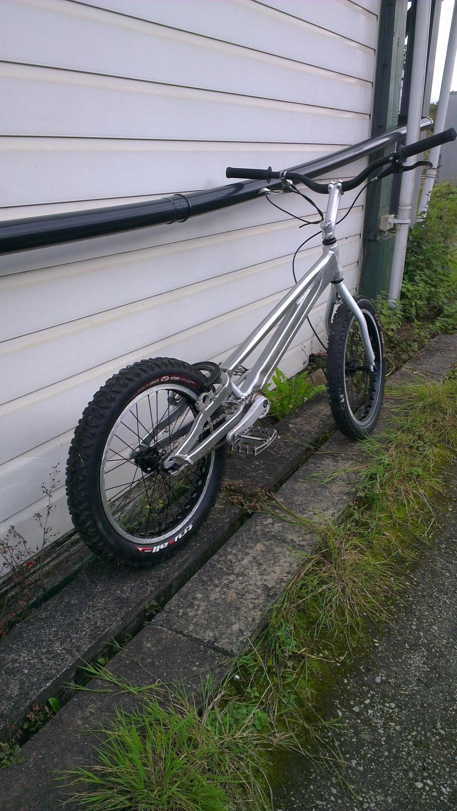

Few more bits on and it's almost finished.
Stole the BB from my Inspired (cheap Onza one) which is almost knackered but will do the job for now and borrowed the Echo platforms, Trialtech high rise bars and my front brake though I'm currently using it with the original Echo rotor. Didn't fancy using my 180 hope disc with the SL's so I may get a 160 to replace it with at some point but it's not desperate. Just need to sort the rear brake out and I'll be away!

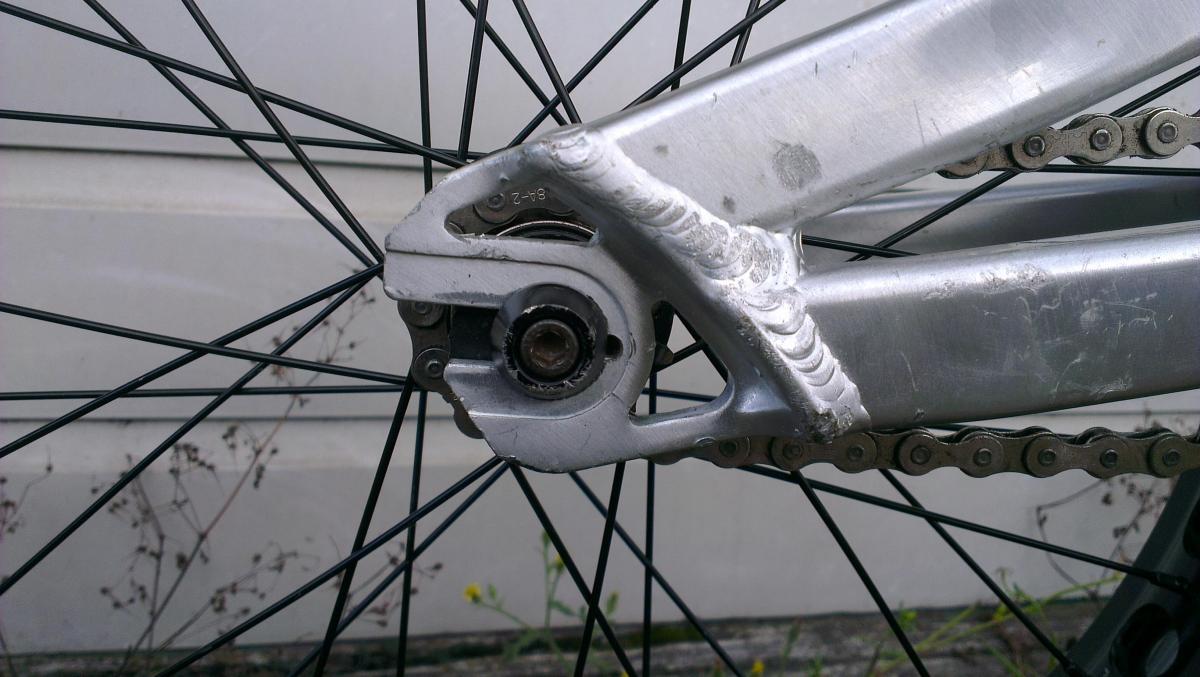

Due to the joyous quality of Chinese frames the snailcam adjuster is a no-no, rather bad magura mount locations (which I had read about) meant I had to rob the pre stretched chain off my 4play and fit the rear wheel without snailcams to get it forward enough in the dropouts.

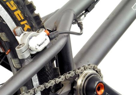

Just awaiting the arrival of a barbed fitting then I can get the rear brake made up and fitted. One thing I particularly like about this frame is the location of a hose clip under the top tube so with the use of my Trialtech hose splitter, standard maggie clamps and Trialtech Sport pads (which I need to buy) my rear brake will be something along the lines of this as seen on Stan Shaws SL.
