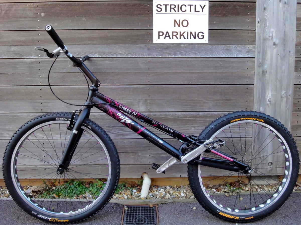

Been wanting to change to 26" for a while now after riding 24" for nearly 2 years. Once the comp season finished I decided to make the move to big wheels :)
My old Echo 24" http://www.trials-forum.co.uk/trials-bike/177-echo-trial-24/
Onza Limey 4:
Frame and Forks
- Frame: Onza Limey 4
- Forks: Echo Urban 2013
Wheels
- Front hub: Onza 2012
- Rear hub: Onza 2012
- Front rim: Onza pro diamond
- Rear rim: Onza pro diamond
- Rim tape: TrialTech f+r
- Spokes: Black with 16mm purple alloy nipples, rear wheel is tie and soldered
- Inner tubes: Maxxis ultralight
- Front tyre: Continental x-king rs
- Rear tyre: Continental Der Kaiser black chilli (cut down sides)
Brakes
- Front brake: Shimano XTR lever, Odyssey liner race, Avid Ultimate, TNN LGV pads
- Rear brake: Magura HS33 2005 lever, 4 finger, modified, Trial Tech hose splitter
- Rear brake clamps / booster: Echo TR modified, Tnn booster
- Rear brake pads: Tnn ADM blacks
Drivetrain
- Cranks: Try-All 175mm
- Freewheel: Echo Ti 108, 18t
- Chain: KMC Z610 HX, 3/32"
- Rear Sprocket: Echo Ti 15T Screw On
- Pedals: Echo caged
- Bottom bracket: Reset Titanium
- Bashring: Trial Tech Ti half ring
Steering
- Headset: Intergrated
- Stem: Try-All K2 (logo's removed)
- Grips: TrialTech thin
- Handlebars: Try-All Carbon
Extra
-Titanium bolts in load bearing area's and alloy in non load bearing
-Carbon downtube protector cut down
-Weight: 8.7kg

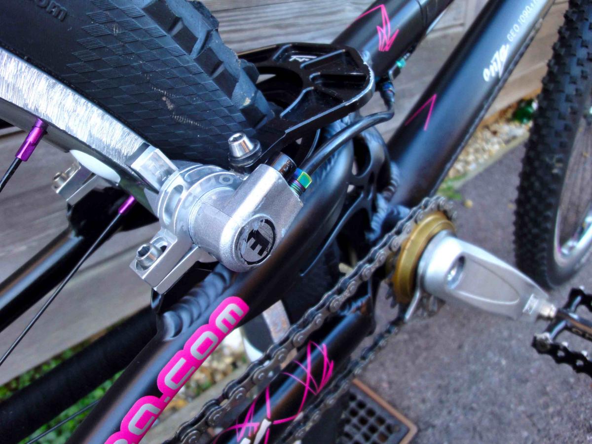

Would you recommend the hose splitter to be a worthwhile mod for a rear mag? - Currently thinking about it, will probably do it but interested in feedback!
I've been using a hose splitter for years now, always used the Monty one before the TrialTech one came out. There pretty good yeah, just a little added extra really though.

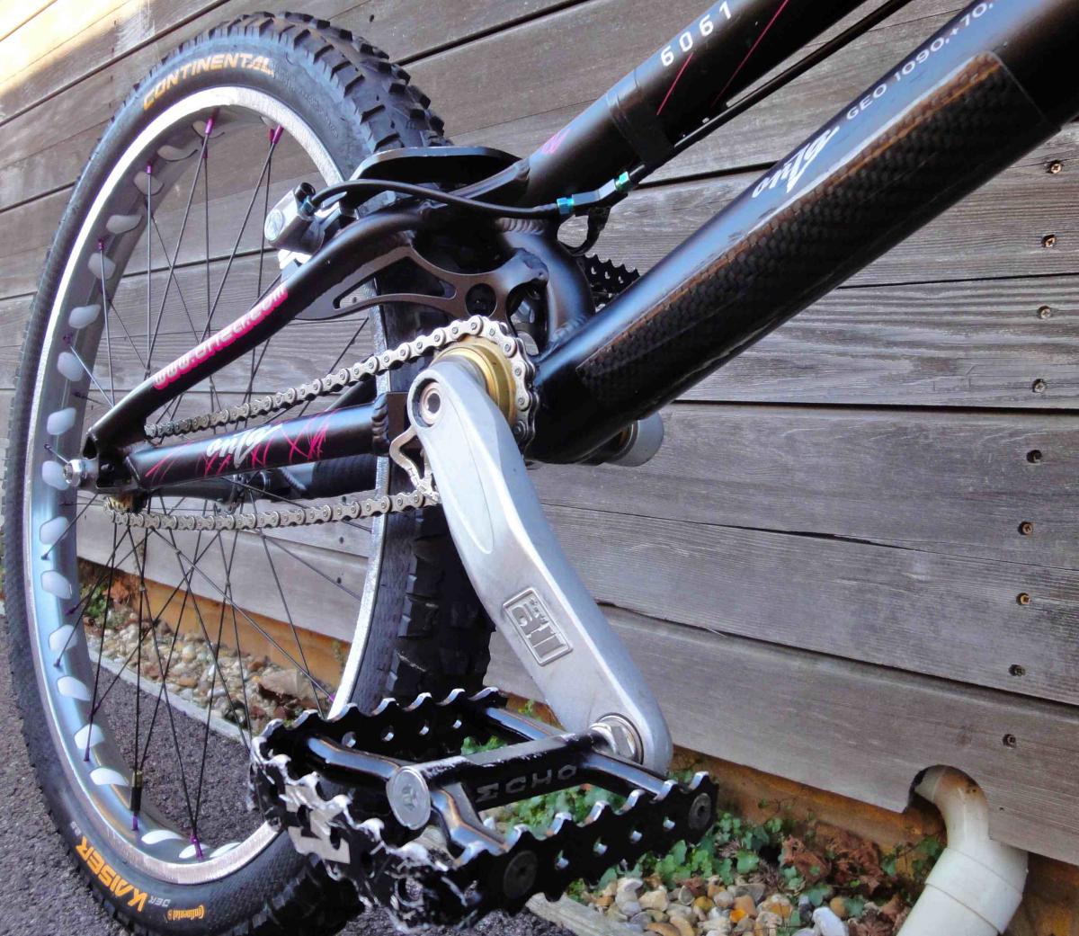

Only thing that puts me of is the integrated head tube which means i would have to ditch my king headset :
Have run plenty of King headsets over the years on all sorts of bikes. To be honest there no better in terms of durability on a trials bike than an Echo headset etc, on a mtb then maybe due to the quality of the sealing etc but on a trials bike there just overkill. + with the integrated headtube I can get a lower stack hight wich I like :)
