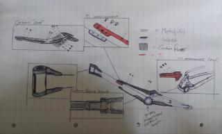

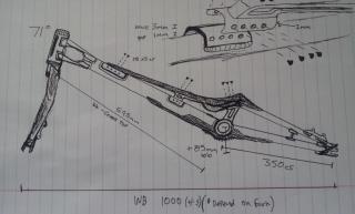

This is the idea I had, sort of mixing the M5 monty with a more traditional design.
(Use wih rockman carbon fork)
Concept 1;
post-35290-0-61480200-1372181179_thumb.j
Sketch 2;
post-35290-0-27352100-1372181271_thumb.j

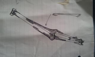

Detail / Exploded view;
post-35290-0-06445700-1372181347_thumb.j
This would be a hassle but I really like the look of it. I bet I'd have to get a seperate company to do the carbon bits and some place to make a Ti "interconnect".
Now I await the "that wont work" lol.
Thanks for looking.
Looks a bit like an adamant a3 mod frame to me, but with carbon bits.
I reckon that top tube is way too low down on the downtube, looks like you're going for looks rather than a geo you want as you don't appear to have written a geo anywhere? The first thing people tend to do when getting a custom frame is sort the geo out, then focus on looks.
I don't think it'll have much strength at all.
Edited by JMCD
Yeah the idea was looks, I know nothing about geo. Probably around 995 - 1000 wb

So move the top tube slightly higher, could curve I suppose.
Ill draw some more :)
Cheers

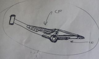

The idea is to remove the top tube and have a single down tube, but brace with other materials, so I had the idea of a removable top brace/seat/piece of carbon on a bike. But its also the top tube, buy now im thinking it shouldn't be removable and should be wrapped in carbon and be furthur up, have 2 brace pints on top instead of one... its a sketch, that were discussing the cost/possibilities of actually making it (not that im making it or having it made).
But if I made a frame, thats how id want it to look... hope that clears things up ;)
Cheers

Well if u look on the very first picture the brace is made from ti, but from comments I recieved I was unsure what would be better, the carbon was just for a seat, and too look nice.
The carbon "undertray" I thought would solve the problem of the bash guard mount going through the frame (as there is no mount as its adhered to the frame)
And I made the brace removable as I didnt know if Ti could be welded to ally, and assumed not.
