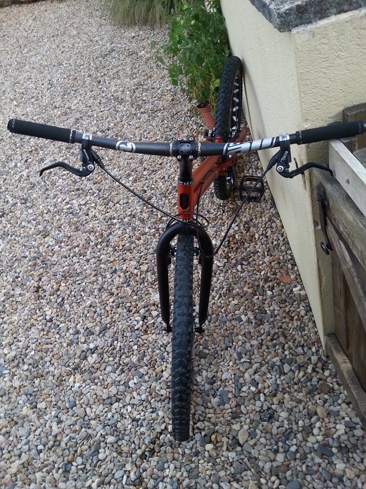

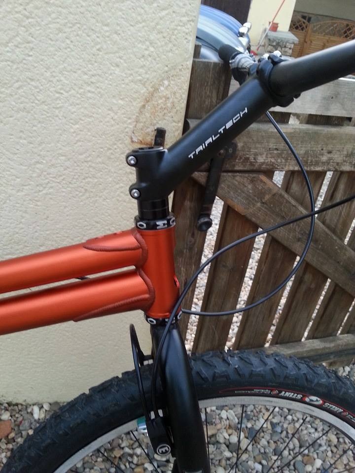

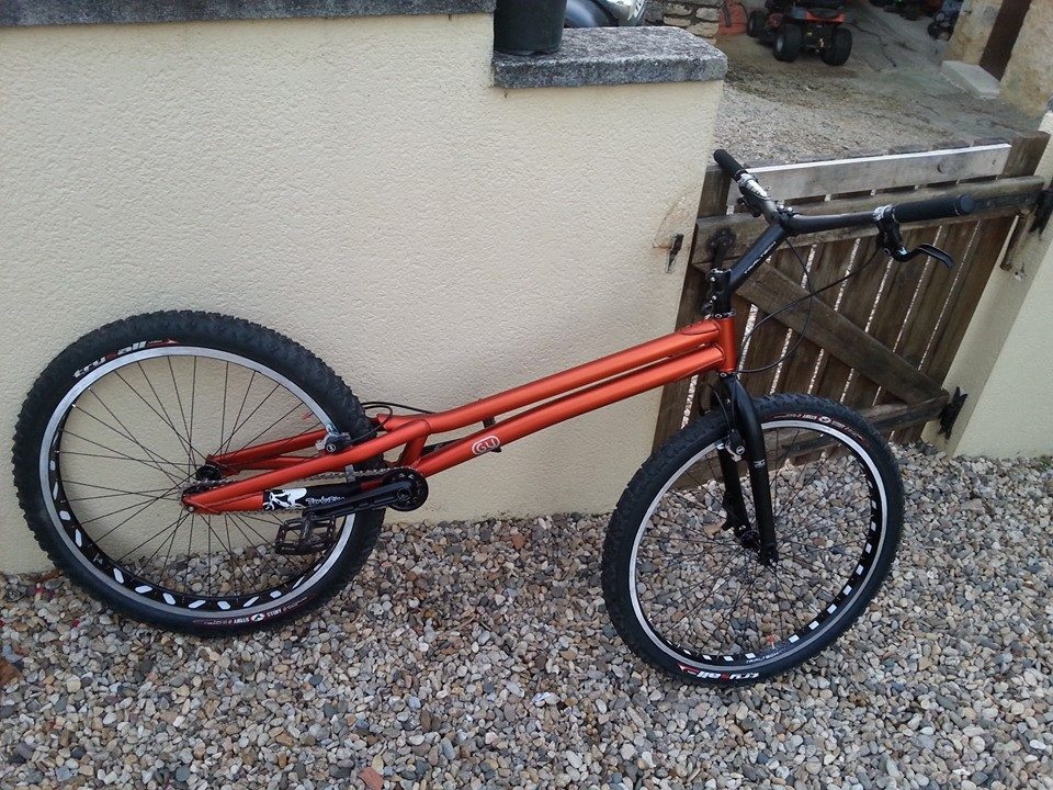

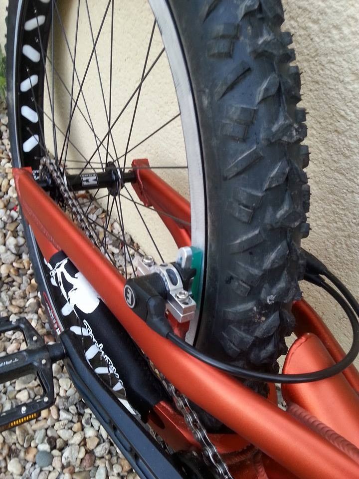

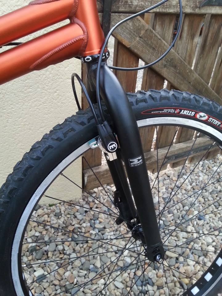

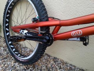

So the bike I ordered from Tarty came yesterday, after building it up fully and getting everything just about ready to ride, I had to grind the rims which was fun haha, never done it before. But here's the bike complete.

No I kinda had to do it quick but yeah I took the tyres and stuff off and to be honest I don't think I did a bad job
Been on it properly today and haha not been riding for about 2/3 years and going mod to stock feels so much more comfortable height wise. And it rides so nice am well happy to be honest, but yeah I need to get practising big time haa
Next time, keep the tyres on while you grind the rims.
Taking the tyres off and on leaves a residue on the freshly ground rim which sometimes renders the grind useless. This only usually happens if the tyre is tight going on. If its a single wall rim you won't have to drag the tyre bead across the side wall of the rim.
yeah I'd never ever held a grinder until this point aha and it was late and just scary cause i was also using a metal grinding disc.. but I'm going to grab a few Stone discs.. but yeah knowing my luck I'd go through my tyre
Ahh I love the look of bikes without grinds that's all.
And yeah as Ross said, grinds with tyre on are always better. You just deflate the tyre, push it down with one hand and grind with the other, you won't go through the tyre if done properly. :)

and jeez yeah lovely looking beast! bear in mind those 2014 maggie levers don't last very long, that's the only thing i'd change imo :)
