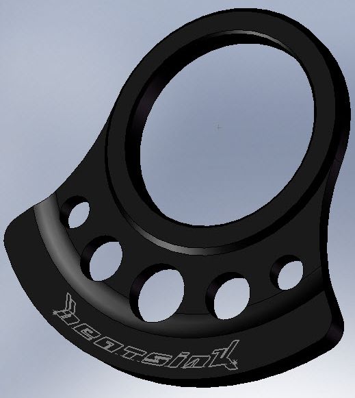

Dear all,
There are 10s of UCI bashrings on the market and the difference between these is mostly about styling preferences, weight and price.
I was wondering if there are any needs being un met which could allow some innovation to come in? I've been considering releasing a UCI bashring for a while, but it's been a lower priority whilst there are innovative products to be working on like chain tensioners. Maybe there's something I can incorporate in to re-engergise the design with a unique selling point innovation?
As always, thanks in advance for sharing your ideas and experiences!
Steve

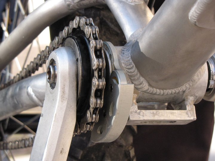

Something that is actually designed to sit against the BB cups under the frame instead of on the cranks?

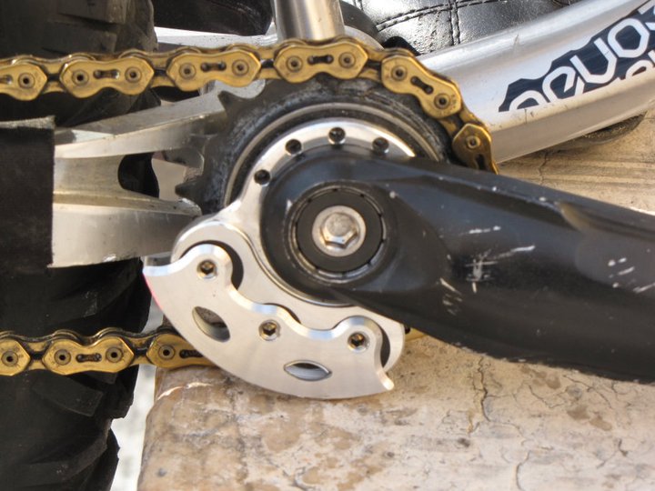

Here's the Milkyway Gummy bashring from 2011 fitted on both the crank and the BB. I'm wondering what stops the majority of 5mm wide bashrings from being mounted on the BB?
Steve
Reducing the thread contact between BB and frame would probably be one of the reasons I'd imagine? Non-drive crank clearance might play a part too.
In terms of lip vs. no lip, there is another way - Bonz used to (and still might) do a bashring that just had two 'knobbles' that stopped the bashring from spinning around, depending on which foot forward you were. I didn't really agree with the positioning of them (in that they meant that the bashring sat at a weird angle), but that style could still work and would theoretically be lighter than having to make a stepped bashring.
