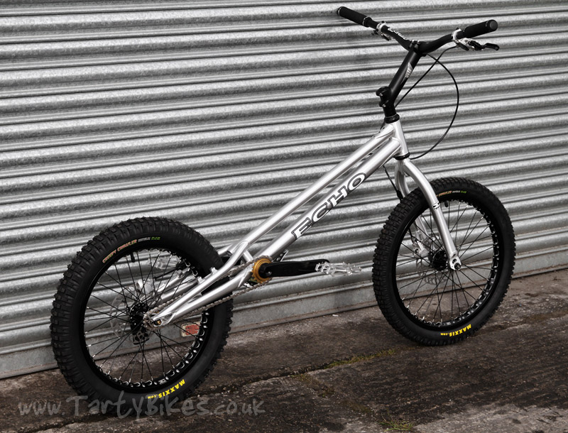

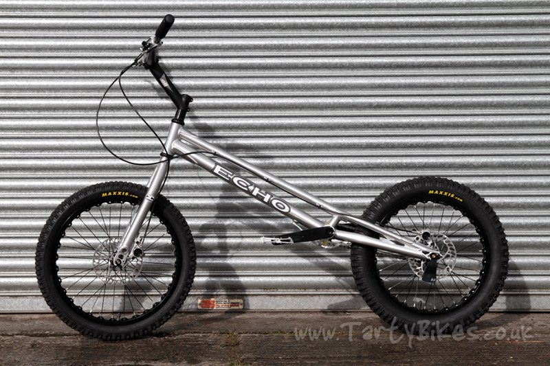

This is a custom spec we just built up for a customer - pretty sweet!

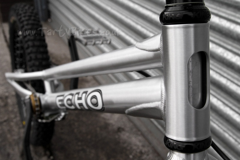

Some ti bits:

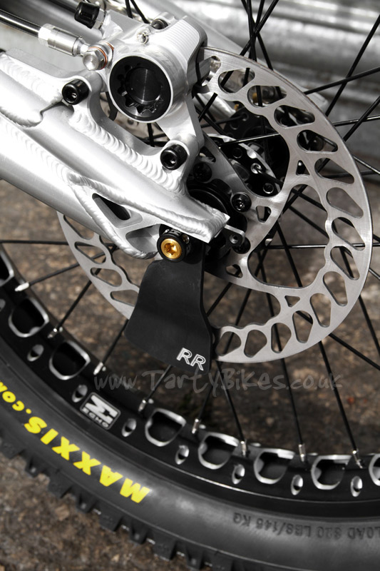

The new Chorrillas disc protector:
Stealth King-age:
New Try-All Elite 2011 bars:

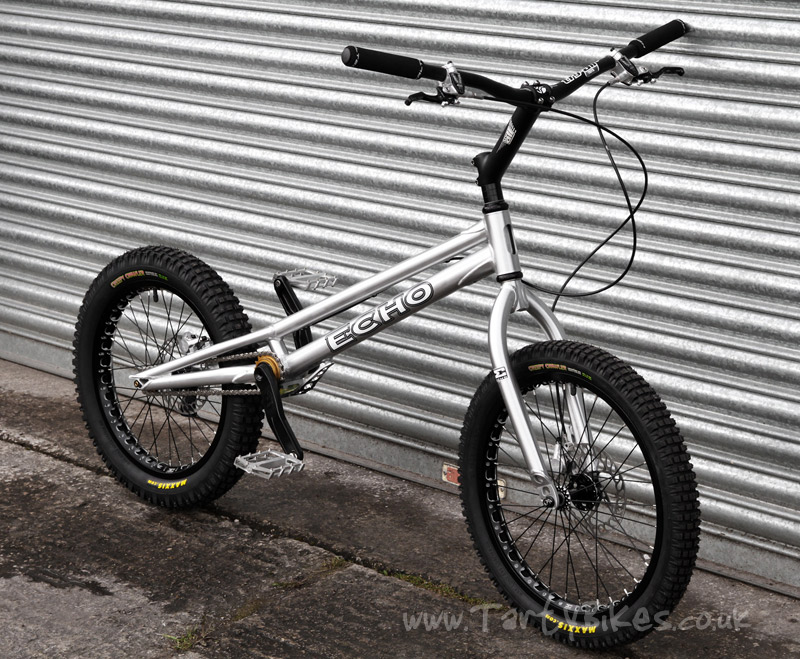

Frame and Forks
- Frame: Echo Lite 2011
- Forks: Echo Urban '09 Disc Only
Wheels

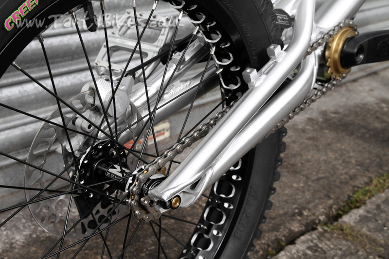

- Front hub: Echo TR Disc
- Rear hub: Echo SL Rear Disc
- Chain tensioner: Echo TR Snail Cams
- Front rim: Echo SL 20"
- Rear rim: Echo SL 19"
- Spokes: Mutiny Plain Gauge
- Nipples: Halo Alloy
- Wheelbuilds: Tartybikes
- Rim tape: Echo
- Inner tube (front): Kenda
- Inner tube (rear): Kenda
- Front tyre: Maxxis Creepy Crawler 20"
- Rear tyre: Maxxis Creepy Crawler 19"
Brakes
- Front brake: Hope Tech Trial 160mm
- Rear brake: Hope Tech Trial 160mm
- Other: Chorrillas Disc Protector

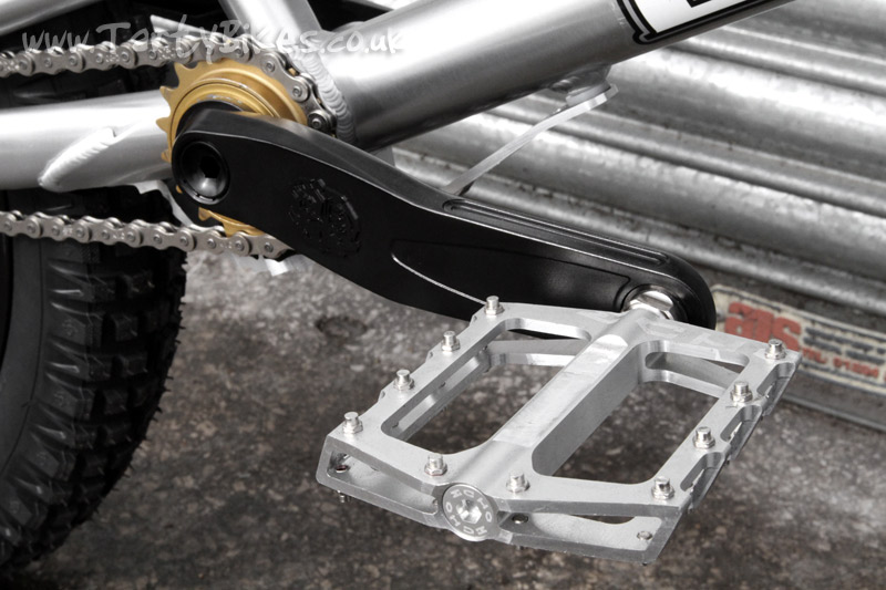

Drivetrain
- Cranks: RockMan Lite 175mm
- Freewheel: Echo Titanium 18T
- Chain: Trialtech Z610 HX
- Rear Sprocket: Echo Titanium Splined 12T
- Pedals: Echo TR Platform 2011
- Bottom bracket: Echo Urban ISIS
- Crank bolts: Echo SL
- Bashplate: Echo SL Bashplate

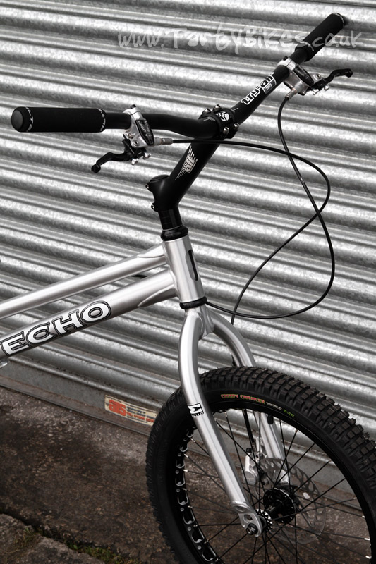

Steering
- Headset: Chris King
- Stem: Try-All
- Grips: Trialtech Foam
- Handlebars: Try-All Elite 2011
Weight: 8.80kg
Should be up on the site tomorrow hopefully.
Stunning bike.
Lots of stem stackers though! Is that so the buyer can decide how he wants his front end i'm guessing?
We usually set bikes up with a good few stackers under there (20-30mm generally) so people can make them feel how they want. The guy in question is pretty tall too so I wouldn't be surprised if most stay in there. Pretty high BB on it too so I wouldn't want to take out too many simply to keep things balanced.
The only thing i dont like about that frame is you have to have disk and maggie mounts! would look cleaner if you had the option for one or the other. Also there is no short option!
That's the 'problem' with making stuff... People for years have been moaning that Echo haven't made a Disc AND 4-Bolt frame, then when they do you get an opposite comment, haha.
The only thing I hate about the frame is that the chainstay area doesn´t have any cnc parts like the 24" and 26" have. To weight also sounds dangerously light.
Still hoping for a 20" copy of the new pirahna!
