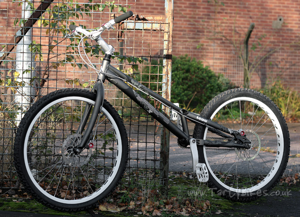

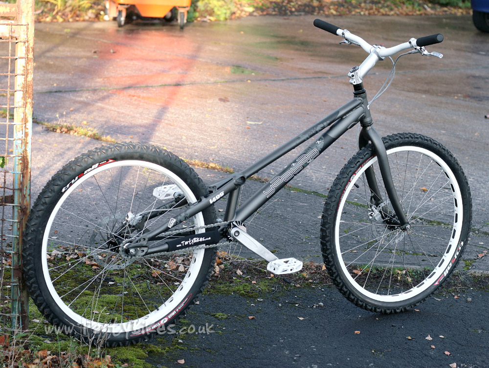

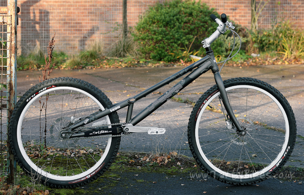

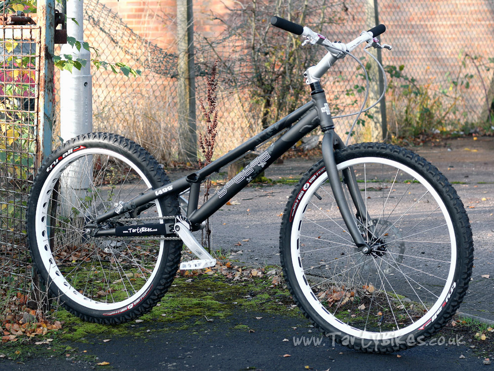

Yaabaa 1499, completely standard except Trialtech bars, Trialtech pedals and a pair of Try-All brakes. 1080, +30, 380, 10.6kg as shown. Had a quick ride indoor this morning, finding the 18:15 ratio a little strange for taps at the mo but when you get it right it's great. Yes the bars are high but I like it like that because of my short arms :P

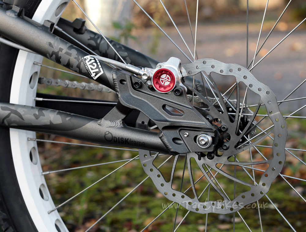

The important bit :P

But i feel "holy stem stackers batman" is appropriate :P
Also, whats that rear rim on the Yaabaa, thats not a standard koxx rim....
Shut it :P
The rim is the same profile as the 'hOle' rim, but double walled and circular drilled instead. I think one of the walls may need to come out :)

As for the Yaabaa, apart from the name, nice! But i dont know how you can tap with that front end! got enough stackers? I was unable to do taps at all on my kamel with a mere 10mm extra in spacers! Good for pedal hopping though, ask Jack Meek or Fatmike!

a bit surprised by how high you've stacked your stem adam, 10mm should be more than sufficant with those bars and stem combo.
See above :P
I actually think more spaces is better for tapping with my technique. If you do a pedal up with a tap then lower bars are generally better, if you do a 'proper' tap (where the front wheel leaves the ground much later, Frenchie style) then higher stems allow you to tap harder.
