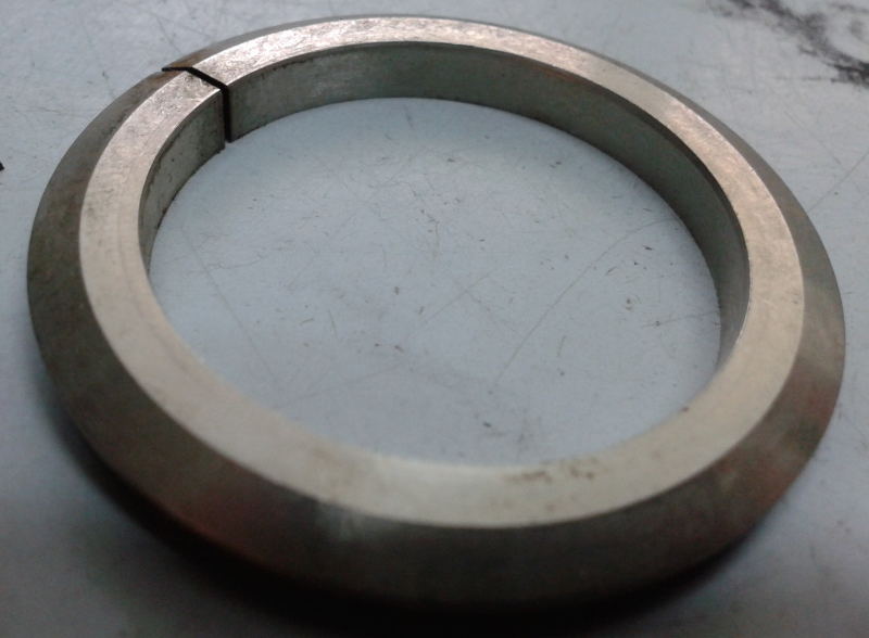

why off topic? ECHO crown race arn't compatible with most one piece steerer tubes that have a 1...2mm radius. They can't be fully seated and will push in a sharp notch.
echo crown race?
looks like it cracked below the headset crown while usually I would expect the steerer to crack above. That Tensile Ace headset comes with non-split crown. Any defects on the steerer tube from removing the crown using a screwdriver or similar in order to glassblast the fork?

it may be 41.5 x 30.2 x 6.5mm 36°/36° (2009...~2011) or 41.8 x 30.2 x 7mm 45°/45° (~2012-2013) unfortunately the chamfers' diameters are never specified...
