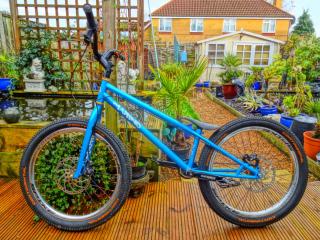

  5. The first thing people wanna know is the geo, you know this Looks good though! I always prefer colour matched frame & forks, do a comparison!

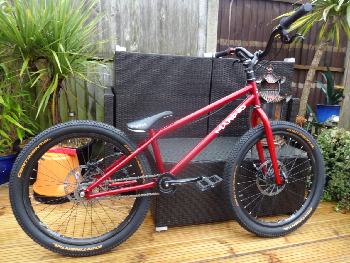

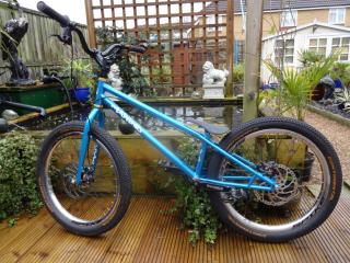

  6. That's the thing, you can ask for any length chainstays you like, but if you have horizontal dropouts with 22-16, then your back end will always be roughly 364mm, ish, depending on how tight or loose you like your chain. Taking another link out means going stupidly short that I've only seen on about one other frame.

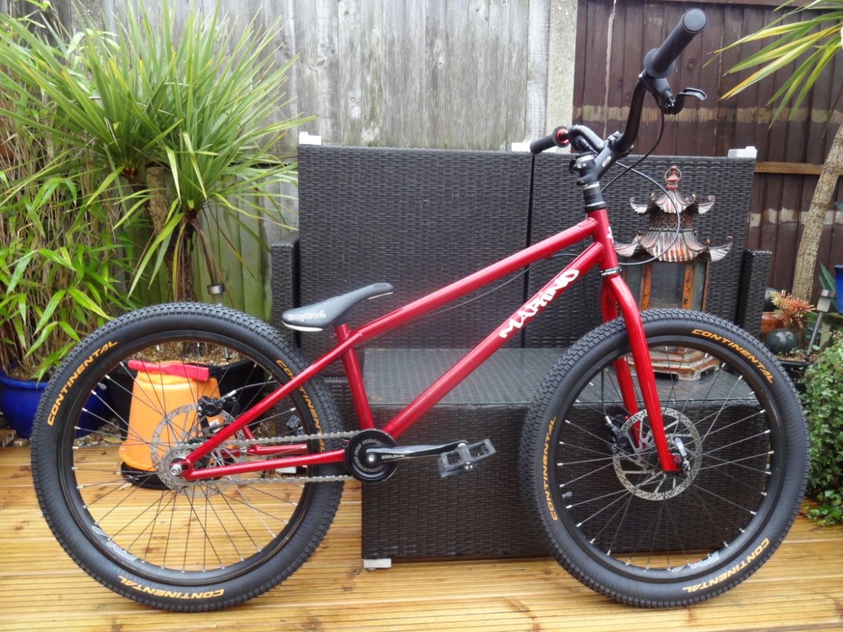

  7. Looks good! Nice red touches.

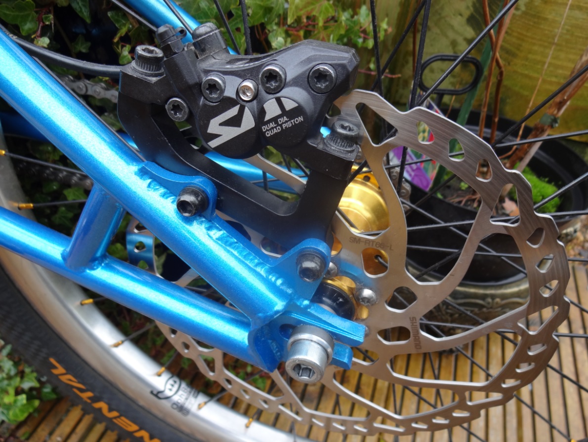

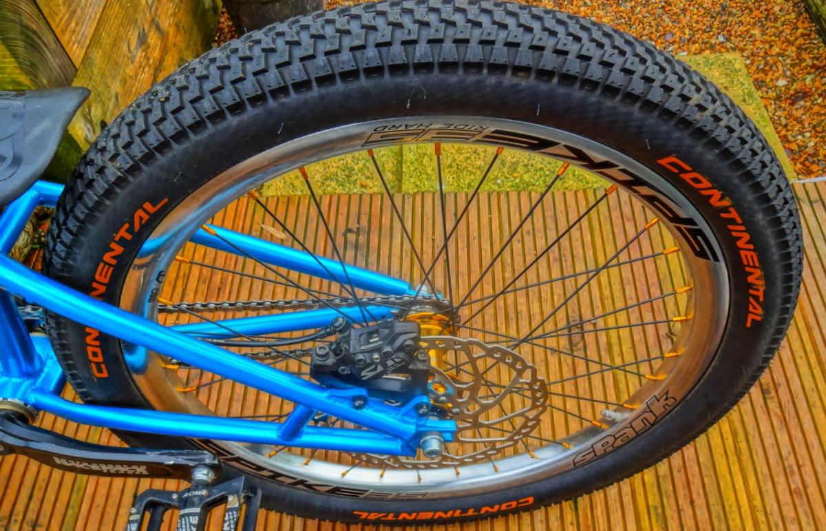

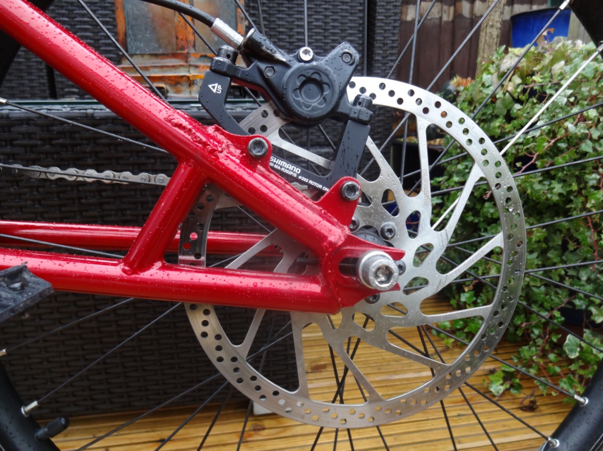

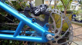

  9. Wanted to know if anyone's broken one or if they're stronger/weaker than your average cheaper ones. I've got one on the front and it's brilliant, but on the back I'll be using their biggest mount with a 203 rotor and can't really afford for it to fail, I know it's top quality but it's also pretty minimal & machined out so I wondered. My current Hayes one is an absolute trustworthy block, but it doesn't meet the pimp requirements of my bike.
  10. Cheers! I knew the colours would be winners

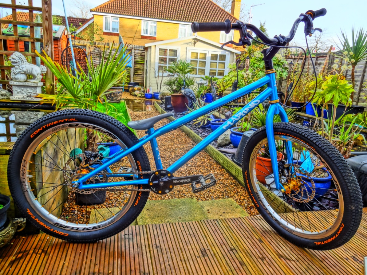

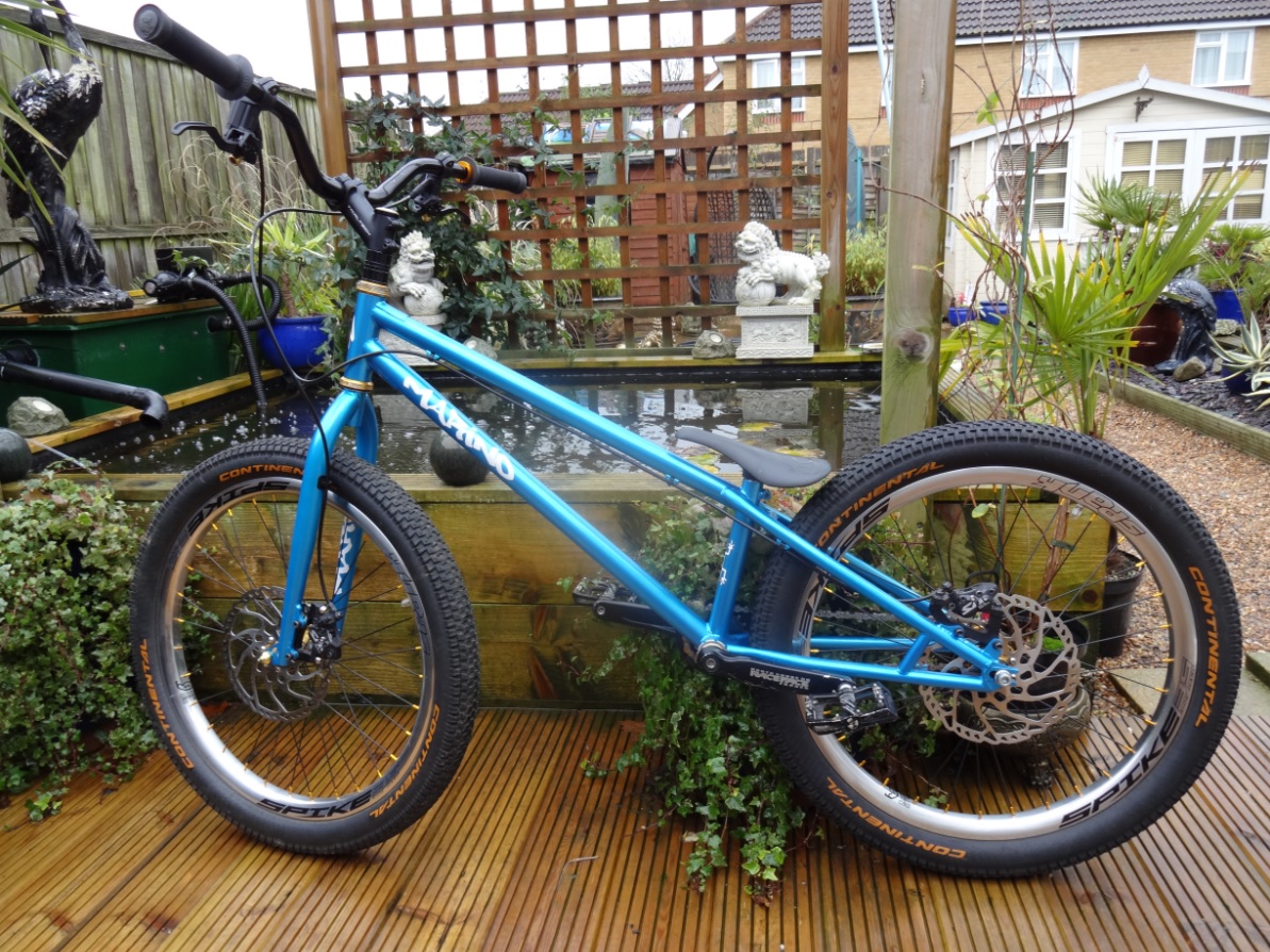

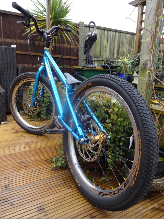

  14. It's not really an anal thing....I asked for 1000mm which is the rough ballpark of most street frames, and pretty much what I've had for the last 4 years, but I wanted more room so I kept the wheelbase where it was and got a lot more reach, longer top tube & slightly lower bb. If you'd like anal measurements, the wheelbase actually measures 999 not 1000, and if you want super deep anal then the bb is more like +14mm than +15mm. But I can live with that. I've always had super cramped bikes, bruised thighs and no room, I always played it safe with geo so I took a risk & thought maybe it'd end up too long but it feels about right so far, it has way more reach but doesn't seem to suffer anywhere for it. I prefer the look of a slightly lower front end too, but I'm a decent height, and that is the amount of spacers that it needs to ride the way I need it to, not much I can do about that. But that's height, posture, personal preference, style etc, everyone and every bike is different. I could do an Ozonys and have 80mm of stackers and a 0 degree rise stem. These are my first horizontal dropouts in 17 years, I'm glad I got some.

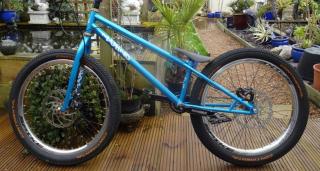

  15. Cheers everyone, had the first ride today, feels f**king excellent! So light and flicky, really easy on the front wheel too, not just static but twisting stoppies too, so much less effort.
  16. Very nice.I like the rotors, not so keen on that rear brake adaptor scenario...

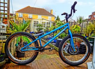

  18. Cheers! Get yours built up

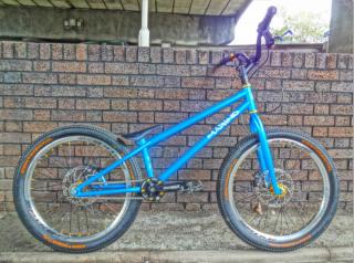

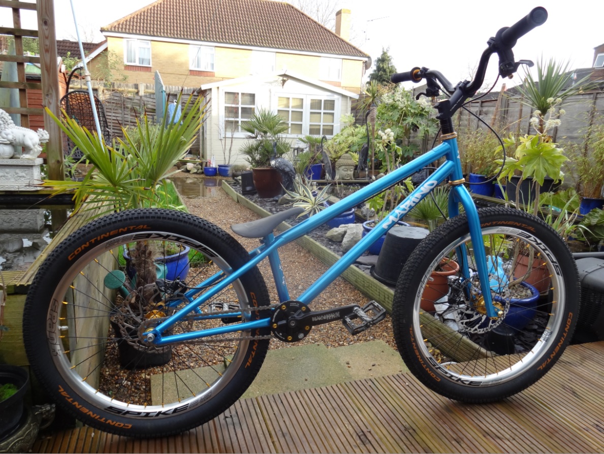

  19. Thanks everyone! Family I agree on the front end, I don't think super steep looks the best, but it's pretty handy. The bmx style forks exaggerate it too. James the geo is 999, 364, 75, +15. Forks are 410 x 30.

  21. Na, I just find them amusing. It's slightly lower than the Archive and a bit longer in the top tube, and a tiny bit steeper too. Same back end though. I rode Ross's Archive last year and it was a bit too short for the trialsy stuff for me, so was my old bike so I've got a bit more room on this one while still keeping it under 1000mm.

  23. This turned up, so I built it. Waiting for my custom stickers but they'll be a week yet. Geo is 999wb, 75deg, 364cs and +15bb.
