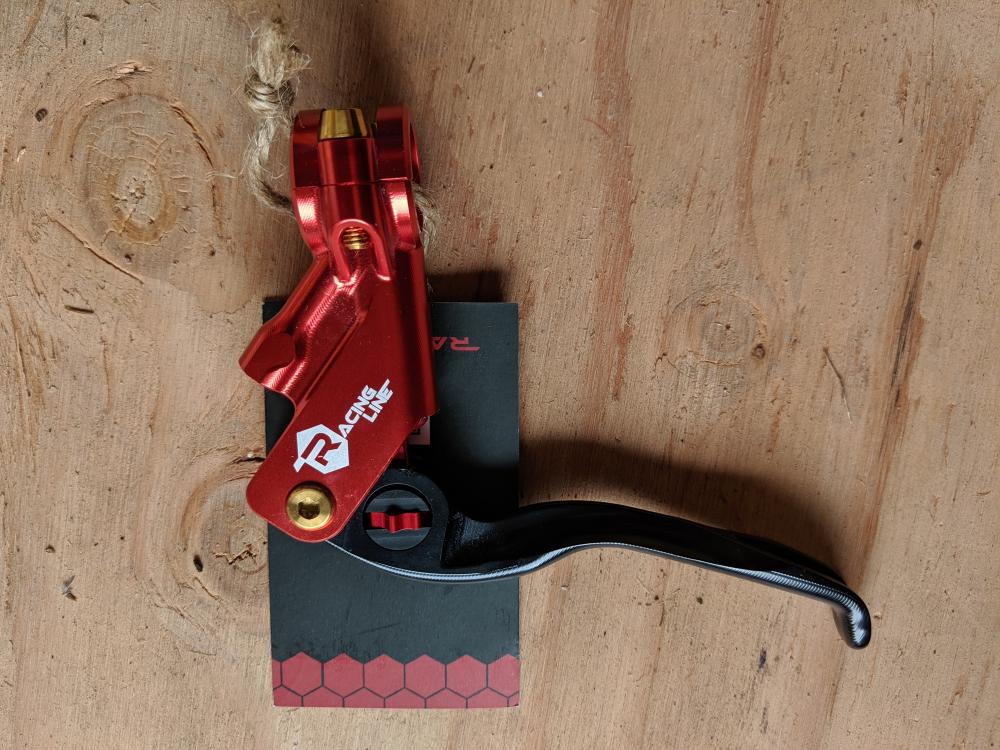

Ok 2 more questions: I have one 14mm piston version and one Nano version lever. Which one do people like better for the rear? The levers will be attaching to magura hoses. RLs website shows them attaching the hose with an olive and the sleeve nut only, ie no hose insert. Is that correct? Can i put the same fitting back in or will i need to cut the hose and use a new olive? Thanks in advance!
I have aquired a racing line brake lever body. Which rim brakes can i use it with? I have a 2014 HS33 and an echo (not SL) rim brake. Will the racing line lever work with either of those? Any mods necessary or mostly swap and go? Any help would be appreciated.

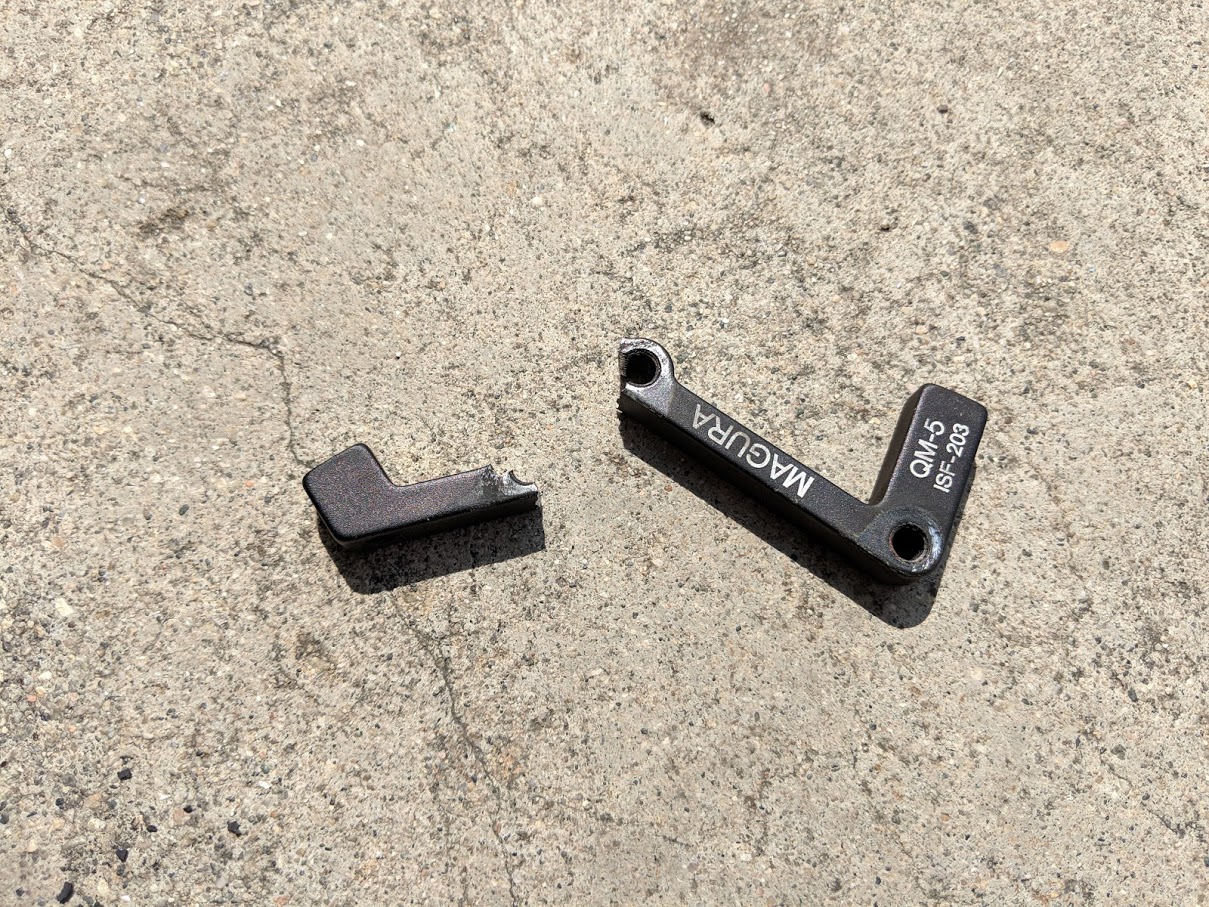

I once swore by Magura brake adapters, but now I've broken 2 in about 2 years. They were both QM5s for 203 rotors. I've ordered the equivalent Hope adapter and maybe they're stronger. The added bummer is that I didn't catch it right away and I'd been wondering what was up with my rear brake (Oh so not a good feeling!). I guess I should be glad that even broken it held together well enough not to fail catastrophically. Braking chains has caused me far more grief. So the moral to the story is when you hear one of those 'PING!' sounds and it's not a spoke or the chain, do a serious bolt check!
