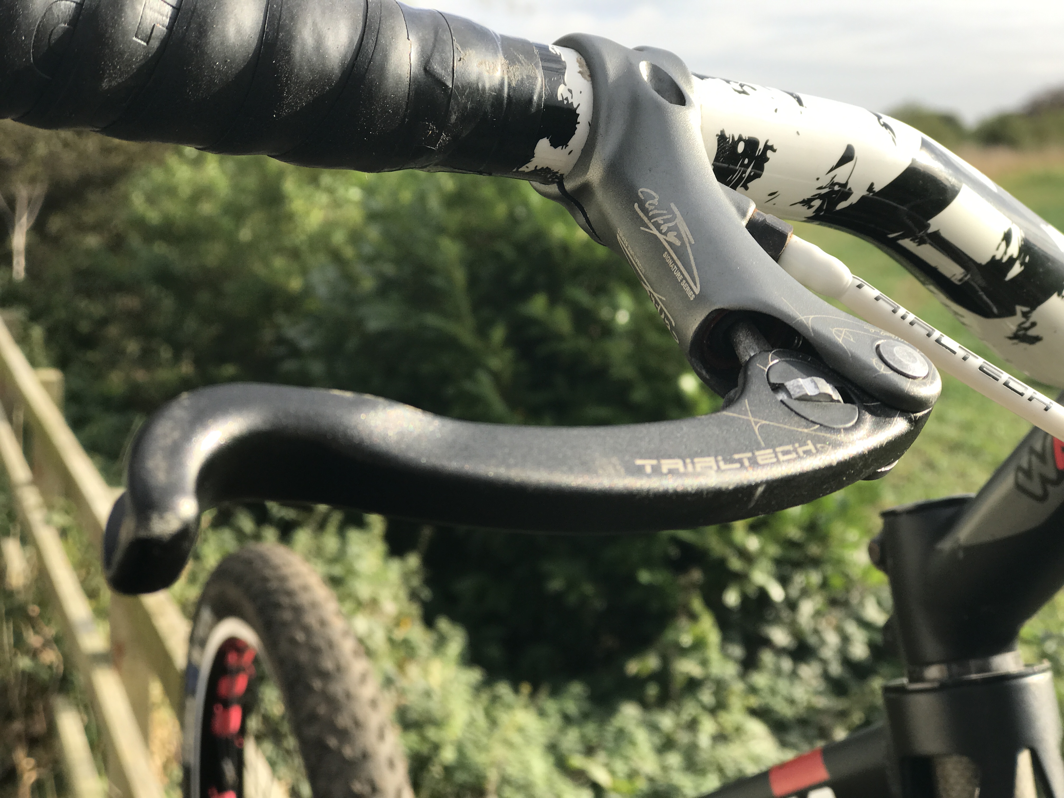

  16. Had a pair of the Carthy ones on my Crewkerz. The lever blades were a nice shape and didn't bite into my finger as much as racing line ones did. It took a bit of messing to get the brake feeling anywhere near as good as an 05 HS33 but once I stretched the spring and got a decent water bleed in there they seemed to perform equally as well.
